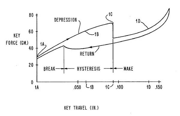

My discomfort with the Cherry mx clear made sense when I actually looked at its force-displacement curve and compared it with the force-displacement curves of two of my favorite switch types, the Topre and the IBM buckling spring.
Cherry mx Clear
Topre
IBM Buckling Spring
With the mx clear switch, the peak force of the tactile bump is 65 cN. The force decreases after the bump to a local minimum of about 50 cN, and the actuation point (operating point) occurs at around 55 cN while the force is increasing with a steep slope. The force then continues to rise steadily to about 90 cN before reaching the bottom of the stroke. It is easy to see why this switch gives a feeling of fighting against it after the actuation point if you try to bottom out the stroke. In fact, the force-displacement curves of all Cherry mx switches share the characteristic of increasing force immediately after the actuation point, regardless of whether the switch is linear, tactile, or tactile/clicky.
In contrast, the force-displacement curve for a 45g Topre switch rises to a tactile bump at 45 cN, but actuation (operationg point) occurs while the force is decreasing. The force continues to decrease, enabling the user to allow the key easily to finish the stroke until reaching bottom.
In like manner to the Topre switch, the force-displacement curve for an IBM buckling spring switch, shown in the bottom panel, increases steadily to a maximum of about 70 cN, whereupon the spring undergoes a catastrophic collapse (it buckles) accompanied by a precipitous drop in force from around 70 cN to about 55 cN, corresponding to actuation ("make") of the switch. After the sudden collapse of the spring, the force then increases again to the bottom of the stroke.
The force-displacement curves for all three switch types exhibit hysteresis -- the return or recovery (upward) stroke does not retrace the downward stroke; instead, the upward stroke follows a different path as the switch resets itself to permit a new activation and recovery cycle.
This analysis of force-displacement curves made it clear to me why I did not like any type of Cherry mx switch and why I liked both Topre and IBM buckling spring switches, which might seem worlds apart in their mechanisms until the force-displacement curves are compared. In general, all Cherry mx switches display increasing force immediately after the actuation point, whereas Topre and IBM buckling spring switches have decreasing force directly after the actuation point.

I'm not sure how you're reading the force graph..but based on the force graph and actual usage, buckling spring and cherry tactiles are far more alike than they are to any Topre...
The main difference between Cherry and Buckling Spring is where the bump occurs...
But as far as Bump, Drop off, gradually more force before bottom out..that is the path both Cherry and BS are using.
Topre is...Bump, drop off...bottom....
I'm not saying you don't like Topre and BS best...but they're nothing alike...
Offline Hypersphere
  • Posts: 1886
Re: Kul ES-87 with Cherry mx Clears -- Comparisons with Topre and IBM
« Reply #4 on: Sun, 28 September 2014, 13:41:25 »
@Polymer: If you look at the force curves, you can see that for the Cherry mx clear, the force increases after the actuation point. For the Topre, the force decreases after the actuation point. For the buckling spring, the force dramatically decreases after the actuation point.
For Cherry switches, you are compressing a spring throughout the downward travel of the key. For Topre and buckling springs, the spring (dome in the case of Topre) collapses during the downward travel, resulting in a decrease in force.
For all of these switch types, the force increases again upon bottoming out.
But you're reading into it what you want.  Actuation is not a point you feel or see.  I take that back, with BS you can feel when it actuates because that is when it collapses..but actuation in general is not a point you feel..they might design the switch that way but in general, it doesn't need to be.  You don't feel when Topre actuates, you don't feel when MX switches actuate...
If you look at the force curve...There is a bump on all of them. Followed by a drop in force required to keep pressing...that is consistent on all of them.
After the bump, the clear and BS required greater force (after they hit their collapse point) to continue to press on until you hit bottom..
Topre does NOT.  The upwards portion you see on the chart is not required forced unless you're measuring how much more force might be required to keep pushing the rubber further then the actual bottoming out point.  Yes, just before the end the required force goes up a little bit but effectively not doing that at all...the remainder of the upward force required (the very extreme portion) is there only because I'm assuming that technically the plunger can go down slightly more if you squish the rubber..that to me, is not worth measuring and should effectively be ignore...
You're reading the chart wrong...
« Last Edit: Sun, 28 September 2014, 17:12:48 by Polymer »

@Polymer: Thank you for your further insights and interpretations. I agree that the actuation event per se is generally not perceptible to the person pressing the key, although with some switches, actuation occurs near a palpable tactile bump, especially so with BS switches. Nevertheless, there is an identifiable point on the force curve during the actuation-reset cycle that can be specified. This generally occurs around the midpoint of the key travel; around 2 mm for a 4 mm key travel switch. Suppose we were to draw a tangent to the curve at this point. Clearly, for the Cherry switch, the slope of this tangent is positive. For the Topre, the slope of the tangent is clearly negative. For the BS, the tangent is essentially infinite (vertical), because the spring collapses at this point; however, we are dealing with a directional curve as we trace the actuation-reset cycle; clearly the force has decreased at this point. Both the Topre and BS force curves show a decrease in force after the actuation point -- relatively gradual for Topre and precipitous for the BS. In contrast, the Cherry switch force curve shows an increase in force after the actuation point. I hope that this clears up any perceived differences in our interpretations of the force-displacement curves.

Again, it doesn't matter where actuation is but coming back to BS.
Actuation happens at the collapse...technically it is after it falls NOT before.  You'd have to collapse the spring for it to actuate (that's how it happens).
It then increases after the bump..but let's review this again.
Forget about actuation..look at the force curve and what that is doing when you're pressing on it.
Increase in force (on all of them although Topre is really at max from the start) to overcome the tactile bump.  They might do it at slightly different points but they all require an increase in force to overcome the bump.
There is then a drop in force on all three switches...
Topre drops and basically drops until you bottom....
Clear drops and then requires additional force after the drop to hit bottom.
BS drops and then requires additional force after the drop to hit bottom.
The exact force curves are different...The force to actuate clears actually escalates quite quickly which is why it is actually one of the easier ones to not bottom out on...but regardless, the force curve of any of the tactile MX switches and BS are far more similar than either of them to Topre...which is absolutely nothing like either of them...
Not that it matters but to me it looks like you're trying to make it all fit based on your affinity for both of the switches..you're definitely reading the data in a funny way..
I can see how someone might look at them in a similar way if you only go to actuation on BS...like if you press a BS and then after it collapses you stop...but still, it feels different than a dome collapsing...
Let's agree that the curves are definitely not congruent!
Thanks for an interesting exchange!
Curves don't have to be congruent to conceptually operate in the same way....
I think if you think about this a bit more you'll understand it..but it'll mean you have to step back...forget about how you think it is happening and look at the actual data...
Or look at browns/blues...which is probably even more similar to BS force curve wise... (or greens which is VERY similar).
Like I said, if you stop close to when BS actuates, I can see how one might look at it more like a Topre (or any rubber dome for that matter).  But the same can be said for other Cherry Tactile switches....But if you follow the press to bottom or close to bottom, they're nothing alike..absolutely nothing alike..I'm not sure where you get the impression Topre requires additional force after it collapses...there is a reason they're basically impossible to not bottom out on when typing (45g..30/35g is different).  You haven't even explained that part although you mentioned somewhere there is an increase in force...not sure what part you're talking about..are you talking about that ever so slight increase right when you hit bottom?  Or are you looking at those curves that go straight up and think that is actually part of a normal button press on Topre?
Topre does NOT.  [...]
Actually these charts are just super inaccurate and don’t properly describe the feel of the switches.
Here were a handful of measured switches:
Cherry MX blue:
IBM Model F:
Amber Omron B3G-S:
“Monterey” Blue SMK Alps-mount:
We should try to measure some Topre switches, it would be helpful. Hopefully HaaTa can also get a rig set up at some point that does an adequate job measuring the force on the return stroke.
« Last Edit: Sun, 28 September 2014, 23:46:59 by jacobolus »

@Jacobolus: Excellent! Did you generate these curves? If not, what is the source? These are quite informative, and it would be of interest to get the return portion of the cycle as well.
« Last Edit: Mon, 29 September 2014, 07:36:33 by Hypersphere »
