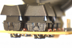

When I started designing the keyboard my biggest challenge was to find switches with two states that are suitable for a keyboard, since I was not able to find any I had to build them myself. I came up with a design that uses normal Cherry MX  switches with some modifications. The idea is to solder a standard tactile push button upside down on the PCB below the modified Cherry MX switch as shown below.
158207-1
I used brow Cherry switches which have an actuating force of 0.5 N and tactile push buttons which have an actuating force of 1.6 N, so the difference between the first and second state is significant, so it is difficult to press by accident the wrong action. I modified the Cherry MX switch so that the 'plunger' could actuate the second button. This was achieved by removing partly the centering 'pin' of the switch as shown in the picture.
