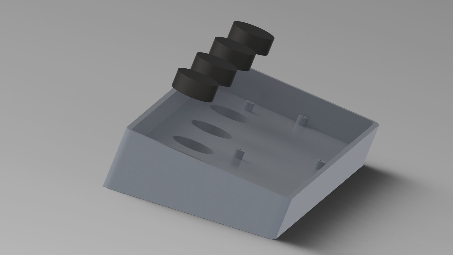

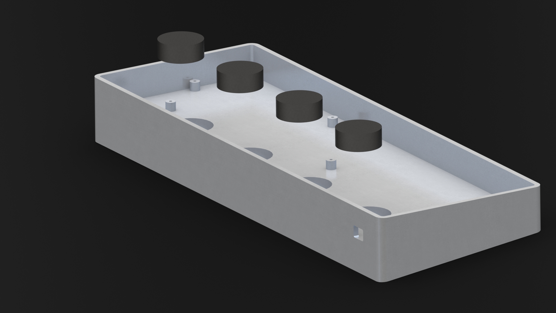

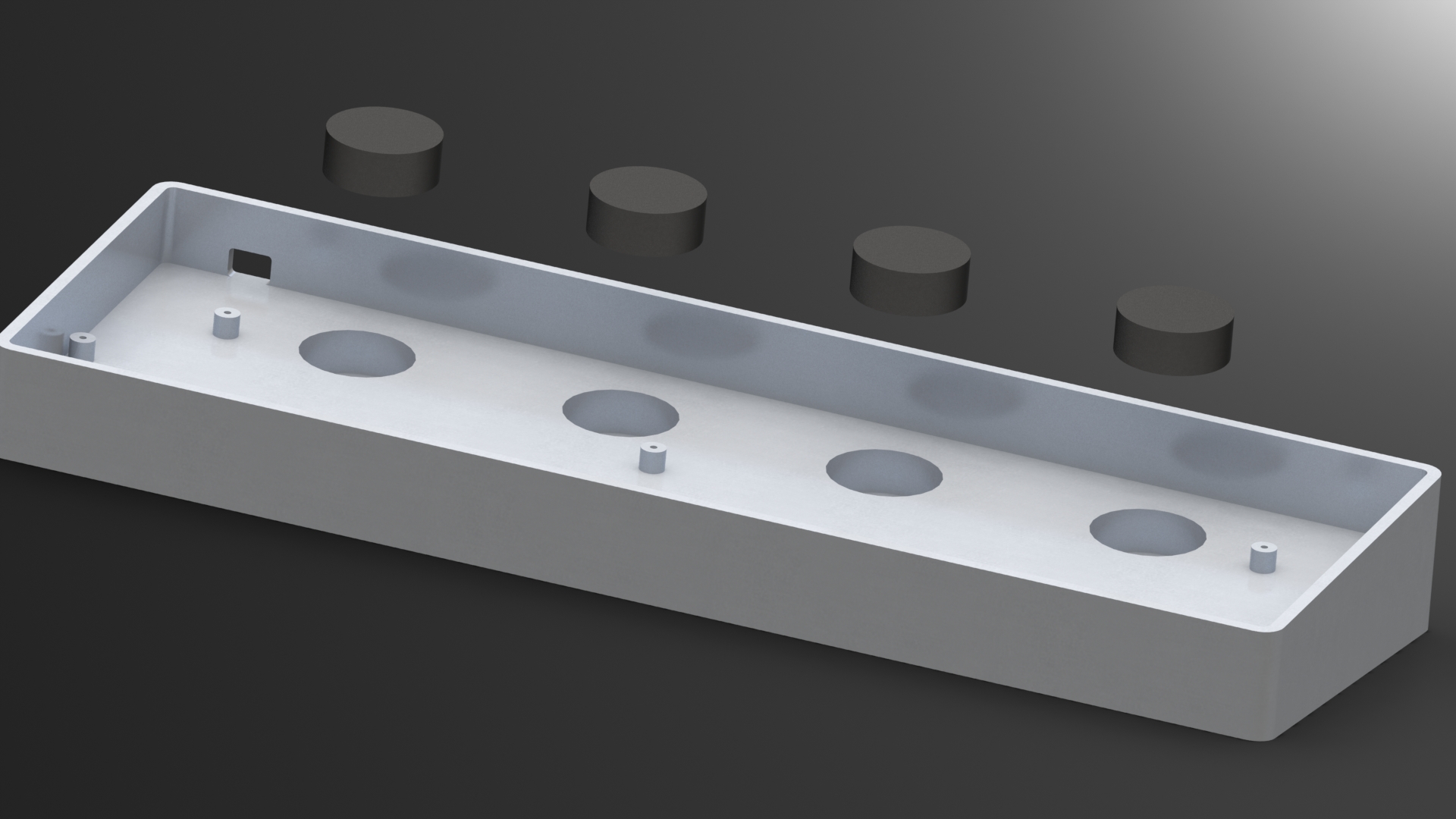

I've been toying with the idea of making a 60% wedge type case for a while now.  I'm slowly learning CAD but got side tracked by real life and invited a friend of mine to help out (although I am still convincing him to get a mech).
RENDERS!
89191-0
89193-1
89195-2
89197-3

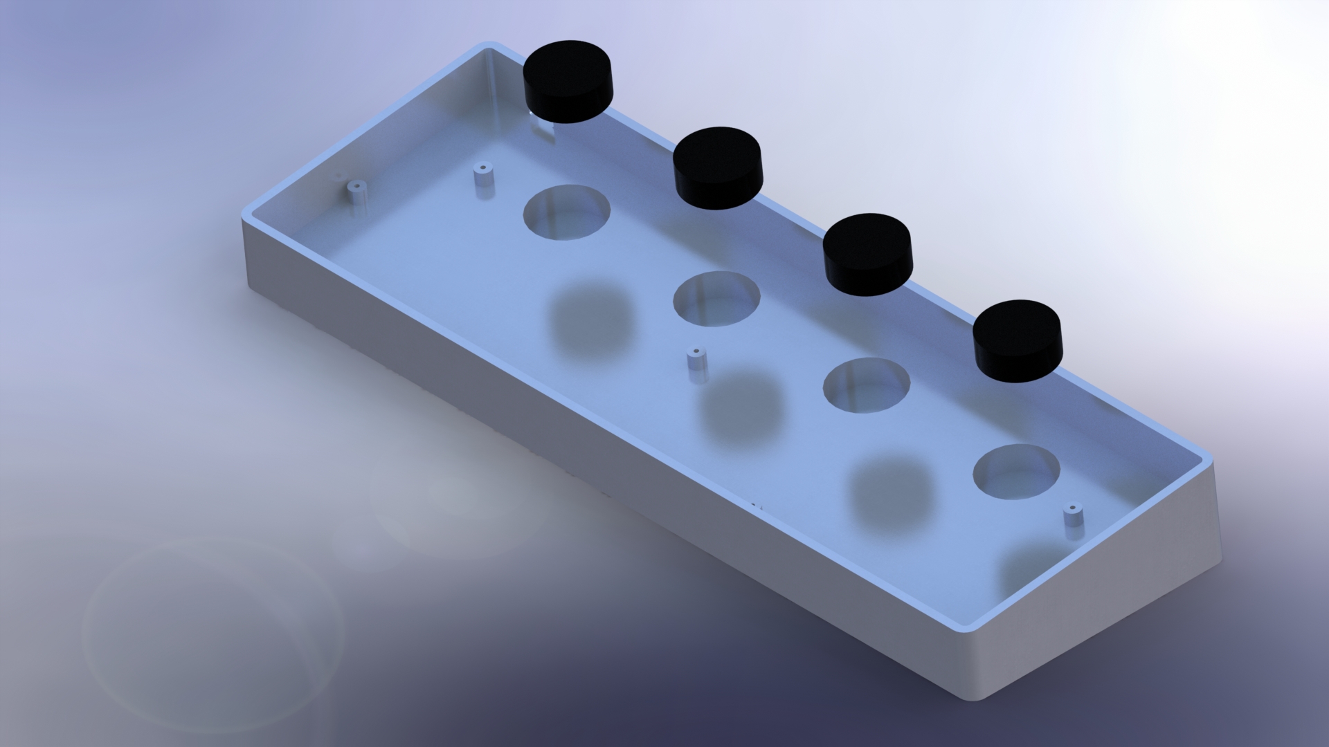

We forgot to add the recesses for the bump-ons.
89199-4
As is, it will be machined from T6 6061 aluminum. I could go with 7075 but it would be overkill and just add on to the price.  The inserts will be made of 4140 steel and installed on the inside of the case to keep the case bottom clean.  Probably going to have something engraved on the bottom but I haven't decided yet.
The case is estimated to weigh 1 to 1.5 kg (2.2 to 3.3 lbs).  The angle is 13-degrees (a personal preference) but I might dial it down to 11.
Another possibility is that it will be machined from wood but still have steel inserts for additional weight.  But I'd like the stand offs to be metal for durability.  I'd also need to figure out how to finish the wood.
Things to do:
  • I've removed the hole on the case for access to the dip switches, how much clearance do I need between the case floor and the PCB to make this compatible with PCBs with dip switches?
  • Wait on quotes for materials and machining.
  • Explore anodizing options

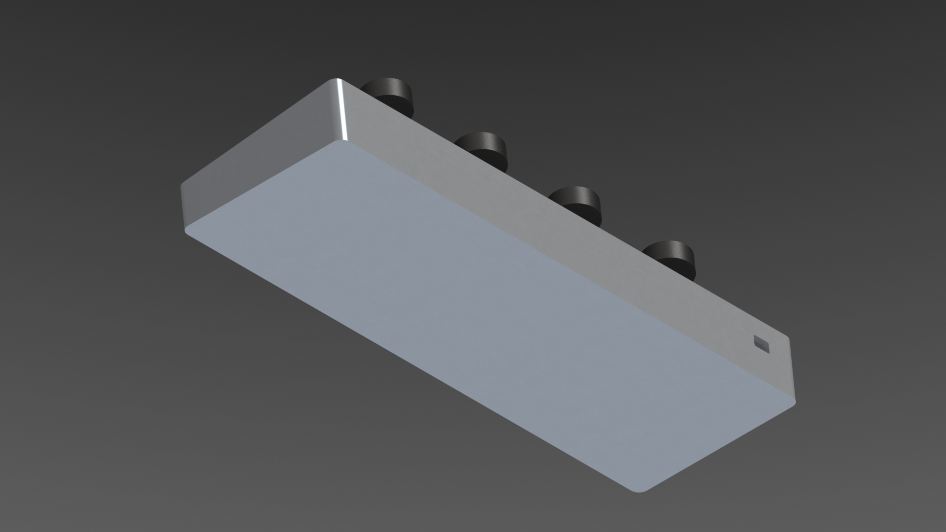

« Reply #10 on: Tue, 03 February 2015, 10:15:08 »
Changes:
  • inserts are now brass!
  • for the wood case, the PCB standoffs will be brass as well
  • the original angle was an INSANE 16 degrees :'( it has been toned down to 11 degrees
To Do:
  • wait for canvass for the cost of brass and then they can prepare a cost estimate
  • decide on bump-ons so the recess and the bump-on can be added to the render
  • decide on a name...so far I have Carabao 60

Questions:
  • How much clearance do I need between the case floor and the PCB to make this compatible with PCBs with dip switches?
  • Anything else I should consider?

I'm not sure why you want the insert to be done underneath the PCB ?
Sure you loose the need for it to be fixed under the case, but you can't swap them without removing PCB.
Questions:
I can measure on my pokerII went I get back home if you need. But since it will make the standoffs kind of high, aren't you afraid of the flex?
I wanted to keep the case bottom clean...haven't decided what to put down there though.
Is swapping weights necessary?  I always thought you installed them and forgot about them.  This is important since I was considering gluing the the brass inserts in place.
Questions:
That would be great! :thumb: I just need to know how high the dip switches stick out of from the PCB.  If there isn't enough clearance, I won't adjust the standoff height or case floor but just add a small pocket to make room for it.
Yeah I understand the whole clean bottom point.
I have no idea if swapping weights is necessary, never own a board with the possibility, but I guess you don't change the weights daily so they are just fine under PCB.
Just used to see them under the case on korean builds.
Questions:
I'll try to remeber to do it whenever I get home.
Same here, I only see them in pictures.  I think the Koreans put it on the bottom of the case as a design element while still serving the purpose of adding weight.  Also, it allows for a bigger piece if it goes through-and-through.
Cool man.  So...you home yet?  Just kidding...no rush :))
Roughly 3.5mm , so you probably want 5 mm room for safety. If there's any other dimensions you need on a Poker2 pcb let me know while it's open !
Pardon the late reply...timezones...anyway, that's all I need.  Thanks bud! :thumb:
