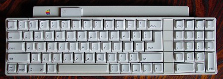

Alright guys as some of you have seen I have aquired this beautiful beast of a keyboard.  My end goal is to get it working over USB but I want to keep the look 100% stock down to the cable and connector at the computer end.  If this means putting the teensy inside the PC on a custom breakout board from the plug thats fine.  Or I could put it inside the keyboard and just use that big stock cable to handle the USB duties.  I just don't want to do a hack job.  I don't want to get into cutting PCB's, factory wires, and such.  If I have to solder to factory pads and remove something I could handle that as it would be easily reversible provided I don't lift any pads.
Now herein comes the problem.  To my knowledge this is the first time this has been attempted with this keyboard as pictures of the system it shipped with are pretty scarce let alone shots of the keyboard.  This is not your run of the mill 5291 bigfoot.  The best I can tell this is the keyboard that shipped with the 5324 system.  While, this does appear to have the same case, it is totally different inside.  I have included pictures of what I believe to be all needed to figure out this beast.  Dfj and I have been speaking in irc and it appears to be very possible to get this working as it has its own cpu, cap sense chip and power regulation (though input power is +12 volt and dfj is a little nervous of feeding that much power for fear of frying something.

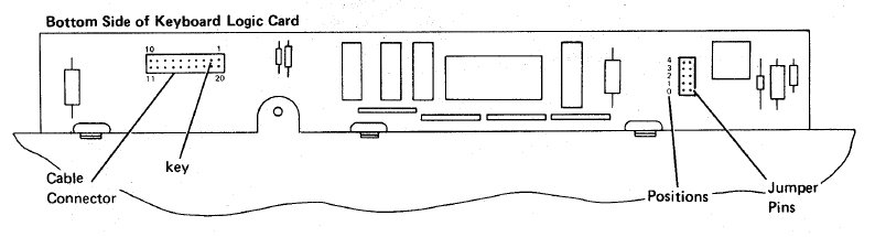

Here's the pinout from the hardware manual:
Code: [Select]
           D1  1      20  Ground
(missing pin)             -Strobe
           D2             Ground
           D3             D0
     (unused)             (unused)
     (unused)             (unused)
     (unused)             Frame Ground
           D4             +5V
           D5             Ground
           D6  10     11  Output
Here's a better description of the connector. Note how this compares with the kbdbabel image of the cable pinout.

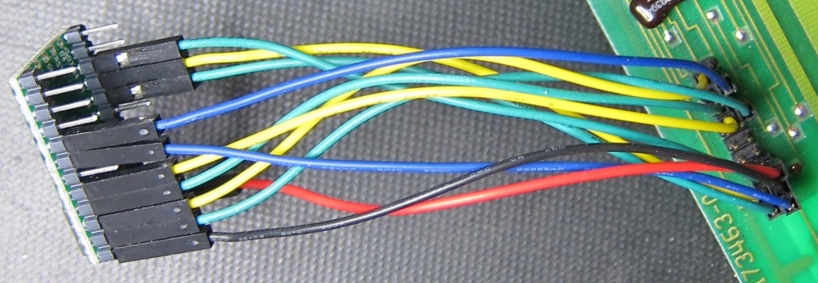

I don't see specifically what pins go where but 5v goes to 5v or Vcc. GND goes to the GND pin on the teensy. All the other pins go to data pins on the teensy. You can actually see which ones by looking at his picture:
^soarer's 5291 wired up and ready to go. You can see 5v (red) and GND (black) plugged in at the proper locations 13 and 12e GND to co to any of the GND pins which are 12 20 and 18.

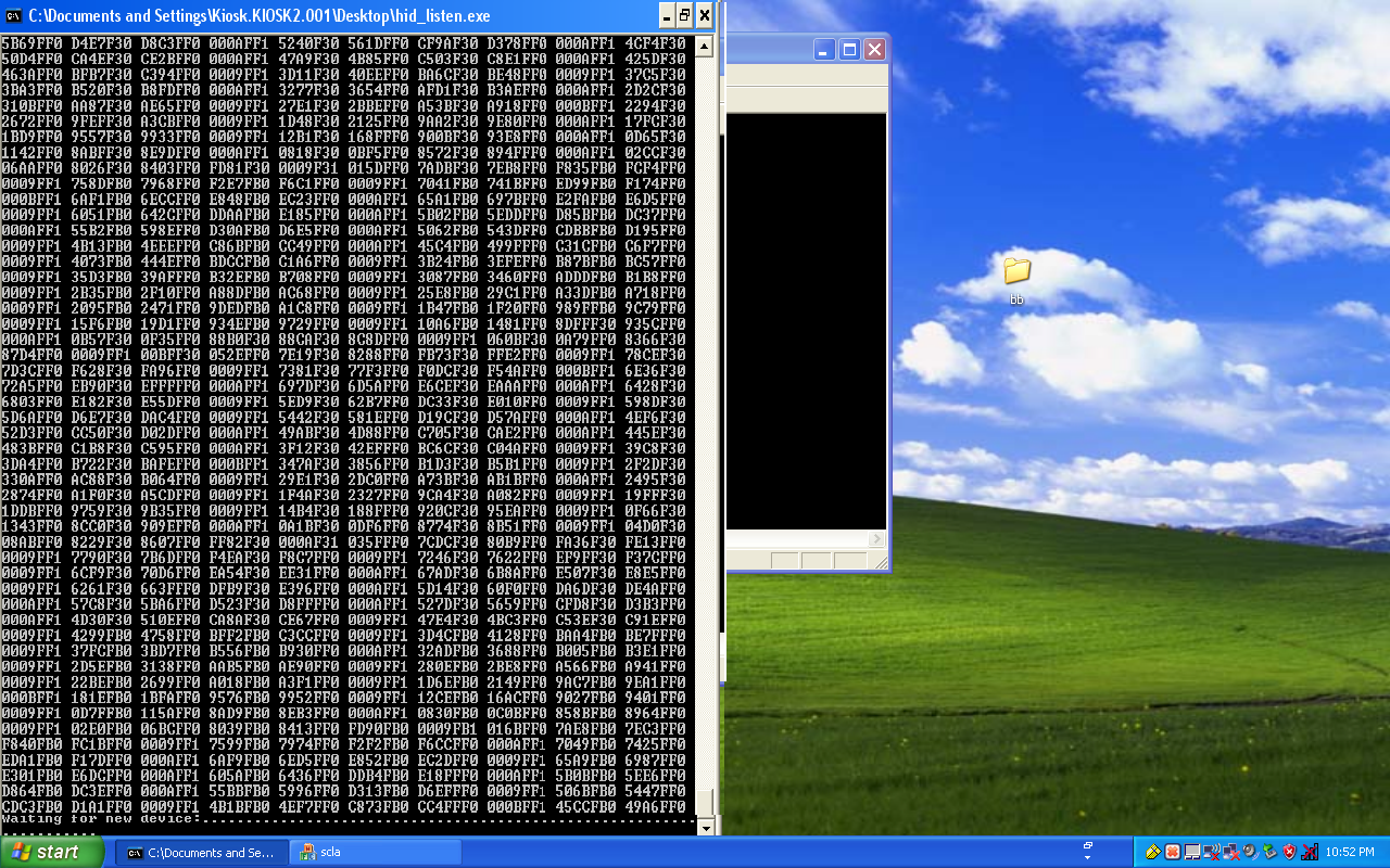

dfj, here is the output I was getting from the JD40 when holding a wire from the LA to the one pin that was always high.
84622-0
Offline dfj
  • Posts: 171
  • Visit our irc: #geekhack on libera.chat!
Re: Help me bring the Beige Whale/Moby Click back to life
« Reply #10 on: Mon, 22 December 2014, 00:53:27 »
A couple of important distinctions here: 1) is that melvang's beast has a controller, and 2) *outputs* the scancode it just sampled, as opposed to the 5291 which accepts the code to scan, decoding it onto the matrix.
 Still - it should readily convert... assuming it is in working order.
