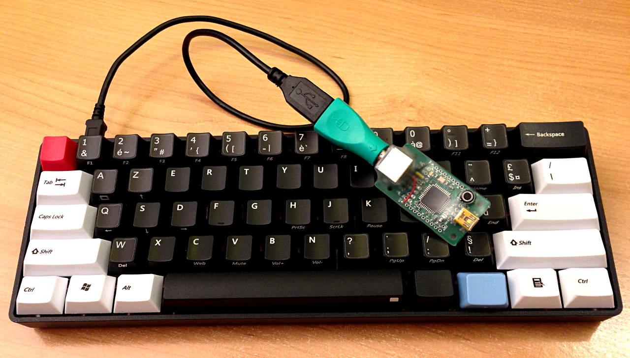

Apart from the excellent replacement controllers that SpamRay has mentioned, Hasu also builds a small PS2->USB adapter that allow to turn any PS/2 keyboard into a fully programmable one.
Here is a picture. It's the small PCB, and here it is connected to a Poker X:
85884-0
The PCB is so small it may be included in a keyboard case (depends on the keyboard naturally).
You would need, however, to have the keycaps manufactured for you by WASD. To the best of my knowledge, no commercial keyboard comes with customized keycaps, like WASD does, and no commercial keyboard is fully programmable to the point it would support your layout.
