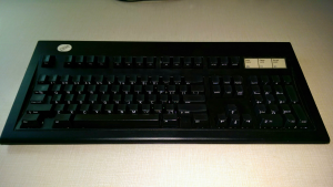

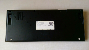

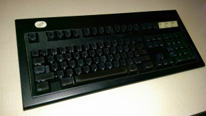

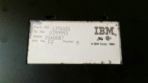

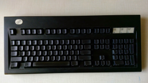

I've been working on this one for a while. I started with a regular old Model M 1391401 and vinyl dyed the top and bottom cases a satin black several years ago. (It took a really long time - weeks, maybe months - for the case to stop smelling like organic compounds, the vinyl dye had some solvents that took a really long time to settle.)
Maybe a year and a half ago I ordered black Unicomp keys for the board. At the time I did not realize that I would need new stabilizers (black ones) for the numeric keypad '+' and "Enter" keys. I tried to drill out an existing spare stabilizer. Instead I went through the membrane and destroyed a trace. The membrane is certainly repairable with some silver paste but this just delayed things further.
Well, I finally got a chance to do a full bolt mod to the keyboard and replace the membrane with a spare. The old, damaged membrane will go toward my homebrew Model M SSK project. I've seen another mod where someone just folded the existing membrane into the keyboard case. That just seems wrong to me so I'd like to use silver paste to make a "proper" membrane that I can then cut short.
Finally, I decided that I wanted front mounted legends on the keys. I don't have access to screen printing equipment or anything of the sort. So, I just purchased a set of key labels through Amazon, cut them to size, and painstakingly applied them to every single key. I wonder if Unicomp would ever sell front-printed keys, and/or if I could find another manufacturer to do front screen printing?
Anyway, here is the result. Forgive the low quality photos; it has been a long weekend.

Inverting the badge colors is an interesting idea. I'm not quite sure what printing process the original manufacturers used for them. It looks to be a dye screening process printed to the back of a piece of textured clear plastic. If I can figure out a way to print a convincing looking label then then perhaps.
I know Unicomp does offer a replacement indicator light panel. I just don't like the look of the icons they use.
One thing I wish I had done differently is to remove the labels and paint under them as opposed to masking them off as I did. Even with carefully cut masks some paint bled under the labels. Another is mask the back know sides of the indicator. That did get some paint and I had to scrape it away. As for the entire bolt mod next time I will try recessed head screws from the plate side without washers instead of pan head screws from the barrel side with washers. The screw heads interfered with the stabilizers on numeric keypad keys and without screws there the barrels were misaligned resulting in poor key action.
I do wonder if, instead of thick decals, I could obtain super thin model aircraft style glue-in-place decals. Those would look slightly better.
