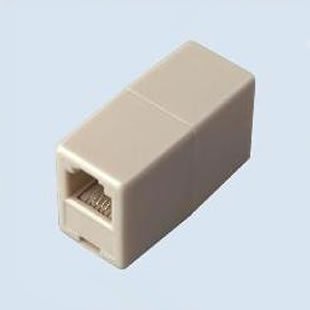

ah ok thanks. yeah I was able to finally get one from ebay earlier today (pic above is not mine).
The other solution I had in mind was daisy chaining these two:
anyone have an experience with such a set up?
Kishsaver, JP SSK, Displaywriter SSK, 360C, HHKB Type S, X60, Jane v2, Jane v2 CE

Cherry G80-1813 keyboard that comes with Dolch is actually native PS/2, so you can't do it that way. I've always just gone the easy way and replace the cable with a standard PS/2 which involves soldering to the PCB inside. The other best way would be to crimp an rj10 4p4c connector on the end of a PS/2 cable so you can plug it into the stock port. Then if you need to go to USB you will need an active PS/2 to USB adapter.
Thanks Ivan. Gonna try out the 2nd method you describe.
