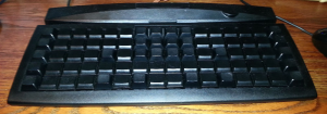

Here is a picture of my keyboard:
92883-1
I think eventually I would like to ditch all the f keys and stuff in the middle in favor of having a large track pad fill that space instead.

The layout looks very good, particularly for single letter frequencies. The only issues that I can see immediately are "ND" and possibly "WA". What language is your letter frequency chart / layout for? If it's for English, the letter "C" should be higher in the list, somewhere near the "DLU", but of course this depends on the text (corpus) used for analysis.

I think you are right about ND. R and D are swapped in my original JYUP layout, which I put more consideration into bigrams with. Guess I should swap them back. Also wasn't expecting S to pull that far ahead of H. Not sure If I should move it though, cause i like TH being a finger roll. Then again, not sure if I should be looking to change anything in the first place, since I am mostly happy with my old layout and it has taken a good bit of time to start to feel at all comfortable on it.
