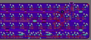

Layout a PCB with LEDs on top side of switch. Then throw it away and layout a PCB with LEDs on bottom  side of switch.
94556-1

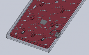

94558-2
Drag the PCB model into CAD to fit test against existing sheet metal cases and future milled cases. Shown here is a milled case.

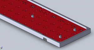

94560-3
Spent a few hours just zooming and rotating, because reasons.

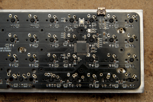

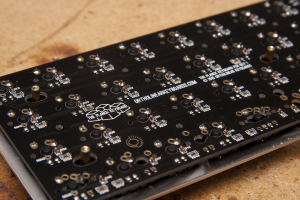

Time to order prototype PCBs. SMD parts soldered with hot air rework station. Switches soldered with my trusty Hakko FX-888. Not the FX-888D. I don't like the D.
94564-5
Enhance! Spot the maker's mark in gold. That's gold, Jerry, gold!

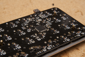

Squeezing an ATmega32U4 between four switches is not for n00bs.
94568-7
Note the LED pads need to be bigger. This is why we prototype.
94570-8

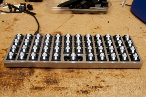

Grinding down the bases of stock 3mm round LEDs took longer than soldering the Cherry MX switches. I used SIP socket pins inside the switches so I can swap some 2x3x4 LEDs later.
94572-9

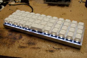

LED bling on a keyboard. About as useful as tits on a bull, but OMG IT GLOWZ!!!!!!!!!!11111111111111
94574-10

Can I ask why you've got breakout pins to unused pins, as well as others like d+, d- on the pcb?

Some people may want to add stuff to their Planck, e.g. Bluetooth, USB hub, more LEDs, etc. It's even possible to get a custom plate with extra rows and/or columns and manually wire them.

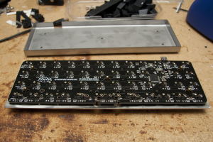

I didn't design the case... all credit for that goes to Jack Humbert, who is selling them as part of Planck/Atomic kits: http://ortholinearkeyboards.com/
The formed case is using 1.5mm stainless steel like the top plate, so it's pretty heavy for something this size. Fully assembled it's 600g. Typing feel is solid. That's all I can say, I can't compare it to milled cases because I don't own any.
I'm also surprised I haven't seen more keyboard cases using formed sheet metal. I've been thinking about designing one, inspired by this:

First time I've used them... the quote for 5pcs was cheaper than other fabs, and so I gave them a try. My only complaint would be that the vias, which should be tented (i.e. fully covered by solder mask) appear not to be fully covered, as if they masked out drill holes from the solder mask layer.
Here's an example of what tented vias should look like:
It doesn't affect functionality of the PCB in any way, it's just an observation that it didn't come out exactly as I designed, but for the price, I don't care. Production with assembly will be done with a different fab anyway.
