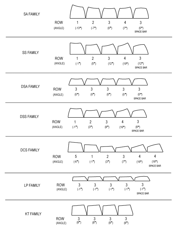

First let's look at SA profile and its rows.
I think most of the recent group buys went with 3-1-2-3-4-3, Topre HiPro also uses the same profile even though their keycaps are not made by SP.
I think traditionally a few of the group buy run with 1-1-2-3-4-4 (similar to DCS/OEM/Cherry type of arrangements where they double up the top and bottom rows to save cost.
Now I know some people do all uniform such as 3-3-3-3-3-3 so they can use it on Erogodox or any keyboard with irregular key arrangements.

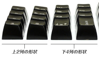

Filco on the other hand is the ONLY one that I know that use 2-2-3-3-3-3, so the top 2 row are slightly angled while the rest is uniform.
Source:
Text reads "Top 2 Row" and follow by "Bottom 4 Row".
Now the question is, I'm actually quite interested in the Filco arrangements 2-2-3-3-3-3, or even 3-3-3-3-3-3 is not bad either.

Penumbra, Commando and Calm Depths were 123334 and they're really nice to use. There are also a number of GB's in the past that used all Row 3 (Nuclear Data, 1976, etc.). I think one or two of 7bit's GB's used rows 1234 for numbers and alpha keys and all Row 3 for mods.
Pulse and Hack'd by Geeks are 312343 with Row 3 Shifts.
There actually hasn't yet been a 112344 SA profile GB yet, but the new Retro SA set may run like that. Also, BunnyLake hasn't finalised the profile of the 2nd run of Penumbra yet. One problem with most of the "full sculpt" SA sets is that SP doesn't yet have Row 4 Shift molds.
The Filco set is the only one with 223333.
If you like "flat" sets like all Row 3 SA, perhaps you'd like DSA profile? For some (myself included) the smaller keycap tops make it a little difficult to get used to, but at least they're spherical tops like SA and there are more sets in DSA than uniform Row 3 SA and you can even buy full blank sets straight from SP.
