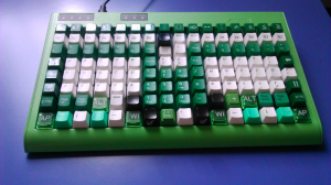

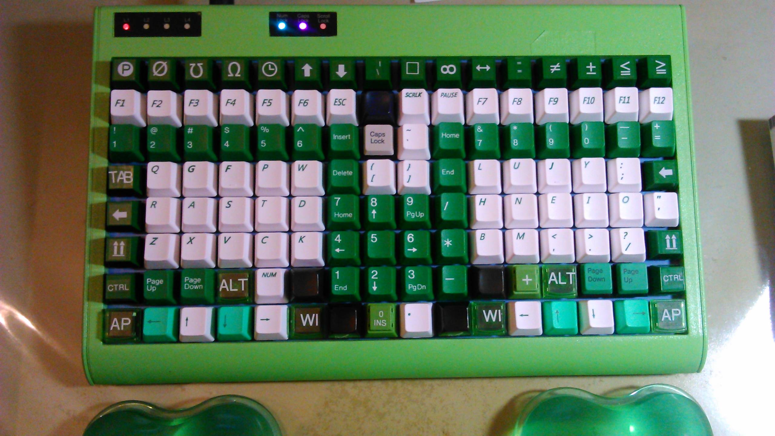

Here's the layout for which I am building the case.

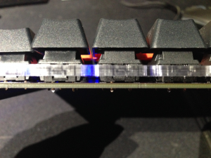

I haven't tried using 1.5mm acrylic, only 3mm Acrlylic.  It flexes enough as it is, I can't imagine 1.5mm holding up very well.  I think your layered approach will ultimately work out ok,  but you'll obviously have to bond the plates together fairly consistently to gain the benefits.
Here's a crappy picture of what 3mm acrlyic looks like from the side:
94515-0
There is about 1.7mm between the bottom of the acrylic and the top of the PCB.
You have ~3.2mm between the switches - that's a pretty narrow strip of acrylic.
With a key depressed, you have probably ~2mm clearance from the top of the plate, to the bottom of the cap.  I'm not sure if that will be true with all caps.
So, theoretically you could build a 1.5mm plate with an additional 1.5mm layer both above and below that plate for a total 4.5mm thickness.  That would probably be quite nice.
If you're going to try that, I suggest doing a trial run on something simpler (and even smaller) than what you have there.  There is quite a bit of flex in my 59% board using 3mm acrylic.  It's not bad for typing, but when inserting the switches and putting on the caps, I had to brace the PCB underneath with my other hand.

I don't think it's necessary, personally. I toss my keyboard in to my bag every day and haven't had any problems.
Here's a profile shot of my board. Apologies for photo quality.
96603-0
And a shot from below:
96605-1
I have three layers: a top plate, a bottom plate and a friction layer. Bottom plate is polycarbonate, top plate is acyrlic (because I didn't think of polycarbonate at the time) and the bottom layer is PVC. All nice and transparent.
I think even with another supporting layer it's not going to be very stiff. If you grab two 1.5mm sheets of acrylic, place them on top of each other and bend, you'll find they still flex quite a bit.
It depends on what you're trying to achieve. For me I need it to not flex enough when it's in my bag that it'll crack the plate. It hasn't been as issue so far and if I replace that top plate with polycarbonate one I'm pretty sure that won't ever be an issue (
). Flex whilst typing is solved because the keys are right on top of the bottom plate.
