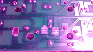

I have a PLU board that I modded and generally am quite happy with.
What I hated about my board was that the stock PLU layout has changed the right windows key into an anti windows key, and the apps key got changed into a trigger key for PLU's function layer which I don't use.
Intention:
I wanted to mod the keys back to a stock function as painlessly and unintrusively as possible. When I say unintrusive, it means I don't want to do anything irreversible such as cutting traces and scraping solder mask.
I posted on this forum but can't find my original post. Suicidal orange was nice enough to note that there are jumpers. 107026-0
As you can see from my pix, jumpers 12 are shorted for both pads on both keys. That's a total of four jumper pads.

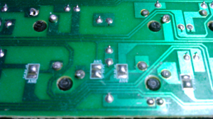

I removed all the solder using solder wick. I found the solder sucker poor for this task, since these pads are not through hole.
107028-1

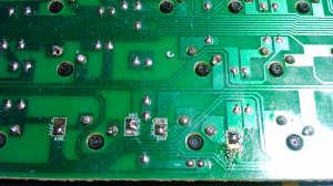

Then I tried shorting jumpers 23 instead, on the suspicion that this PCB was manufactured with alternative layouts in mind. 107030-2
My guess proved correct, and now I have my happily-stock layout modded PLU keyboard!
At various times in my experience I have come across non standard layout keyboards. Next time you are burdened with such a board, why not check to see if there are jumpers that you can short on the PCB?
Special thanks to suicidal_orange. I did use flux cleaner and cleaned up my PCB after taking the photo.
