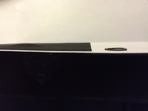

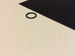

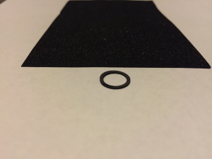

P.S. I wasn't sure how long it was going to take Hypersphere to get a ring he was satisfied with, so I did some hunting of my own to find a suitable material to punch rings out of. I ordered some 0.5mm Hareline micro foam from a fly fishing store which seems like it might work nicely. Not sure I'll ever get to testing it out, but here are a couple of shots of one of the foam sheets compared to one of the rings from Hypersphere.
