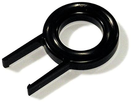

Btw, as a reply to the original question; a good way to take large keys off is with a ring puller. Wire pullers are better for normal keys, but ring pullers can take off longer keys.
What is a ring puller? Like one of those 3D printed ones?
It's one of these:
