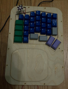

I'm unexpectedly going without my right hand for a few months, so I leaned on friends and built a left hand keyboard. It is ergodox like, built for half qwerty and tmk. 121724-0

Goals:
1) left hand only.
2) minimize time to learn. This isn't for ever. I have tried a Bat,twiddler, and frogpad in the past.I was always faster with one hand on a standard keyboard.
-- I added the Number row, even though it probably doesn't make sense for long-term use.
-- created lots of redundant keys, even on the same layer. this allows a bit of guessing where the key should be.
-- layers + printouts are  faster to learn than chords. So there will be many layers.
3) good ergonomics. Do not burn out to the remaining hand.
-- I  moved the thumb buttons closer to the fingers. This is  comfortable enough for some modifier keys, but  limits  how many thumb buttons will fit.
-- the one hand limit makes combining  momentary layers + modifiers harder. And tmk isn't chord friendly. So most layers will be toggled not momentary.
-- include a wrist rest to make sure I can't use the keyboard in a bad alignment. The design has stacked squares
for the wrist rest, so the height can be adjusted.
4) with lots of layers we need a good layer indicator.
I cribbed together a RGB layer indicator using a NeoPixel/WS2812 led. The timing doesn't seem to be a problem and getting tens of colors or pixels from one pin is nice.
What I have learned so far:
-Don't painfully strip column wire, use bare wire and slide on pre-measured heat shrink between keys.
-Use weaker springs for chords and modifiers. I have gateron reds for the base, and clears for all modifiers.
-open source is amazing - thanks all.
-half qwerty is fast to learn, but not yet objectively fast. TMK layers are better than qwerty for code and shell work (try ctrl-a,ctrl-k left handed) . That was what made the frogpad unusable. Macros may help make up some of the difference for  writing text.
