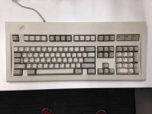

So, here I found this old girl lying forlornly on the side of the road.
110148-0
Looking quite dirty, missing a few keycaps and had her cable cut right off at the sdl connector.
She came with a birth certificate:
110150-1

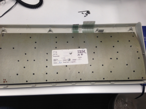

Got the 5.5mm hex socket driver and removed the 4 screws from the back
110470-0
then flipped the keyboard over and lifted the top half of the case off, from the rear as there are clips under the front edge
110472-1

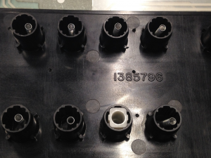

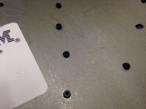

Slid the plate assy out to inspect how many of the plastic rivets have broken
110474-2
There were a number of rivets broken, but it wasn't until I was cleaning around the barrel plate and the back that more decided to jump off: time for a bolt mod.  :thumb:
Started separating the plate assembly: plate removed and membranes exposed
110476-3
Bottom membrane removed
110478-4
Separation/insulation layer removed
110480-5

now the blanket has been removed revealing the barrel plate with hammers in situ

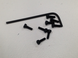

In researching the bolt mod, I also came across SpaceGhost's comments within njbair's thread Model M "nutless bold mod (http:// https://geekhack.org/index.php?topic=70410.msg1697379#msg1697379) and I particularly liked the idea of using 'machine' screws instead of a screw and nut.
Unfortunately I didn't take photos of the process I used, but it has been documents many times before by others, and I essentially did the same:
  • Cut off the rivet heads with a sharp blade.  I have an old "wallpaper knife", but a small art knife/stencil knife/etc can be used.  I didn't go as far as removing the posts down to the 'shoulders' on the barrel plate as my reasoning is I wanted to leave as much plastic for the screws to bite into as possible.
  • With the switch plate assembly altogether, drill pilot holes in the posts with a 1mm bit in a pcb drill.
  • Get ahead of myself and now order some screws.
Good old fleabay to the rescue.  Ordered 100 machine screws M2 x 6mm stainless steel hex head finished in black.

The internals in this board are in great condition. Good find.
Good call on the SS screws. I used standard steel screws on my nut/bolt mod two years ago and recently took it apart to find all the little hex nuts on the back of the plate rusted. Good thing I painted the plate because I'm sure it would be corroded as well. Now I need to replace the screws and probably go to a nutless mod.

If the plastic rivets are falling off definitely get in a do it!  The other advantage with the screw mod is they don't foul with the stabilizer guides under + and Enter on the numpad.
Thanks FreeCopy.
Knowing those screws are corroded is going to be a nagging thought in the back of your mind and there is only one way to stop it: do it!
Provided you initially drilled the holes undersized and the screws have made a thread in the plastic there shouldn't be an issue going nutless.

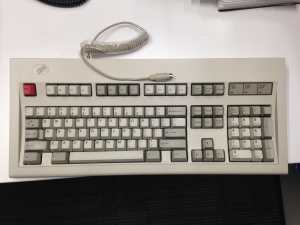

While I wait for the screws to come in from Hong Kong, I have turned my attention to the cut cable.  Here is what remains:
111220-0
I want to try and keep it as close as possible to the original, and ideally would get an original cable from clickykeyboards, but shipping to Australia and the exchange rate puts it over $50aud.  A bit too pricey for me unfortunately.
So, I have spent some time looking around for a beige ps2 curly cord to attach to the plug, which seem to be just as rare as the keyboards themselves.
I eventually found one and now have it in my possession to convert into a copy of the original.
The first step is to remove the ferrule
