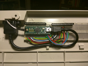

So, I ordered some ribbon connectors from Mouser and wired a Teensy 2.0++ up to the pins:
128540-0

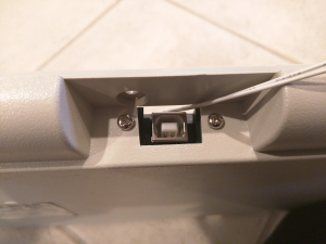

Tried to make everything reversible, except for a couple of small holes I drilled to secure the USB connector:
128542-1
I've since re-arranged some connections since then - pin D6 turns out to be a problem thanks to the built-in LED. Oh, and I had the keyboard LEDs wired up with the wrong polarity. But, I started my own fork of the TMK firmware where I hacked together my own matrix and keymap. Everything seems to mostly be working, and I'm typing on it right now.
