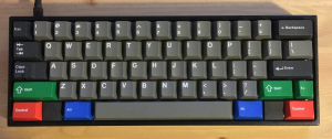

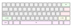

My dream layout is pretty much this:
130467-0
130469-1

Here is a complete list of goals I am trying to achieve:
1. 60% layout
2. Cherry MX Red
3. WKL bottom row: 1.5u - 1u - 1.5u - 7u - 1.5u - 1u - 1.5u
4. Off-center Caps lock [Stepped Caps Lock]
5. Split right-shift + 1u [Fn key]
6. Pink in-switch LEDs
7. Cherry stabilizers (not too sure if I am keen on the difference between PCB and plate mounted stabs, feeling-wise anyway)
I think that covers just about all that I want in a keyboard, if I have left something out, please let me know!!

I originally joined for the WKL plate, but upon thinking more about it, I really dont want a straight blank spot on the kb that sinks all the way down to the plate. I have decided to either use 1u blockers like the picture above or program those 2 keys to something I actually might use (print screen & Delete)
