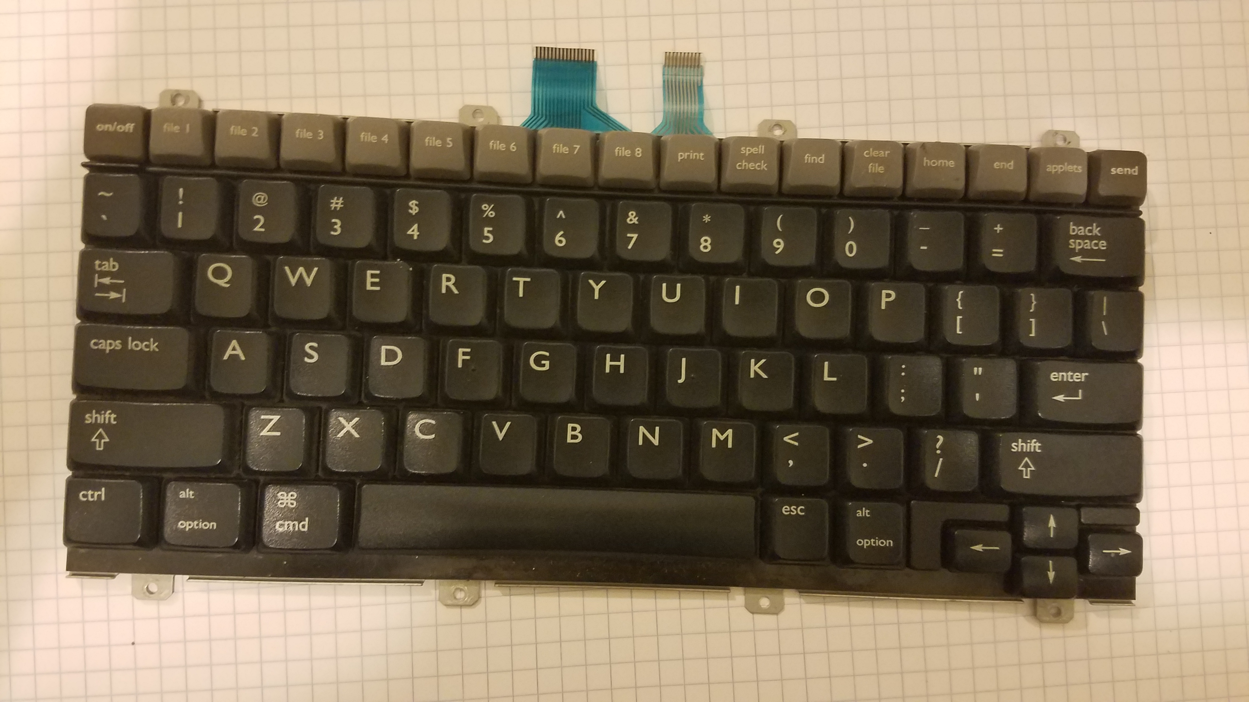

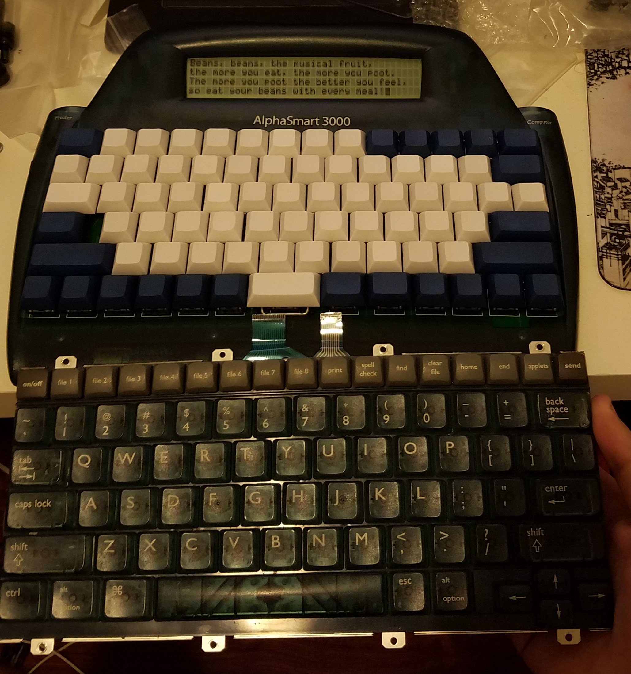

I didn't know how I'd do it when I first had the idea, but I opened it up and found the keyboard is a separate board connected to the main board via two FPCs, so all I needed to do was recreate the matrix on a PCB and connect it with flex cables. What follows is a description of this process, as well as the mistakes made along the way.
The Design
First I decided on a layout. The AlphaSmart uses standard key sizes for most of the keys, except the top row of keys, which are 0.85U, and the arrow keys, which are 0.92U by 0.66U. I reduced the spacebar and rearranged the keys to make everything fit, and ended up with this layout
177973-3
177969-4
The keyboard itself is a tight sandwich of plastic affixed to an aluminum plate, and to get to the key matrix, I'd have to cut into the plastic. I purchased a sacrificial liquid-damaged AlphaSmart on eBay and and set about disassembling the keyboard with a pair of flush cutters. I was left with the two layers of FPC that the matrix was printed on, and so began mapping it out in a spreadsheet. This is the result, with 16 lines on the bottom layer and 10 on the top layer (one of which is unused)

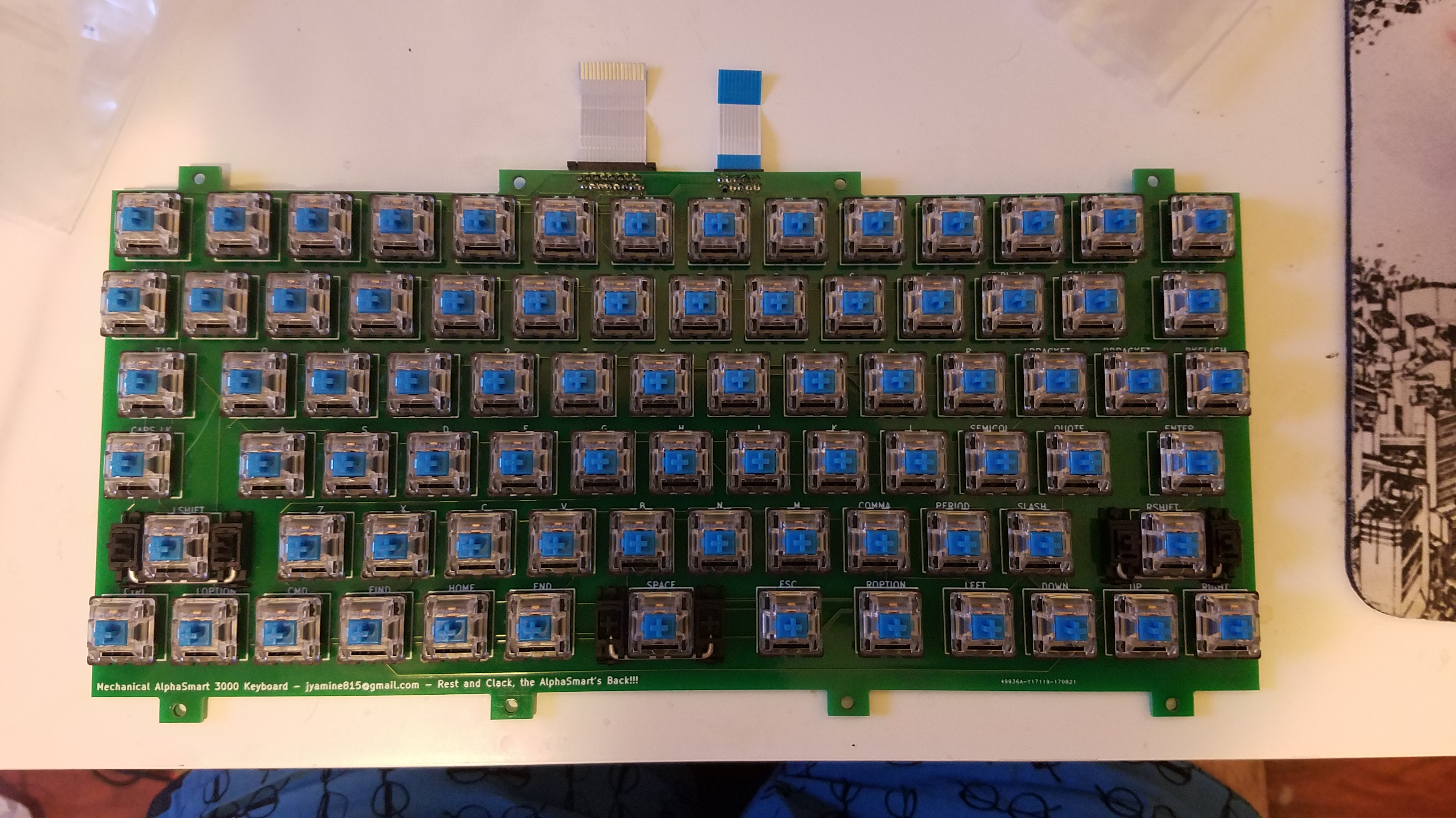

Finally I measured the board and traced it on a large piece of graph paper with notes and measurements. I'm no draftsman, and the resulting diagram was pretty muddled. The measurements, however, ended up being surprisingly accurate.
I designed the PCB in KiCAD. This was my first time using KiCAD or any EDA software. I found it surprisingly straightforward and accessible, but also like most open-source software, possibly designed for use by aliens. I never figured out how to use the push-and-shove router efficiently, so the traces are routed by hand, and in some cases look like they were routed by a crazy person. The results are linked towards the bottom of this post. The cheapest fabrication service I could find was EasyEDA for a minimum of 5 PCBs. I ordered those, as well as the switches, caps, and various other components (see below). The switches and caps came from KBDFans, everything else came from Mouser. I briefly considered trying to find some of those Kailh low-profile switches to preserve the device's size, but decided there wasn't enough information on them available and went with Gateron blues instead, which increase the keyboard's height by about a centimeter.
Building It
177975-6

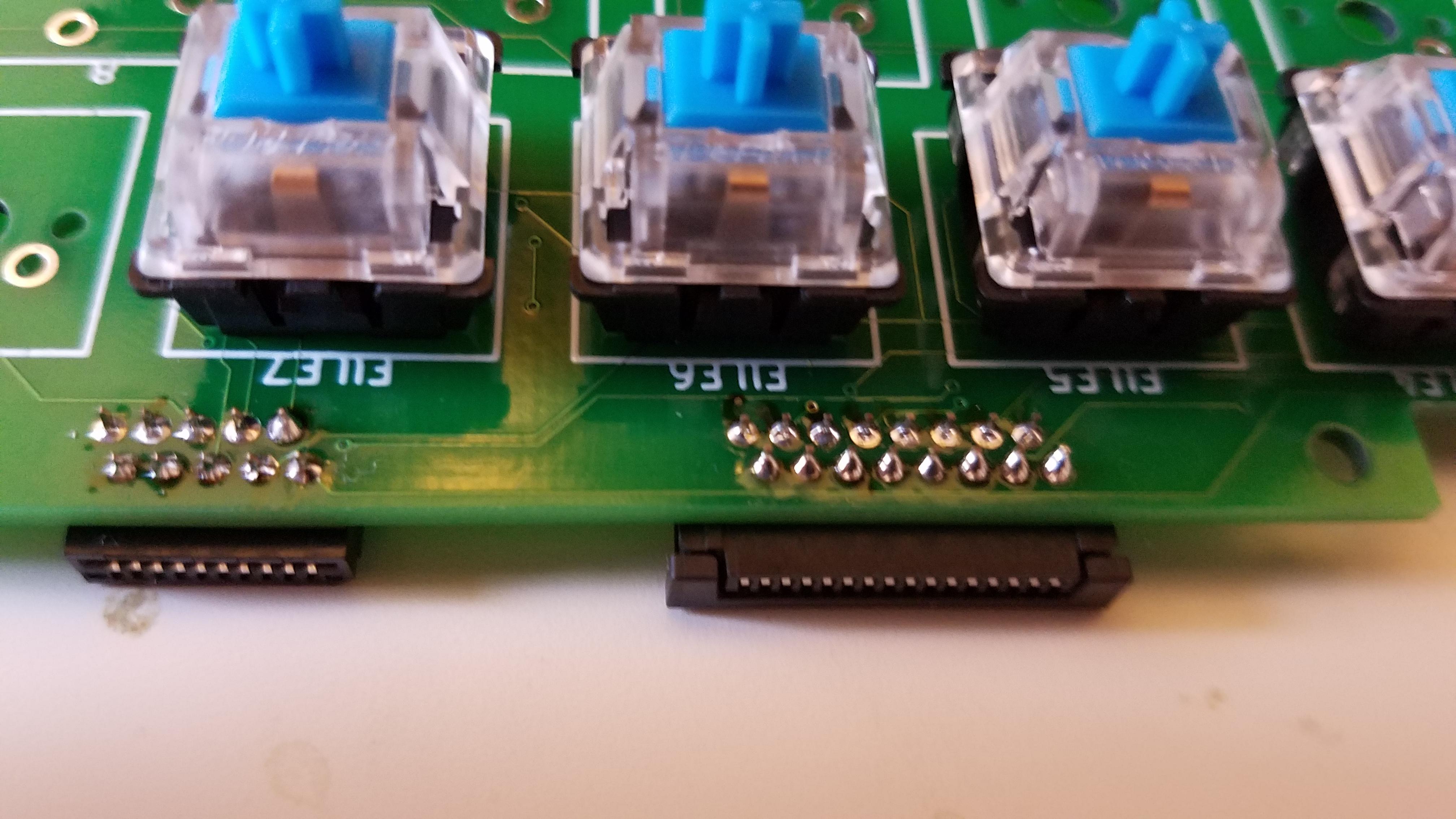

When everything had arrived, I tested how the PCB fit in the case. To my surprise and delight, all the screw holes lined up and all the keys produced the right signal when shorted. The only problem was a plastic standoff from the top half of the case that I had failed to account for slightly intersected with the top edge of the board and made it impossible to close the case.
177977-7
I considered fixing my design and ordering more PCBs because I wanted the keyboard to fit perfectly in the place of the old keyboard, but I decided it would be cheaper and easier to just cut away the obstructing plastic. I did this by heating a dollar store hobby knife with a lighter so it cut the plastic like butter. This is not a good idea at all, but it worked. Then I placed and soldered the connectors and switches, and assembled and attached the stabilizers.
177979-8177981-9177983-10

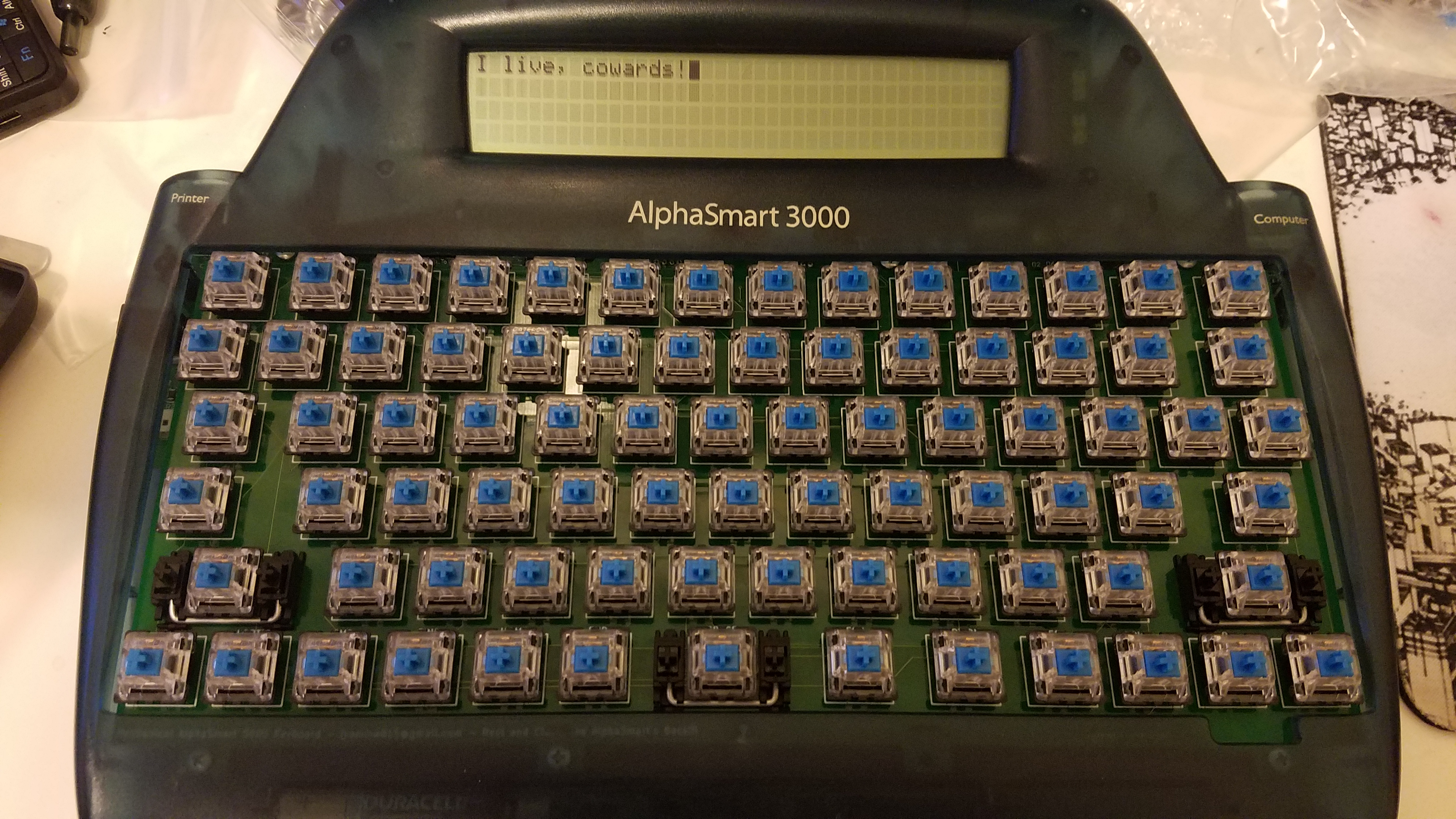

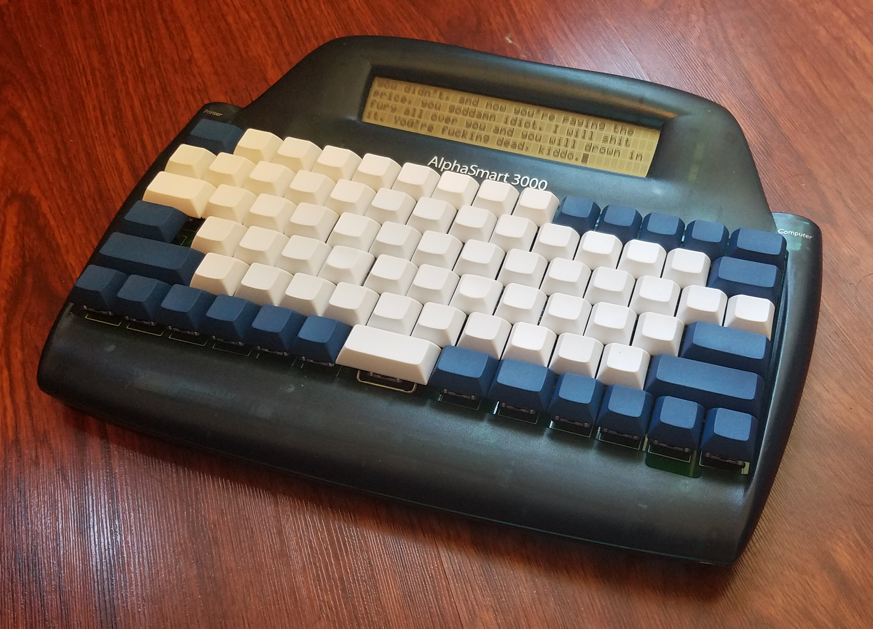

After carefully connecting the flex cables, screwing it all together, and placing the keycaps, I finally had a fully working machine! It produces predictably loud tock tock tock noises, and is an enormous improvement over the previous keys. Here I'm comparing it to the old keyboard and working on my 3rd grade book report on Island of the Blue Dolphins.
177985-11

« Reply #26 on: Tue, 19 September 2017, 08:42:46 »
I have a series of keys, a bunch in one row and a couple here and there, that aren't working. I used Gateron Clear switches. I'm wondering if it is bad switches or something else. I used rev 2 of the PCB here, ordered for EasyEDA (which took only seven days from order to arrival in California from China).
[/quote]
Could you please post some high-res pics of your PCB?
Also, I had to re-seat the ribbon cable twice. It looked like it was all the way in, but it wasn't.

Because Q, W, E, and R are all connected to the 5th pin (counting from the left if you're looking at the top of the board) of the 10-pin connector, the first place to check would be the solder joint there, and after that the connection through the cable. Are those all the switches that aren't working?
It is those ones, File 6, U, I, O, P (in a row), and V.
Which part? My ****ty soldering technique? :-)
I had wondered. I notice that the smaller one doesn't lock in on the original PCB.

U, I, O, and P (as well as Home, if that is not working) are also on pin 5, so yeah, that would be my first guess. I couldn't say for sure why V and File 6 aren't working, but again my first guess would be the soldering of the individual switches. A multimeter wpuld come in very handy here to see where the break in the path is.
First guess being "badly seated cable or soldered connection for cable"?

albill, i meant to suggest checking the solder joints on the 5th connector pin, as well as the pins on the V and File 6 switches. 2nd possibility would be some sort of dirt on the contacts of the connectors and cables themselves. If the connector simply wasn't properly seated, i'd expect more than one row to be disconnected. Again, a multimeter or some other method of checking the continuity of each section of the connection would be very useful.

All right. I took it apart, looked at my solder joints and...
1. One key was not soldered at all (WTF? I guess I had too much beer that evening...) - fixed
2. One key had a bent pin that hadn't gone through correctly - fixed
3. Checked all of the connector pins, did some melting of solder on them to make sure everything had flowed in correctly
Then I tested and everything seemed to work so I screwed the board onto the case, tested and...I was getting a 'w' everytime I pushed 'e'... WTH?
4. Unscrew, play with fragile ribbon cables, test
Worked fine
5. Screw in...same problem (or one with another key).
Finally, the light turns on. "Maybe it is when it is screwed down...why would it do that... Oh, I didn't clip the soldered pins because I thought there was lots of room. Maybe I'm shorting on something..." Turns out that the switch pins were just long enough, it looks like, over there to touch a PCB component or something. Got the flush wire cutters, clipped everything, reassembled and it all works with no problems now.

That looks fantastic! One of my favorite things about the AlphaSmart 3000 is the translucent plastic case, and I think those keys complement it perfectly. I will point out that the intended layout has a 1.5U tab key and a 1.25U caps lock, leaving a 0.5U gap between caps lock and the A key (I know it's strange, but it allows compatibility with keysets that only have 1 1.75U key, which I believe is most of them).
I looked at my pile of clear caps and this is what I had to work with...
