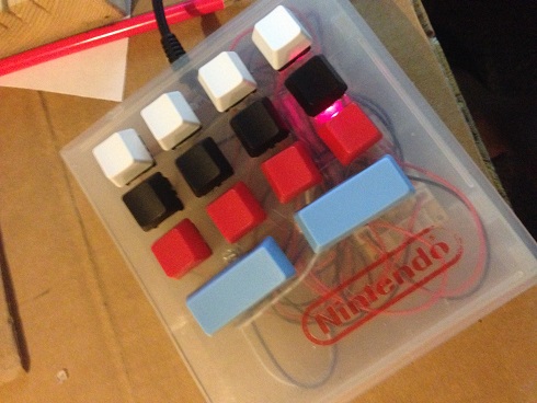

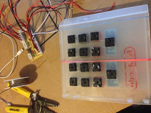

Back in my intro post several weeks ago I mentioned making a Max Falcon 8 Style keypad out of an old credit card, and that project moved along pretty well, until I discovered I could use all my extra switches and bring an old Nintendo collectable out of storage into every day use. (you can actually see the pseudo falcon in the top of the first pic)

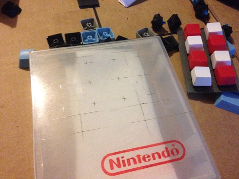

I had to cut through the case of course, first with a large drill bit and then making the final adjustments by hand with a pocket knife to fit the MX switches as close as possible.
When I got my ergodox, I got a full set of 104 (or however many) keycaps from Max Keyboards, and I got the function row keys in different colors just hoping that I'd someday have an excuse to use them on something.  I guess if I'd have known what I was going to do, I might have selected different colors, but for a first run I think this looks fine

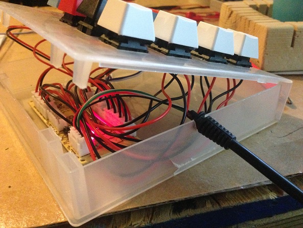

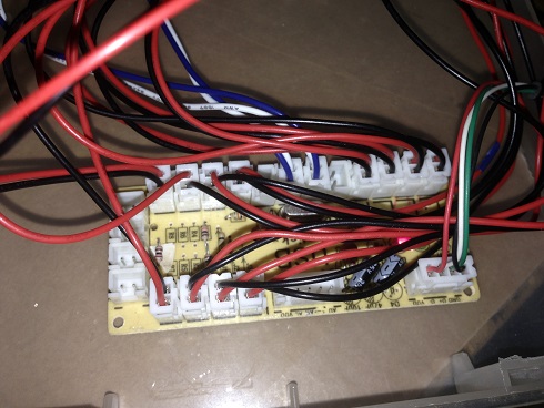

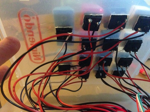

The USB controller here is only about $12 and you can get them on ebay or amazon, and they come with the wires and connectors for sanwa buttons, which is great if you're building a hitbox (pics of that later).  But I removed the connectors and stripped the wires and soldered to my MX switches.  The computer reads it as a "generic usb" device so it doesn't interfere with your keyboard AND you can have AutoHotKey pick up the keystrokes as "Joy1...32" so you can assign autohotkey functions to single keystroke, no modifiers required.

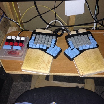

Next to my Ergodox.  It's portable so this isn't it's permanent home, but it works for now.

I didn't know AHK could interpret other devices like joysticks, that's really neat! I built something similar with one of those mx switch samplers and an adafruit trinket, but you need to get the device to send modifiers since it is interpreted as a keyboard.
What is the name of the controller you are using?

It's listed as this on Amazon: "Reyann Zero Delay Arcade USB Encoder Pc to Joystick for Mame Jamma & Other Pc Fighting Games"
AHK can actually read up to 16 joy sticks at once, so you could have multiple ones of these all plugged in, and AHK reading everything.  I've got two more in the mail from ebay and I'm going to try and build some pedals with one.
