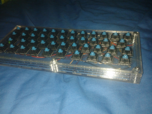

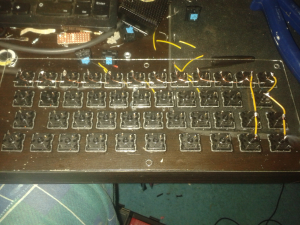

this is the design with the keyswitches installed and beginning of the matrix. i actually found out that if you take the top of the mx switch off, there are 2 spaced out holes that you can fit a diode into, so i did that. sadly the orientation of the diodes meant that i had to do solder the matrix in a weird way. I fixed it by reversing the pattern.
141542-2

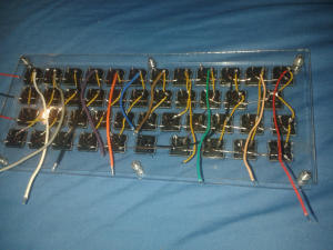

I had the matrix done and at this point i actually had now left school so i could not collect the side plates. they were supposed to be done weeks earlier but as i mentioned, the laser cutter actually broke so i either had to sneak into school or get my younger brother to collect them after i'd gone. after testing to see if everything fits together, i no longer have anymore done because i am using my teensy for my apple IIgs keyboard. if that sells, i will take it out and then use it.

the current height without the switches or bolts is 21.3mm and about 33.8mm from the top of the stem to the bottom of the bolts
I also made some mistakes. firstly NEVER solder over the back plate or any acrylic that will be used for that matter. whilst I was in the process of making a mini pcb for the teensy, i was soldering some leads into stripboard to hold the teensy in. the heat melted the leads straight through the acrylic   :eek: . another massive mistake i made was soldering the whole design backwards. you may notice that the finished design and the making of the matrix photo are the same way round but one is upside down. this is because out of my excitement i soldered the switches in as soon as possible and not realizing that the plate was flipped. i ended up cutting each row and column and resoldering the whole thing  :blank: . as per usual, it took hours but luckily was watching a good Nicholas Cage film to keep me motivated :D

i proceeded to solder the rows and columns to the teensy. this was tricky as the wire i used just reached. the other problem was i used some very thick core wire which was hard to solder to the tiny teensy pins.
