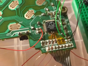

142886-1

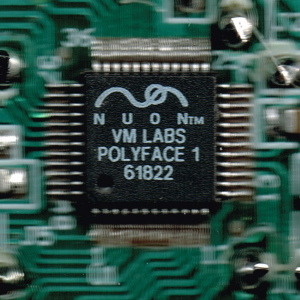

A complication in getting this feature functional is: unlike the Jaguar system, where you can hack a rotary encoder to the button inputs on a standard controller, the Nuon has a chip, called the "Polyface" chip, inside each controller.
142880-2
This chip tells the console what "features" the controller supports, like quadrature rotary encoder (spinner), analog sticks, shoulders buttons, etc.
By extracting entries from the BIOS we can see there were DOZENS of controller variations that were going to be supported, steering wheels, fishing reels. Almost starting to sound like the Konix Multi-System, another Jeff Minter vaporware special.
142884-3
There were even provisions in the chip configurations for VMU functionality, memory card support, serial I/O, micro controller interface and 3D shutter glasses, but so much for over-engineering.
So that's the background info, we're getting close to making this actually work, we've electrically interfaced the quad encoder to the GPIOs on the Polyface chip (thanks to some dug up reference documentation on the Polyface chip and a home-brew controller dump program), and now it's just a matter of brute-forcing the correct configuration resistors to expose it to the system the way the game expects.
