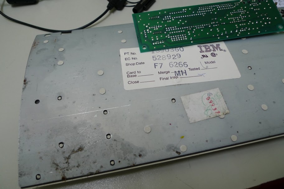

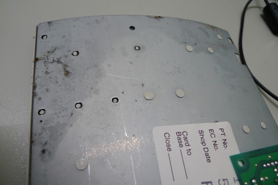

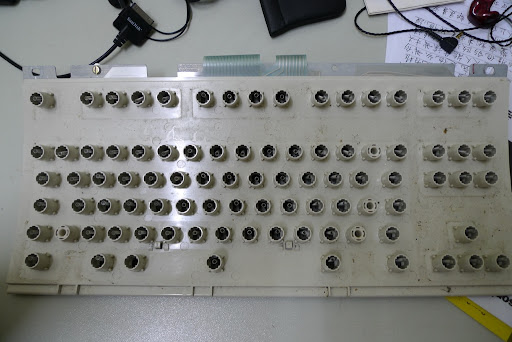

Alright, manage to take this beast apart (did I mention how heavy this was? It's almost 1.5times heavier than my Filco Tenkeyless).. and I think this is the cause for the oilyness?
Is it normal that all the springs are not pointing upwards from the barrel? Or does this mean I need to order the hammer/spring assembly from Unicomp?
Upon taking apart, a few ants crawled out like "yay! finally daylight!", lol.
Saw ripster's bolt/nut rivet style mod and was thinking of doing it to reduce the pinginess, so far the most pingy sound comes from the spacebar.
What do you guys think? And also, how do you guys clean the keyboard plate without removing the rivets? Is there anywhere to put the rivets back in anyway?

i wonder if the discoloration and the broken rivets are related

« Reply #8 on: Tue, 05 January 2010, 12:17:25 »
My rather uneducated guess is that the keyboard was stored in a damp or humid place for a long time, and the moisture ate into it, or something like that.
If memory serves me correct, the 42H1292 that Sandy did rivet surgery on had a similar problem. He claimed that he had found that particular one outside in a skip somewhere.

« Reply #10 on: Tue, 05 January 2010, 21:46:34 »
Well, they do feel consistent throughout, but here's the weirdest thing.
The only click-clacky sound comes from the directional arrow key area and the printscrn/insert/delete area above it.
After that, the function keys starting from F12 sounds pingy, no click-clacky at all.
And this extends throughout the keyboard, and the moisturised area is near the tab/capslock area but doesnt seem to affect the sound at all.
Why is it that a certain area sounds clickety-clacky?

the stems on my model M where oily as well, I left them like that, but i suspect someone might have sprayed them with jigga-loo so that they slide better
I tend to think that keys that are directly on top of a rivet sound different than the ones that are half way between two rivets, or just far from them
you mentioned you don't hear the click, is it possible it was greased? look inside the stem of the silent keys to see if there isn't a thin coat of grease in there, dosen't take much to dampen it
the springs don't have to be centered in the well for it to click fine
i had about 50 broken rivets so had to mod it with bolts, back then the clicks were not even, some would click early in the keypress, some would click late, that was because there was gaps between the actuator panel and the plate, and the rivet mod fixed that, once you're done with that, you can fine tune the sound(ping) as much as you want with grease(add very little at a time)

Welly said that if you put enough grease on the springs, they no longer click but work fine otherwise, if not feeling mushy.  It could just be that there is enough crap on the springs that it still works OK, but not in the classic Model M sense.

Thanks for all the replies guys, I think ripster's one is correct, the guy seemed to be over enthusiastic with the greasing I guess.
The sound is less deep. rackety click-clack and just higher frequency near the areas where rivets are still existing (sorry for the confusing statement earlier on), but the area where the rivets broke off and seeping occured sounds more deep and fulfilling.
It's almost like the pinging covers up the rackety click-clack of the springs itself. Time to do some nut-bolt mod, thanks for the linky.
