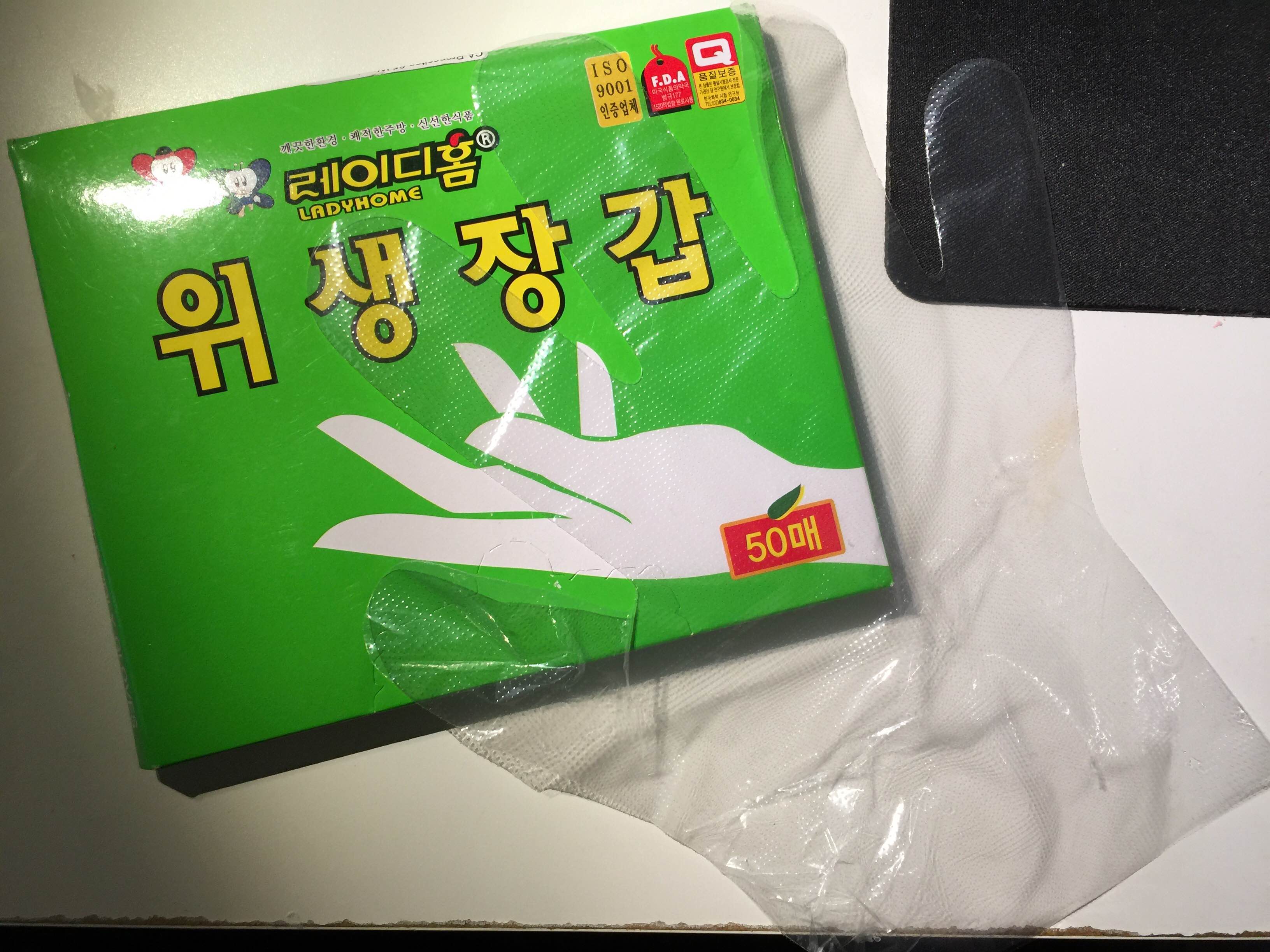

1. Get these plastic gloves from Asian markets!
They work incredibly well and sell for dirt cheap. You can get them by the 50's and 100's for something like $2 - $3. I figured these were much cheaper compared to their latex counterpart and easier to wear & take off (cos they're huge!). (I also use disposable wooden chopsticks for mixing and other general purposes 100 pairs - $2.99)
