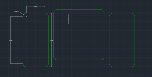

Hello. I'm just finishing my first TKL drawing but having some questions on stabilizers. I have grabbed the KMAC TKL design and remodeled it.
162560-0
I'm having some doubts about the stabilizers that should be used. I have attached the LShift part drawing. Can someone give me an advise are those dimensions right and what should be the stabilizers. Thank you in advance.

I'm 99% sure the drawing above is for using PCB mount cherry stabilizers, so in other words it is just an opening for the stabilizers to pass through and mount onto the PCB.
You might find this useful
https://geekhack.org/index.php?topic=47744.0

Thats also what I thought but wanted to be 100% sure. So now I have to remodel the spacebar and all of the stabilizer wholes :( it will be long night. Will have to center the spacebar and this will be difficult. The drawings are available if anyone want them :)
