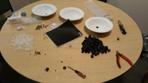

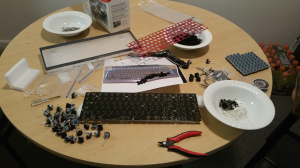

I started out with 100x Vintage MX Blues, 100x Clear Switch Covers, 100x 62g 24kt Gold Sprit Springs, 100x 2x3x4mm White LEDs, 100x Pair of Sip Sockets Clipped, 2x MX Locks, 2x 78g 24kt Gold Sprit Springs.
111880-0

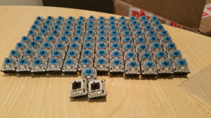

I opened up each switch, replaced the spring, inserted the sip sockets, put the clear switch cover on, and then snipped each LED to fit.
I decided to go without switch stickers since they have very little(if any) benefit and take up a tremendous amount of time.

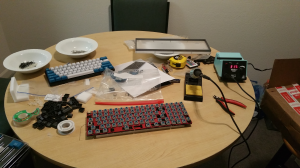

111884-2
Soldering Time!  :thumb:

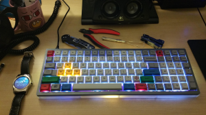

111886-3

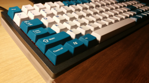

Soldering done but decided to go with a single MX Lock for the Stepped Caps Lock and since I damaged a pair of sip sockets I ended up being short 2x Pair of Sip Sockets & 2x 2x3x4mm White LEDs

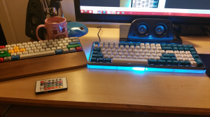

111888-4

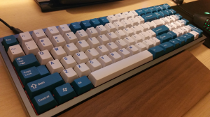

Ending Shot with temporary GMK Triumph Adler set, waiting on GMK Hyperfuse.

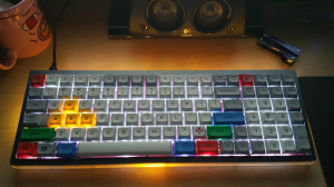

111890-5
Close Up Shot

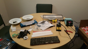

111892-6

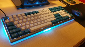

Plugged In and Programmed
111894-7
Current Setup

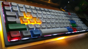

I later on saw that my windows key was flip-flopped, it's corrected now but too lazy to take new pictures.  :p
Update: Managed to get the sip sockets aligned close enough to the LED hole to get a LED to work. I fixed the Windows key as well  :thumb:
