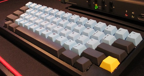

An image of my assembled keyboard is shown below:
The spacebar and modifiers are blank black PBT in Cherry profile from Imsto. The alpha keys are black on blue dye-sublimated PBT from Imsto. The Fn key is a blank yellow PBT keycap from Originative.
