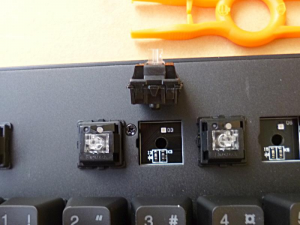

The switches are detachable, using an included combined keycaps/switch puller. The mounting hole is notched to allow insertion in only the correct orientation.
174229-1
Four additional clicky switches were included with my basic keyboard. If you would order the "Premium" package you would get a full sets of both switch types.
The clicky switches use an internal secondary slider and a click leaf situated next to the light guide.
The tactile bump is a bit earlier than Cherry MX Blue and it is a less tactile on press. The rebound is more tactile than the press. There are better-feeling clicky switches than this.
Wooting calls the linear switch "Red" and the clicky "Blue", but both have black housings and transparent sliders.
The clicky one has an internal secondary slider and click leaf like genuine clicky Cherry MX -- and the internal slider is orange, which you can glance through the top of the clear primary slider.

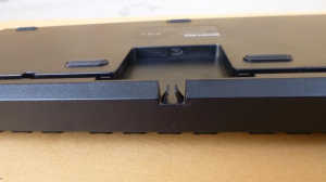

It is not my most quiet keyboard, partly because of the floating designs and the thin keycaps.
I suppose that O-rings can be installed, but rebound rattle is almost worse than the sound of bottoming out.
Zealencio silencing clips can not be installed. The shape of the top housing is relatively close to Cherry MX but it bugles out near the light guide - because that is where the leaf spring for clicky/tactile switches are.
A part of the bottom housing is also in the way. You would have to cut both in the switch and in the silencing clip to make them work and then the clip would still be backwards- which would limit you to thin keys or OEM profile with additional O-rings ...
If only Adomax/Wooting would make a silenced clone of Cherry MX Clear, that would be perfect. ;)
Apart from the rubbery thin keycaps, the build quality appears to be quite good. (I have not looked inside yet.)
The finish of the metal plate on the top is very similar to the finish of the plastic sides. There are no less than seven rubber feet on the bottom and the flip-out feet are also rubberised.
It comes with a fairly thin braided cable with a micro-USB plug that plugs underneath and it has Wooting-branded velcro strap. The cable gutter is well designed with exits centre, left and right - all facing back and with clips to fasten the cable into.

I did get the Blue switches swapped in, and I am much happier typing on those, although they are still not near heavy enough for me. Replacing the switches took about an hour, and being able to do that without a bit of solder is a much more enjoyable experience!
As for the color of the top-plates, both are actually black, the one that is originally shipped with the keyboard is a matte finish, the second one I received with the premium package has a brushed aluminum look. I didn’t have enough time to open up the board and do a thorough forensic exam on it, so I decided just to stay with the original top-plate for now.
