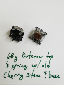

3:  Outemu top and 68g spring with Old Cherry Brown stem and base.
Very similar feel to the other Cherry based Brown, but with a more pronounced tactile bump.  The switch has a much snappier feel to it that the 62g browns.  There is a slightly scratchy feel right at the top of the travel, but this may be due to the increased force to get past the tactile bump which is near the top of the stroke.  Very similar feel to an un-lubed 67g ergo clear which is to say, the extra spring force makes the stroke feel grabby.  Cap material choice made an even larger difference than either of the 62g browns.  The this SP cap had a very hollow feel to it that really accentuated the tactile bump, while both of the thicker caps gave the switch an almost Topre like thocking quality.
175640-2

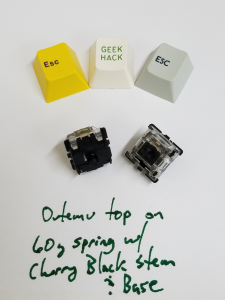

4:  Outemu top on 60g spring with Cherry Black stem and base.
Ok, and trend is starting to show up; all of these cherry stem and base combos with the Outemu top are smoother and more stable than their Cherry topped counterparts.  This is a very smooth MX black.  It almost feels lubed, but is just missing the slightly silky quality that lube provides.  If I was a fan of linear switches, this would be a great option.  There is once again, a pretty large difference in feel switching among the cap material, but really only the volume of the bottom out and top out in which the SP is loudest (and hollowest sounding), PBT slightly quieter but higher pitched and GMK the most subdued.
175642-3
