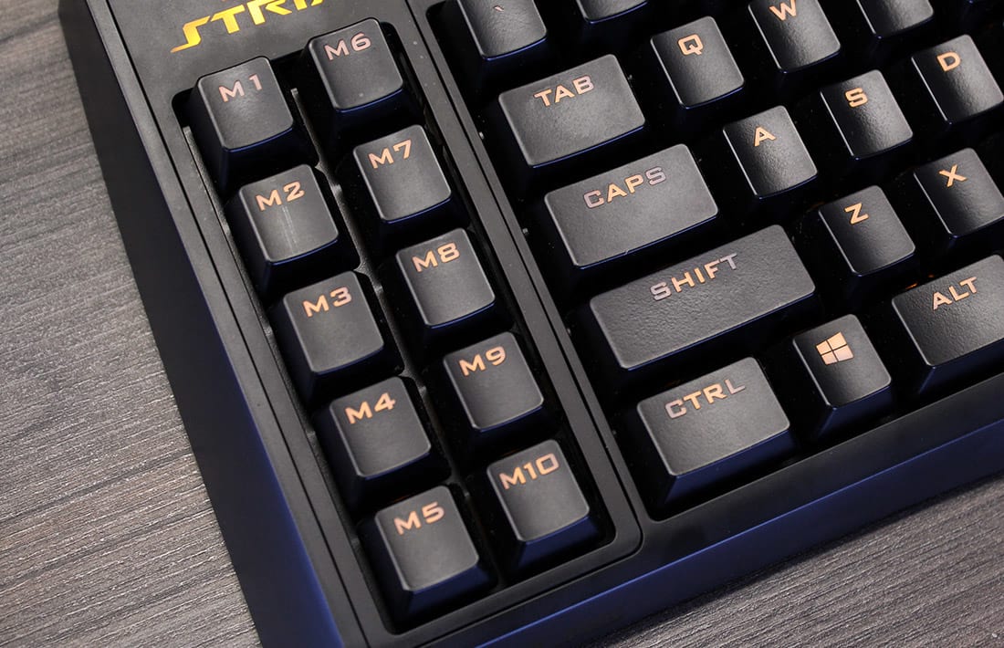

Also, about the key caps, this is an ANSI keyboard. Can i use an off the shelf set of PBT/ABS key caps to replace the OEM ones? Here is a picture of the default ones.

You can replace keycaps but you'll lose legends backlighting unless you replace them with the same kind of keycaps. That's personal taste and choise.
