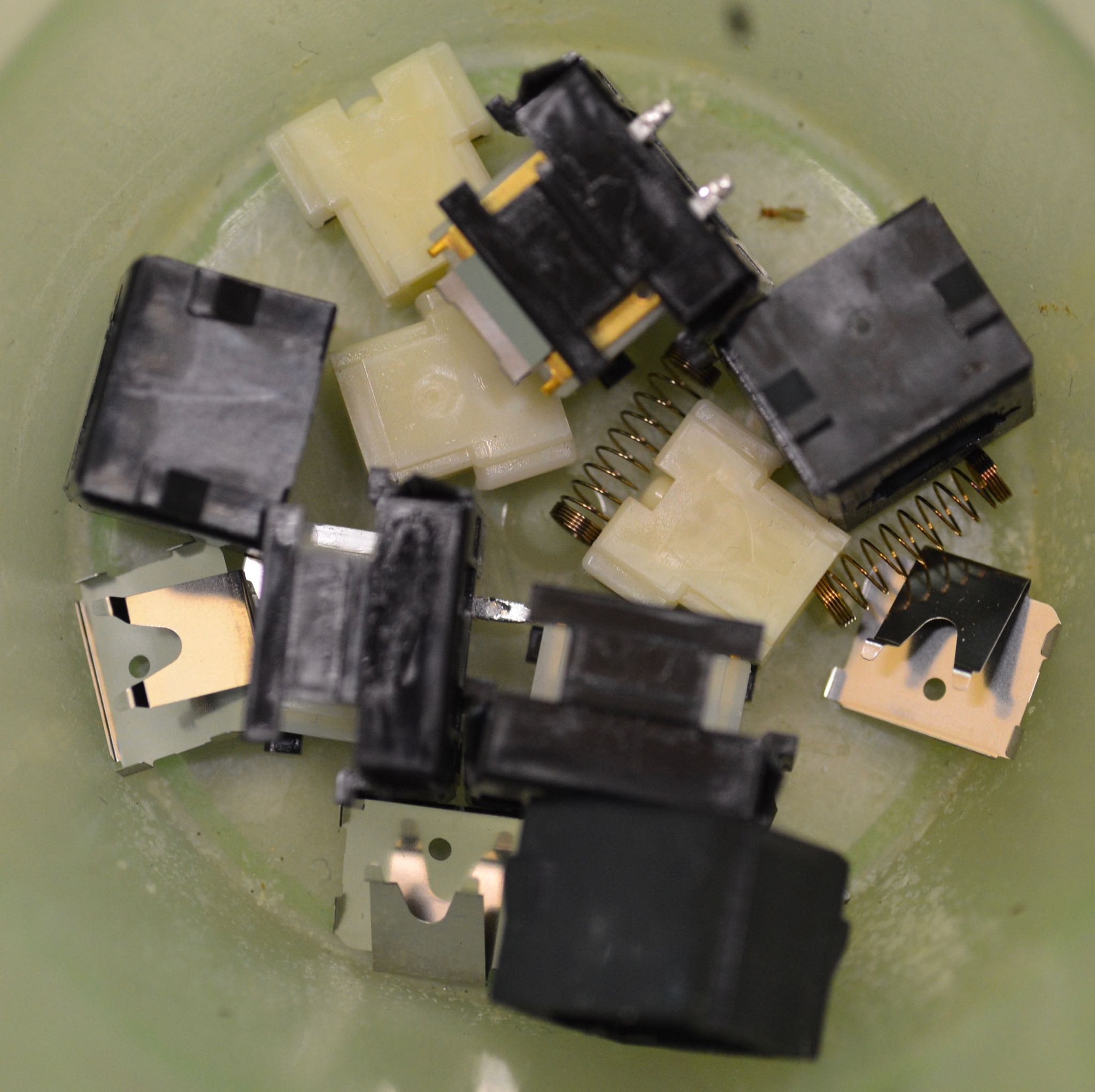

I experimented today with cleaning some Alps switches. The configuration was as follows:
Alps SKCM White and Cream Damped switches
iSonic P4820 ultrasonic cleaner
Solution consisting of two Efferdent denture tabs, about 1.5 tsp 7th Generation dishwasher fluid, and reverse osmosis water at about 60 C
Disassemble switches
Clean for 480 seconds
Remove, rinse in distilled water, dry, and assemble

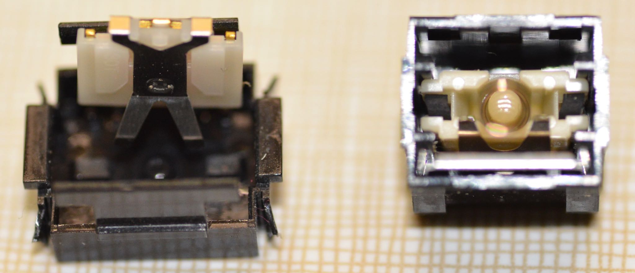

Here is a photo of the disassembled switches:
147430-0
Switches disassembled. Switch plates remain in lower housing. Upper housing, click leaf, slider, and spring are separate.

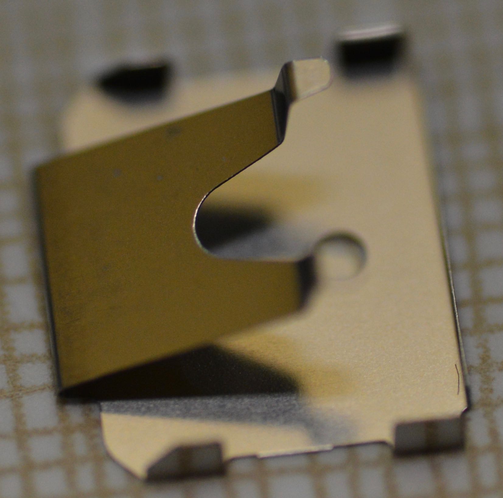

Here are detail photos of the click leaf and the switch plate post cleaning showing no visible damage.
147432-1
Switch plate detail post cleaning.
147434-2
Tactile leaf detail post cleaning.

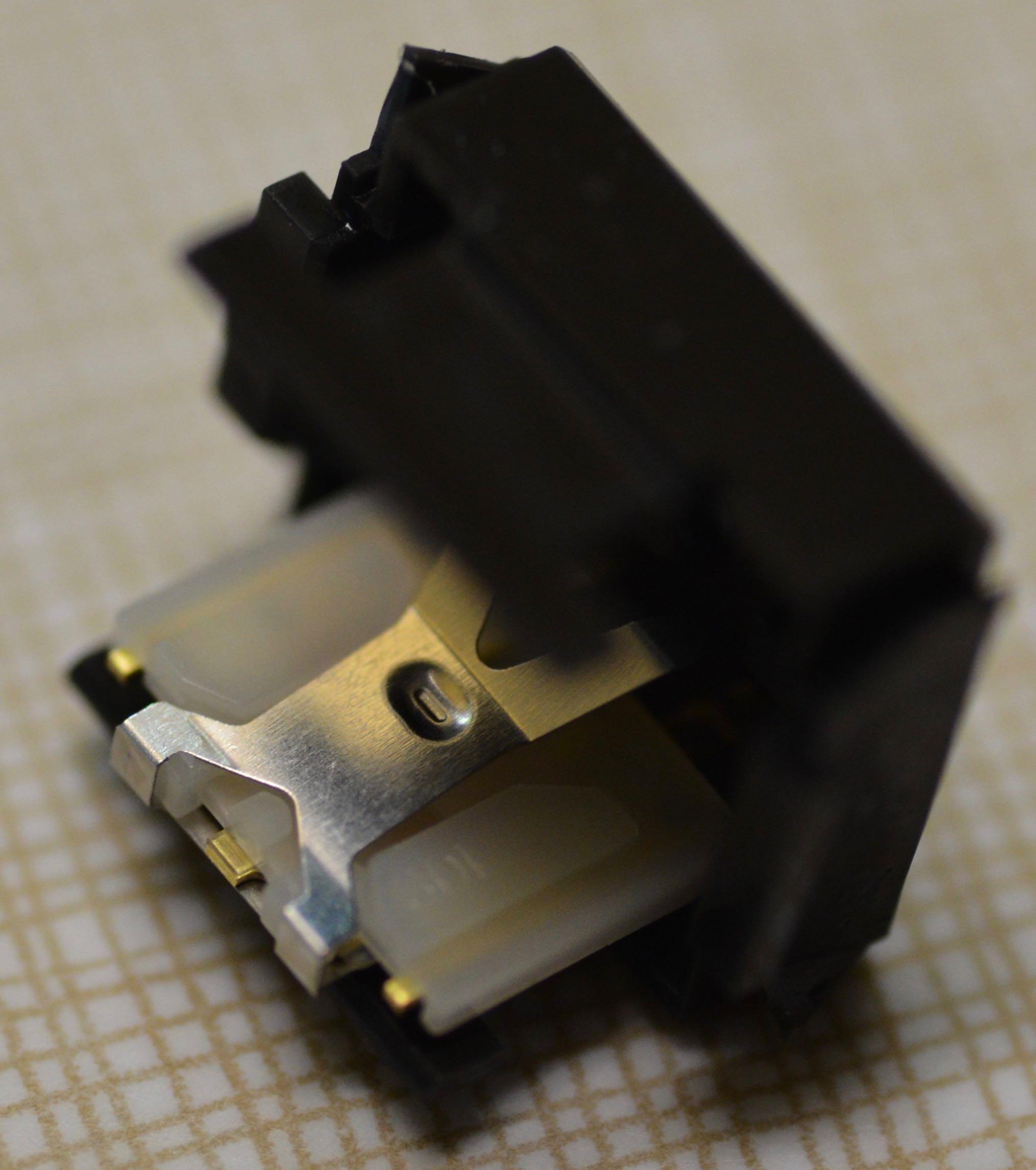

Here is a photo of the switch about to go back together.
147436-3
Assembly post sonication.
The switch feels brand new. I cannot detect really any grittiness or hesitation. Some switches still hesitate a tiny bit in response to aggressive off center key presses. There is a small chance that enough abrasion over time roughens the plastics themselves.
