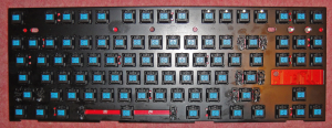

The main reason to get the G87 over the C87 version is the keycaps.  I have Ducky PBT dyesub on my Ducky keyboard and using them as a reference these Vortex are just not to the same quality standards.  I somehow managed to remove them from the keyboard, but it is a mystery to me how I did not end up breaking a few switches in the process.  They must use a hammer to install them in the factory, and upon very careful inspection I noticed some small chips on the black plastic around the piston of the switches on the two narrower sides.  I wonder if this happened due to the excessive force required to push in the keycaps, or because the stems of the keycaps have larger diameter than they should.  In a few switches they looked almost like dents that seem to interfere with the free movement of the piston.  Other than that, on a few of the keycaps the legends seem to be slightly indented, not completely flush with the PBT surface.

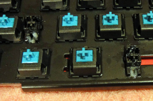

The next negative impression that I got while removing the keycaps is the excessive lubrication on the stabilizers.
127348-0
127354-1

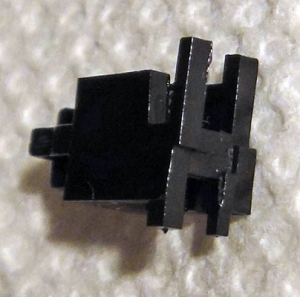

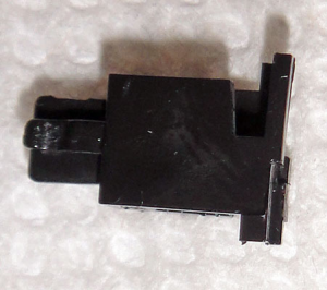

There is hardly any need for any lubrication for these slow moving plastic parts.  The fact that they did it speaks well for iKBC, but if done at all, it has to be done correctly.  It is not impossible to imagine that maybe very little can help a bit to smooth the travel, but too much will have the opposite effect only after a few months when all the debris that falls through the keycaps gets attached to the sticky lubrication and starts to rub against the plastic.
The stabilizers themselves are modified Cherry, and I think the same used in the newer Ducky keyboards (edit: I haven't taken apart a Ducky, but based on the feel I think they are different.  Ducky's stabilizers don't seem to make any contact with the PCB, giving the same feel as if they are clipped).  I don't think they are made by Cherry corp.  I compared them to original Cherry stabilizers, and they seem to have slight differences, besides the modified legs.  They are not really clipped, just molded this way.  I think they can still benefit from clipping, like regular Cherry stabilizers, giving them a slightly larger range of motion.
Unclipped, I think when these stabilizers bottom out they do come in contact with the PCB, potentially giving a slightly different feel to the regular keys.

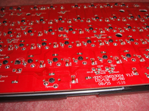

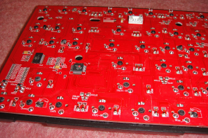

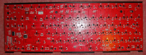

Finally after opening the keyboard I was a bit unpleasantly surprised by the craftsmanship of the soldering on the PCB.  It wasn't cleaned very well, and there were quite a few soldering points with a bit of excessive solder on them.
127358-4
127360-5
127356-6
