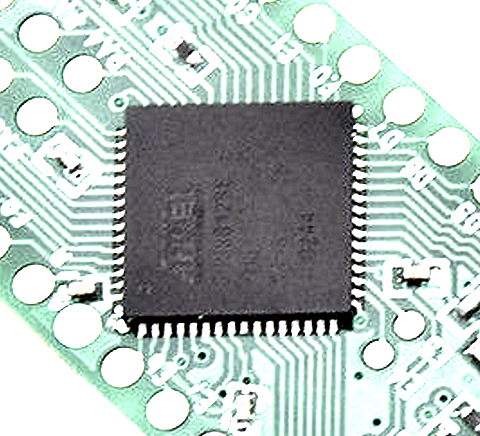

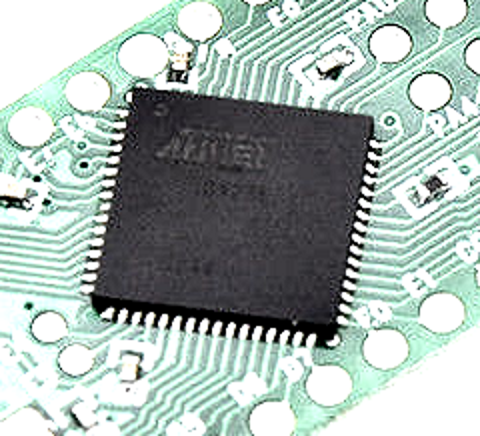

Here's the best I can do with enlargement and contrast enhancement:
Make any difference? You guys know more about this than I do.
Yes, it's a counterfeit, not just a clone, as the listing claims that it's a "Teensy USB development board")...
