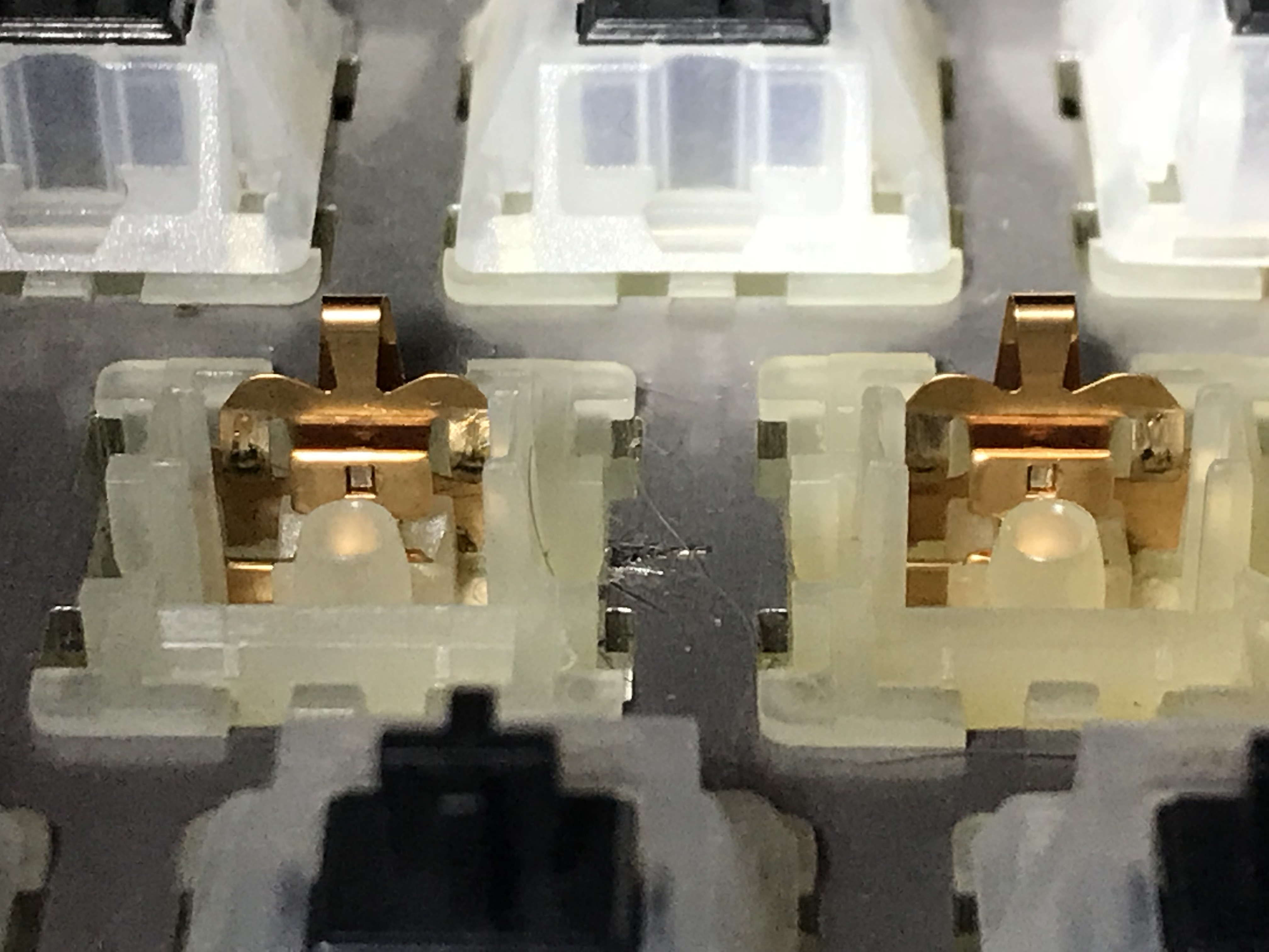

« Reply #4 on: Wed, 15 August 2018, 20:43:50 »
Its definitely the leaf. I noticed the leaf in the W is more dull than the leaf in the E.
I looked at the stems, the housing, and the springs and saw no difference.
You can really see that the right leaf in the left switch is worn and a little discolored.
Sorry for the mediocre photography.

« Reply #5 on: Wed, 15 August 2018, 21:44:30 »
Seems like it is the Leaf  :blank: . Rip Gateron i liked them but now i think i have to transplant the stem and spring into a cherry housing to keep it smooth for years.
