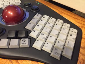

Three years and three months ago I completed, what was to become, my favorite keyboard. I've since built a couple other boards but none could replace this one at my desk. Today I thought it was time to replace a few keycaps and clean it up (just a little). So what have I learned?

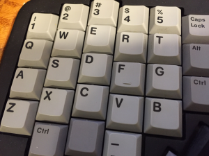

First, dye sublimated PBT caps hold their texture and legends much better than pad-printed ABS.
I used some Cherry ML ABS caps from an 8400 series keyboard which had an embedded number pad (they're the ones with the boxed, second layer legends). You can see the obvious wear in the second picture compared to the PBT dye-subs on the left side.
 201954-0201952-1
Replacing the caps was as simple as harvesting caps from a spare donor board with PBT dye-subs.

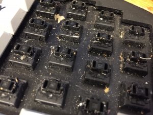

Second, this is what three years of eating mixed nuts at the desk produces.
201956-3
The swap did more to rejuvenate the Alumaplop than an afternoon at the Day Spa. The keyboard has an embedded number pad but I never use it so it was easy to ditch the corresponding legends.

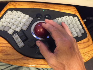

Fourth, I still love the Slimblade mounted in the center of the keyboard. Two valid complaints about the Slimblade are the bad switches and the wrist extension and excessive pronation necessary to use it. By using better switches in the right place (the modified gaming switches) and a different hand orientation, those concerns fade away.
This picture shows my hand in its position to operate the trackball. Extremely comfortable to use and very close to home position. The buttons are right where they should be and my wrist is tilted about 30º. My ring finger spins the ball for scrolling and in spite of the picture, my little finger is not that close to the keycaps. I've never accidentally hit a key when using the trackball.
201962-5
Pardon the filthy hands. I was working with polyurethane glue today and haven't yet had a chance to take a bath in MEK, but the unsanitary conditions also serves to make a point: I've heard of people having to clean their trackballs frequently because of dust and lint but I only notice performance issues that require blowing out the dust at about six month intervals. Go figure?
