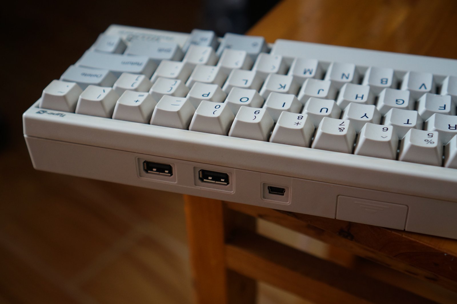

The back looks the same as original. I really do not like hhkb bt's big ass.

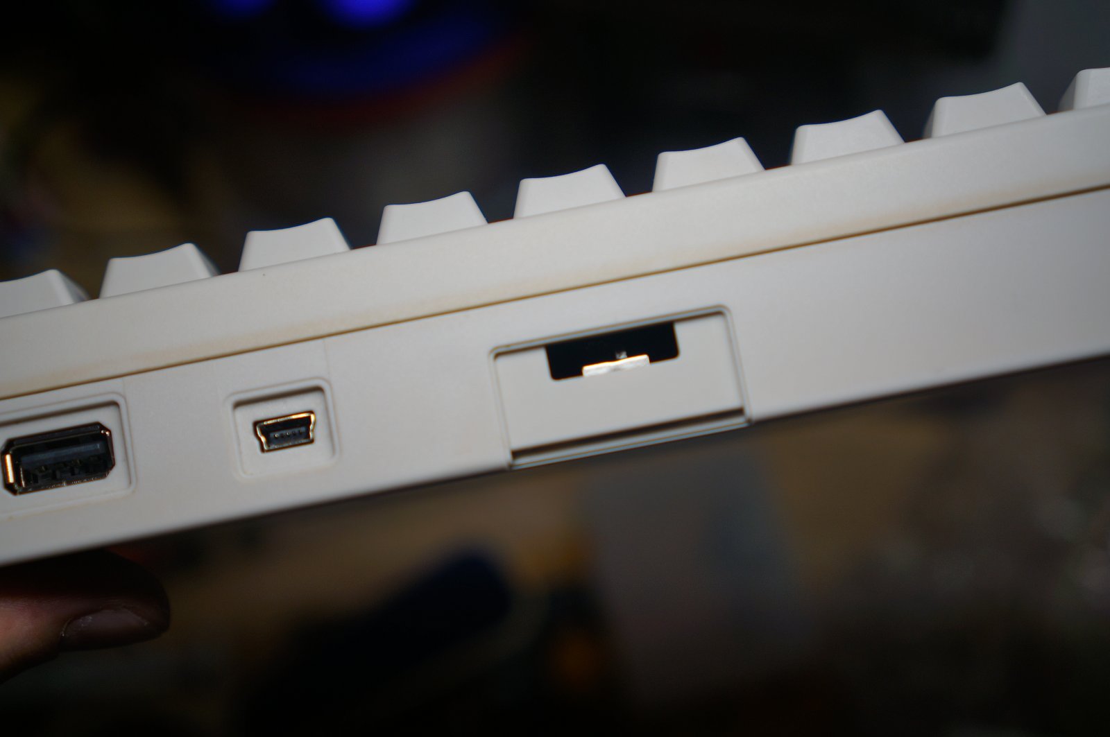

the battery switch is here. It's not angled as I want to close this cover. Just use this cover can reach and switch it.
217466-1

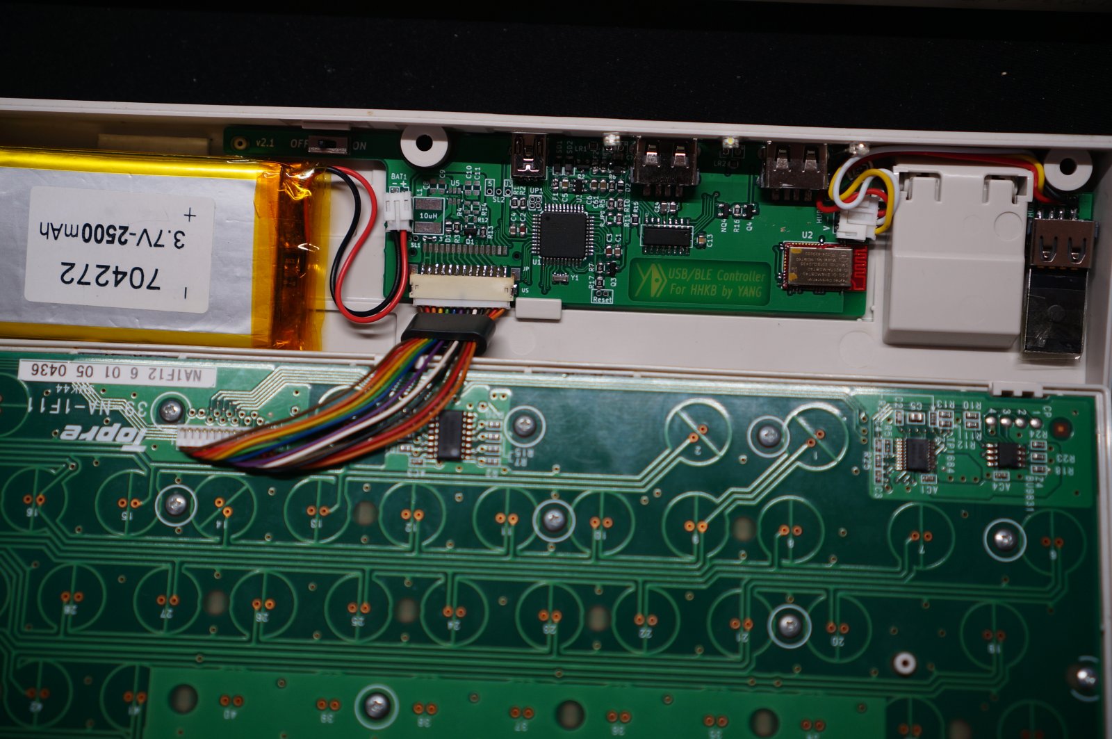

PCB is made to be smaller, so there is more space for battery. I use a 2500mah battery for 17 days and it still works. It can't be long like some bluetooth keyboard but I think it should be enough.
atmega32u4 with 8M, mdbt40 module with adafruit's firmware. https://learn.adafruit.com/introducing-the-adafruit-bluefruit-le-uart-friend/introduction

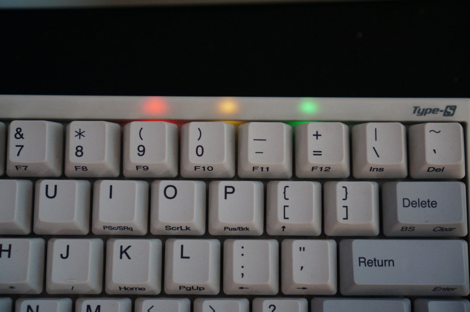

It has 3 leds. They may be blind with black case. There are two more leds under each usb port. I will add its pic later when new board come.
217470-3

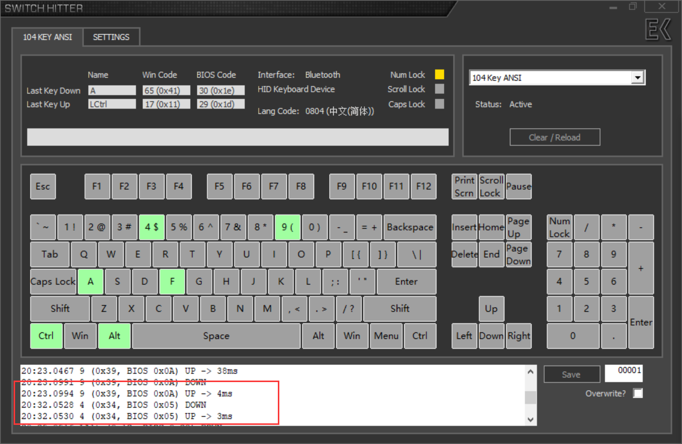

first I used 60MS, but it may miss some keys when waking up from status 1.  I used Switch Hitter to test then I found that when waking up, some keys' pressed time was very short like the pic below show. So typing two fast from status 1, it may miss the first key. WDTO_30MS works well.
Even 30MS, HHKB JP still may miss the first key if it is in row0 or row1. I did not understand why this happened. But to solve it, when watchdog wakes up, I scan the matrix once and then scan it again to check if any key is pressed. It works and no key is missing with HHKB JP now.
Update: Some HHKB US also needs this.

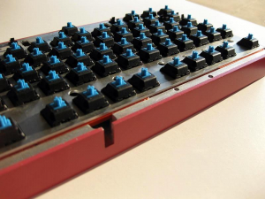

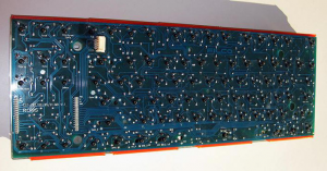

I broken my fc980c.
217474-0
217476-1
