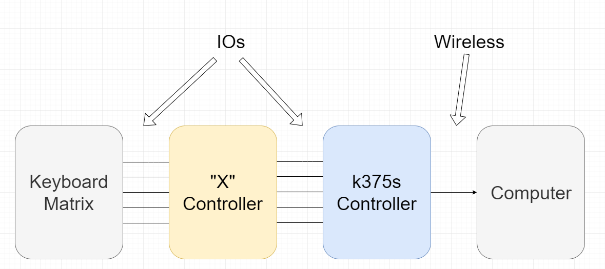

Hello guys, I'm planing to make my own layout keyboard, which have the following features:
1. has minila like layout, which have 67 keys.
2. need hot keys and programable.
3. wireless(using logitech unifying controller in k375s)
After a little search, I found the QKM which is a powerful customizable firmware I can use.
The logitech unifying controller in k375s is not programable, so i need another "X" controller to flush the firmware. So the architecture is like this:
229211-0
[ Keyboard Matrix ]---io--->[ "X" Controller ]---io--->[ k375s Controller ]---2.4g or BT--->[ Computer ]
Another solution is using u2u, but it's too big for me... If there is more small enough u2u board please let me know.
The QKM firmware is using the Pro Micro(ATMEGA32U4) in general, but the number of it's IO is not enough for me. (23 IOs for the k375s controller and at least 8+9=17 IOs for the keyboard matrix.)
So now I have some questions list as follows:
1. Which controller should i use?
2. Do QKM suport STM32? If so, how about the power consumption compare to the ATMEGA(considering wireless)?
3. If I want to choose the "IO2IO" solution, which file should I dig in in the QKM source code?
I am realy very new in the keyboard customizition, so the questions above may very dull here. But I am still looking forward to your reply since any advice will help me a lot.

I'm no QMK expert but it supports the Teensy 2.0++ which has 46 IO pins so you could order one of them while you research.  Don't be tempted by the cheap fakes from China, you never know exactly what you get so when things don't work you can't be sure whether you did it wrong or it's a difference in the controller. Not to mention fakes are bad morally.

Thanks for your reply! 46 IO pins is enough for me, and I want to ensure that do all of the 46 IO pins can be used for the matrix pins from keyboard to k375s?

Yeah, Teensy is responsible for the matrix transform. My idea is use the QMK firmware to handle the origin matrix signals, and when QMK ready to send key(s), make a simulate matrix signal to k375s controller, instead of usb signal to computer. So I have to modify the QMK source code to do so (not sure will work or not yet :D).
67 keys is not enough for me, so I have to make it programmable to combination other keys use HOT KEY. Hope I made clear what I meant. ;D

1. Logitech k375s controller's matrix scan is interrupt mode, so it shows a weird result after test the strobes with an oscilloscope at the first place.
2. Logitech k375s controller's matrix scan frequence is about 400kHz.
3. Teency 2.0++ controller's frequence is not fast enouph at all, the fastest io switch speed is about 500kHz(not sure why).
For now I am using a stm32 to do the work, and it's speed is fast enough for me.
I successed to make that happen about two months ago, and just here to let you guys know this.
Thanks a lot for helping me again!
