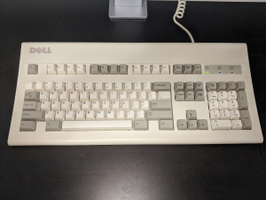

Hey guys, I recently finished my first build. It's a Dell AT101 with white Alps and keycaps from a Lite-on SK-2002 (with the exception of capslock, enter, right shift, right control, and right alt). It's not converted as my desktop supports PS/2 and the original cable is in such good shape that there's no reason to internally or externally convert it.
I personally love this board. I originally started with a regular AT101, that I then restored and linearized. I then swapped to a terminal Model M which I converted internally to USB, and now I'm with this. Unless I find a really good deal, I don't think I'll switch from this any time soon as I really love the sound and the feel (although I actually like the black Alps and buckling springs as much if not maybe a little bit more, in terms of feel anyway).
Anyway, here's a picture:
231079-0
Let me know what you think. Also, as I know some people (myself included) get upset about switch harvesting, the switches didn't come from a good board (lite-on sk-2002 that needed a decent amount of restoration) and I also would've had to buy or build a converter which I wasn't interested in doing.

Did you solder and completely replace the switches, or do a top mod?
Desoldered all 204 switches, resoldered the white Alps. Only took about six hours, though it is annoying because the pins are bent down most of the time.

Agreed, but it was a fairly dirty, fairly boring, and fairly common board.
