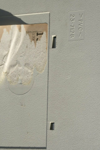

I have a Model M coming my way and I tried to identify it, but the label on the bottom is torn off.
235909-0
What remains of it suggests a serial starting with 138 which, to my limited knowledge, suggests a very early model.

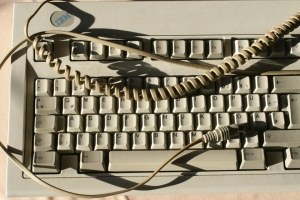

This is contradicted by the top left blue IBM logo
235911-1
which, to my knowledge, came later in the game.

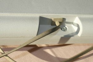

Another noteworthy thing is that the PS/2 cable is fixed
235913-2

It's not a very early model; it is in fact a very late one. It'll have been made in the Lexmark era (presumably by IBM UK). Might just be a really late '1403, may even be a newer part number.

236222-0
Lexmark UK made 1994 is what the sticker on the inside claims.
