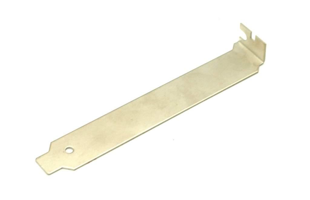

I ruined a fork and it didn't really work for me. so I ended up using a modified computer card slot cover. the narrow end is almost the perfect width and the metal is soft enough that it's easy to work with but not too soft to bend back.

Quote from: Infinite north;197226
I use those to pry off keys.
I tried one (unmodified) to release a Cherry switch housing, but couldn't make it work. I may try bending one later to see if it works better than a paper clip.
