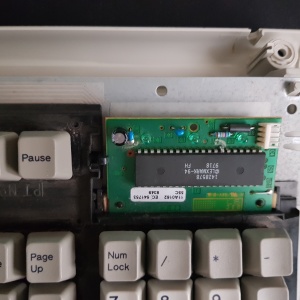

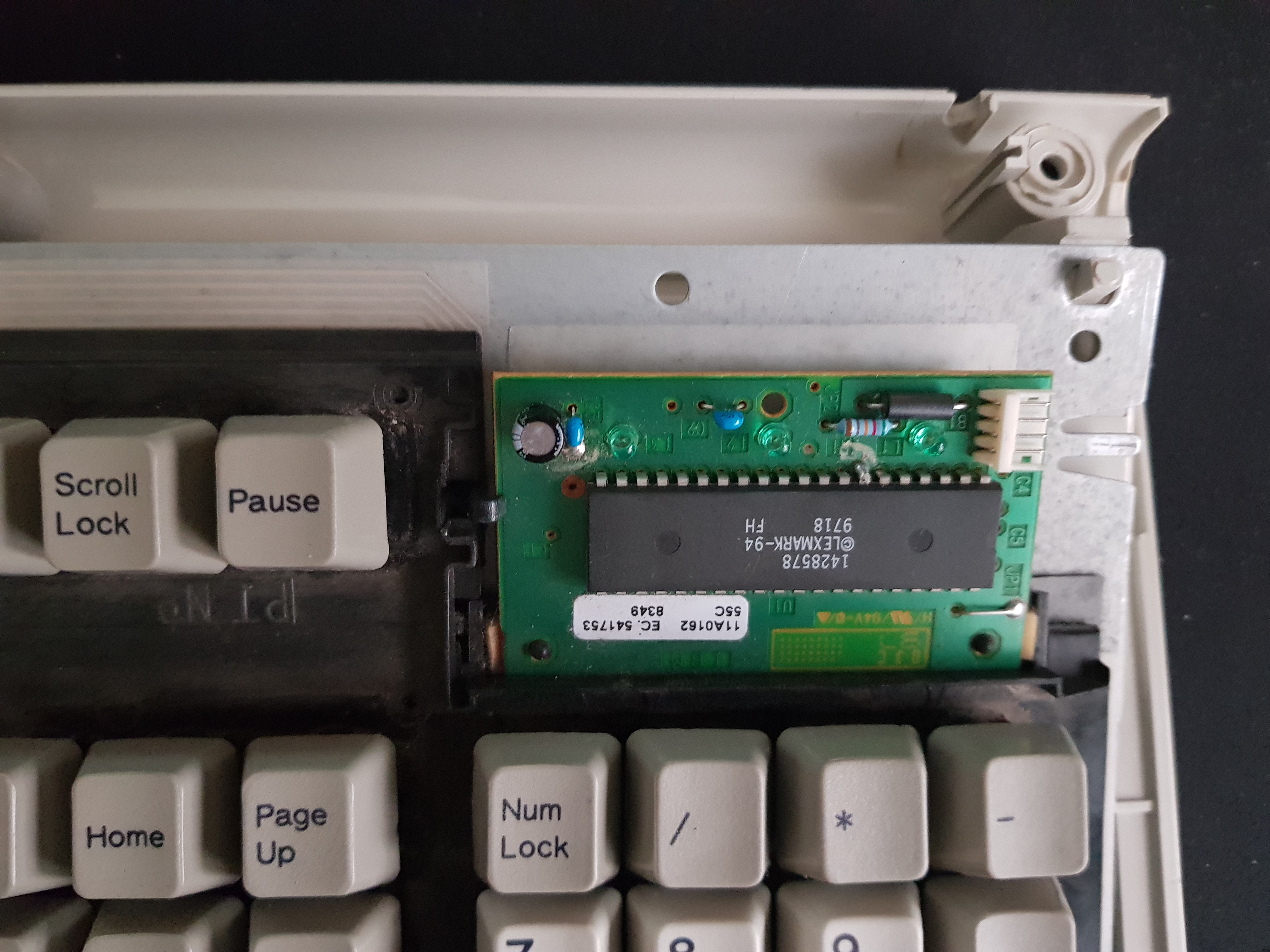

Being that late, and seeing that picture of the controller, that thing must have been made by Unicomp. It looks like you would just bend the clips that hold the controller to lift it out and swap. I found a guide that sort of shows it, but it was made by he who shall not be named. Other threads suggest that the membrane's contacts actually are just pressed against more contacts on the controller by a piece of foam, so nothing more than pressure actually holds them together. I didn't even know Unicomp used such a different controller.
It's still IBM, since from what I read they made them up untill 1999 in the UK, where this was actually made. But yeah, it looks like this generation is what Unicomp based their production on.

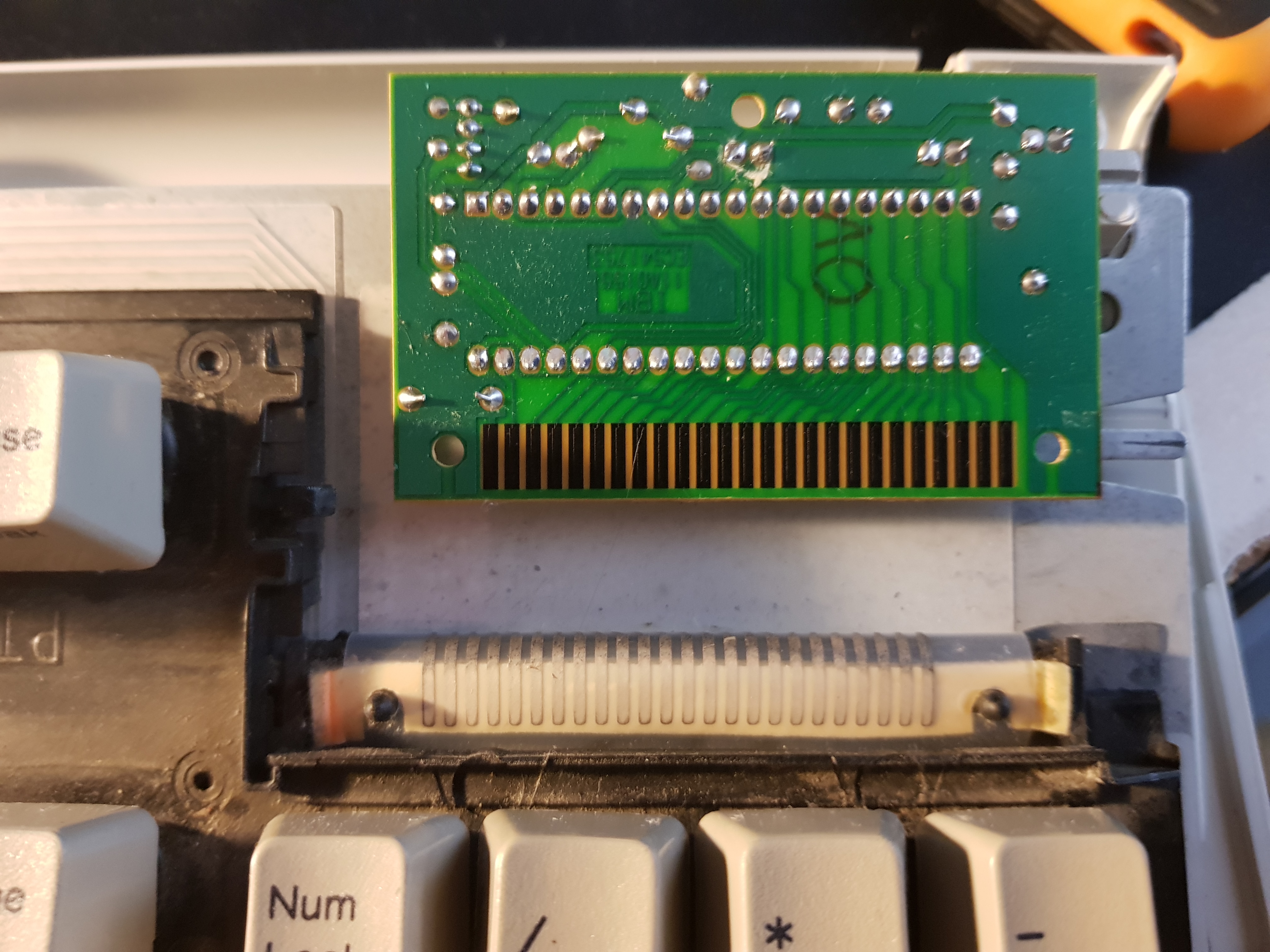

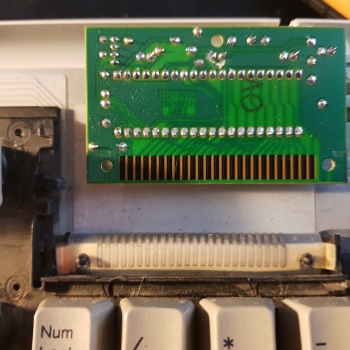

Thanks for the reply. i tugged on the controller after releasing the latch on the left and it came off rather easily. Indeed it seems that the membrane is sandwiched between a piece of foam and the contacts on the back of the pcb.
After I replaced the controller with the known good one it's still not working so it's most likely the membrane at fault. I'm currently contemplating if worth trying to repair, as the traces near the connector look somewhat oxidized and if the break is there I don't expect any fix to last for a significant period of time.
I'll probably end up ordering two membranes from Unicomp, fix up and bolt mod both, sell one of them off to break even if I can.
Before you do that, there's a trick you can try with oxidized contacts. If you've got a pencil eraser around, you can give the contacts a good stiff rub down with it, and it should clean them up nicely. If that's not available, I have even had some luck with isopropyl and some elbow grease.
