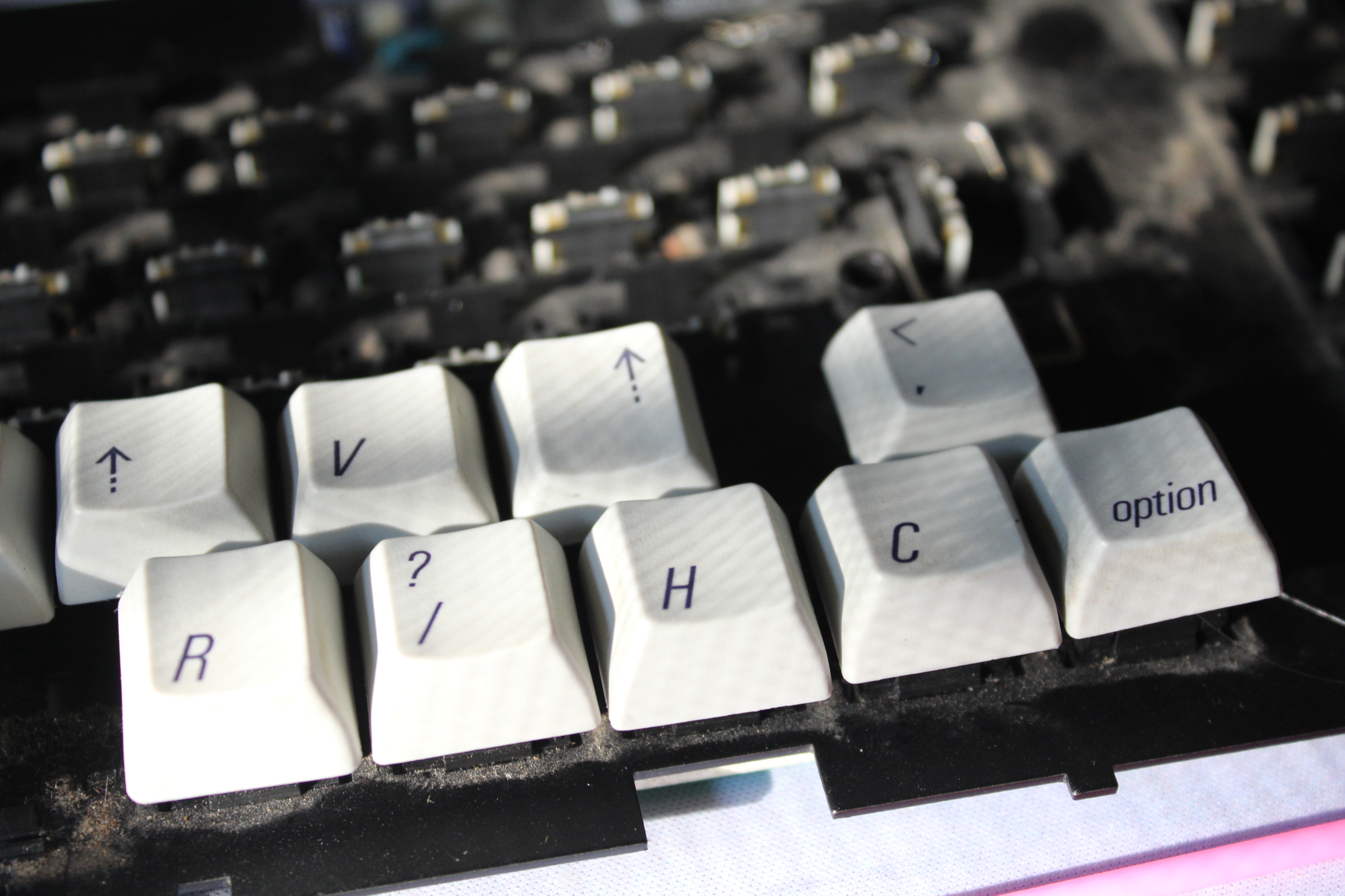

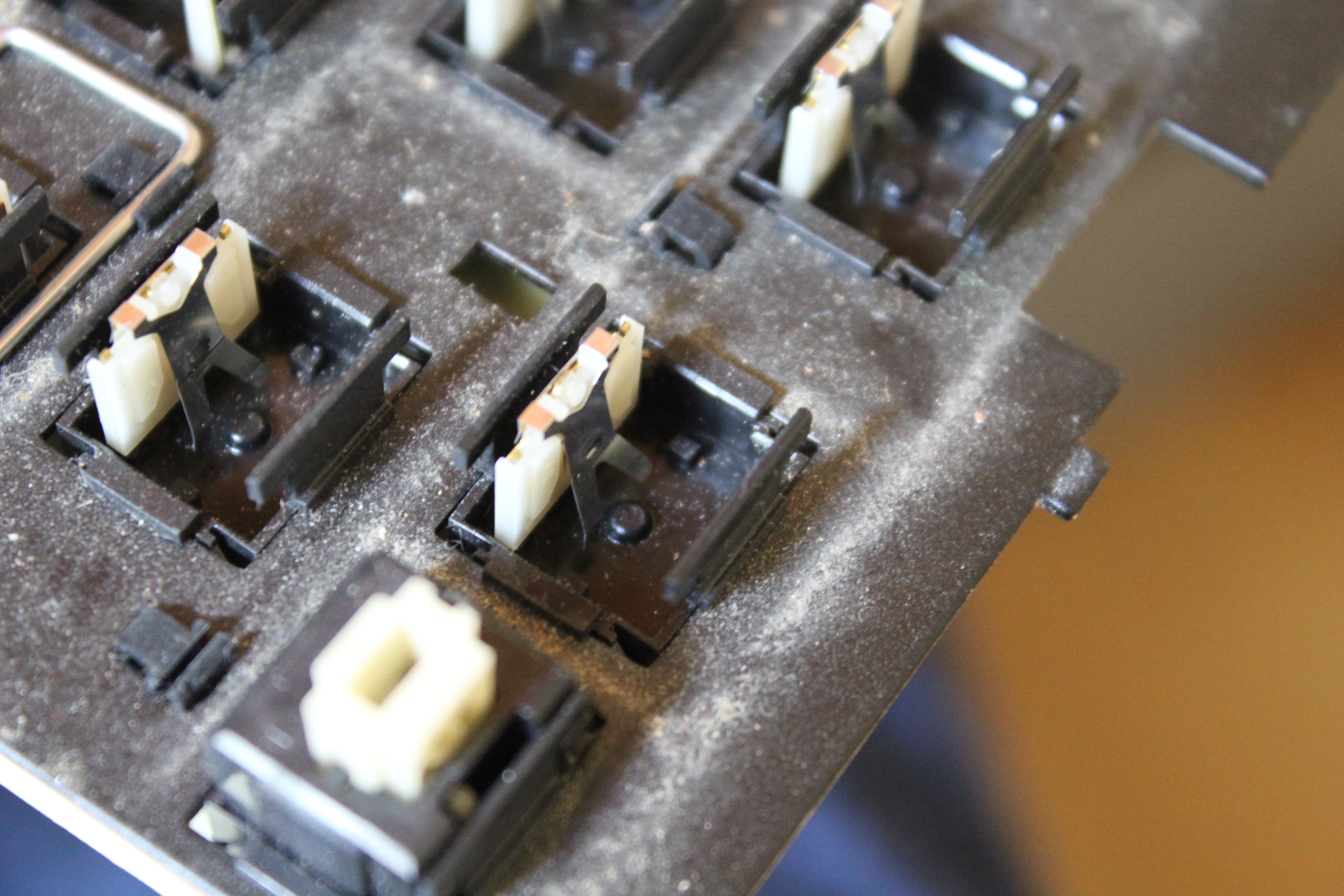

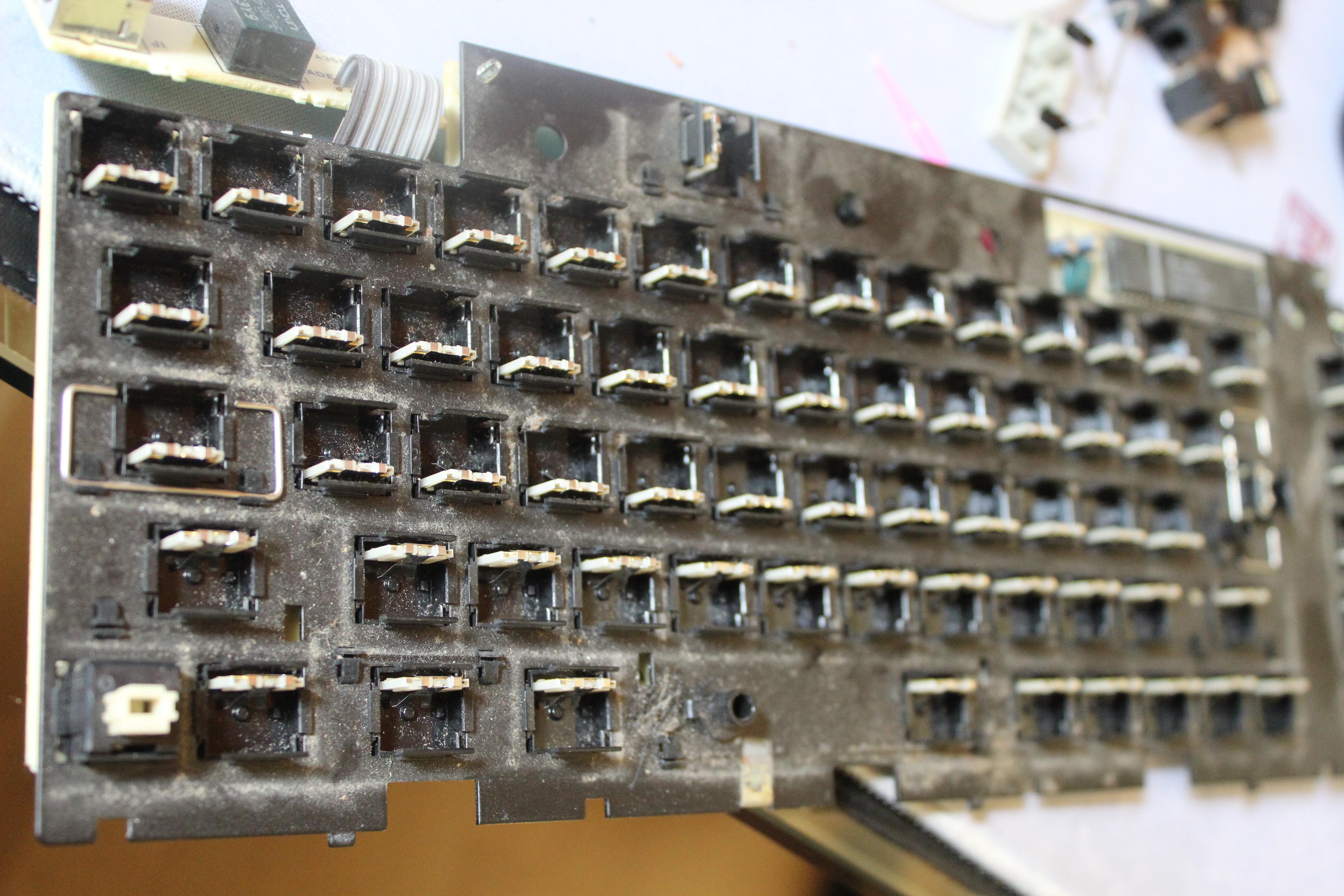

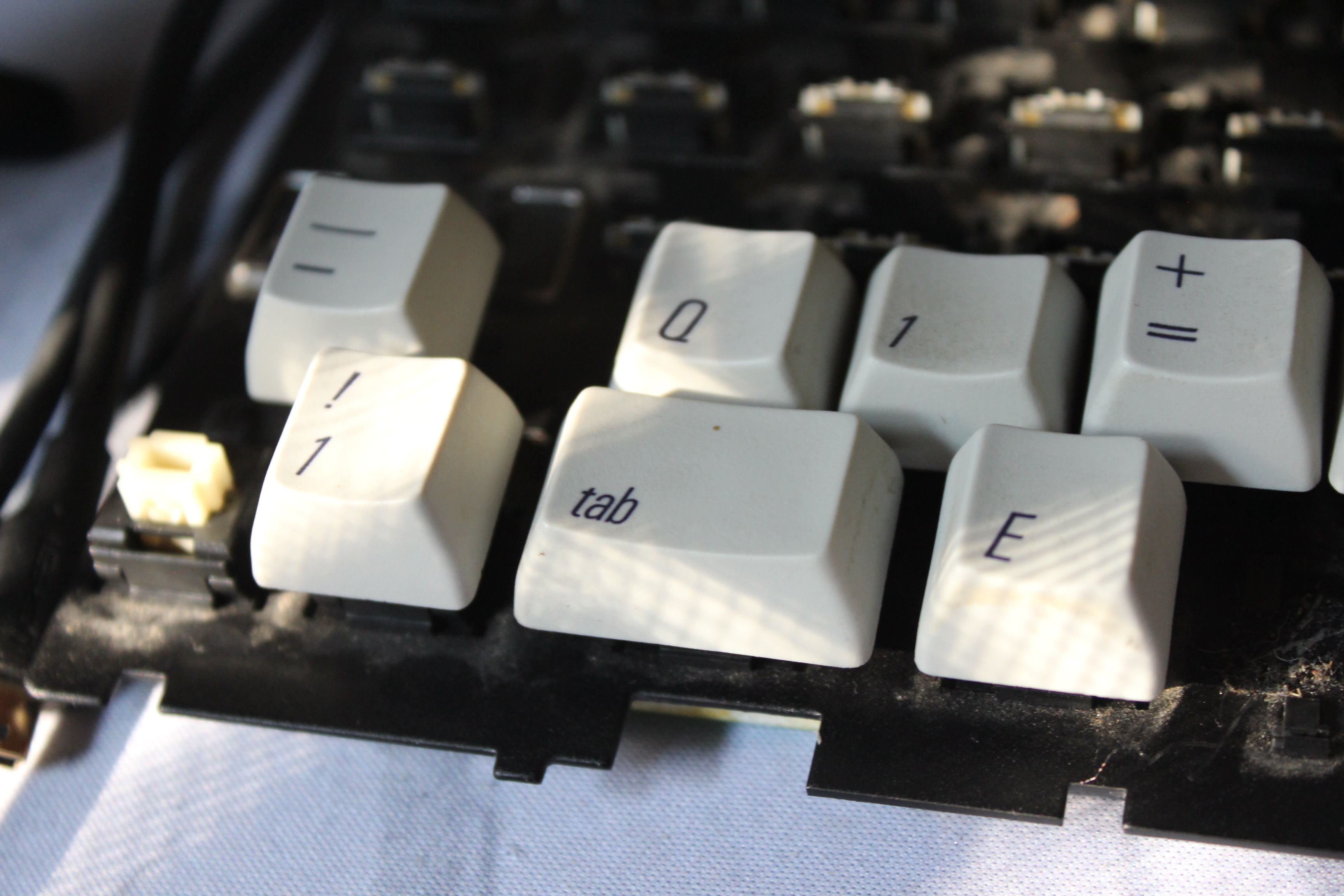

That is before, you can see that the plate is dirty
The original owner told me they were 7.5 /10.
Unfortunately  you can see they are not 7/10 , but tactile Alps are my favorite switch with the exception of Cherry brown, so I wanted to take the time to restore them.

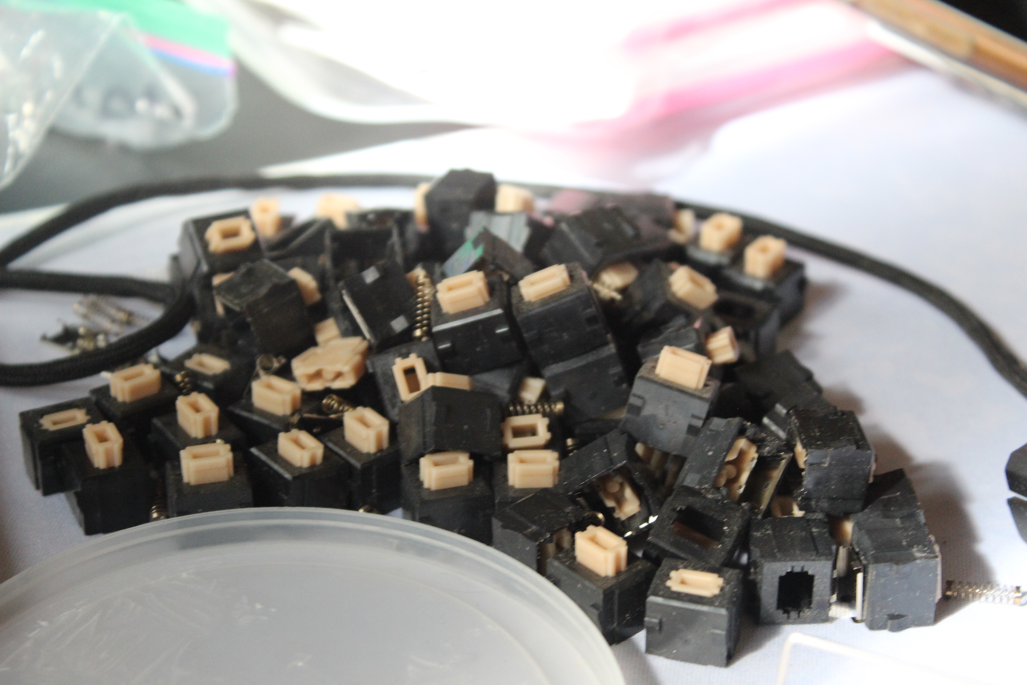

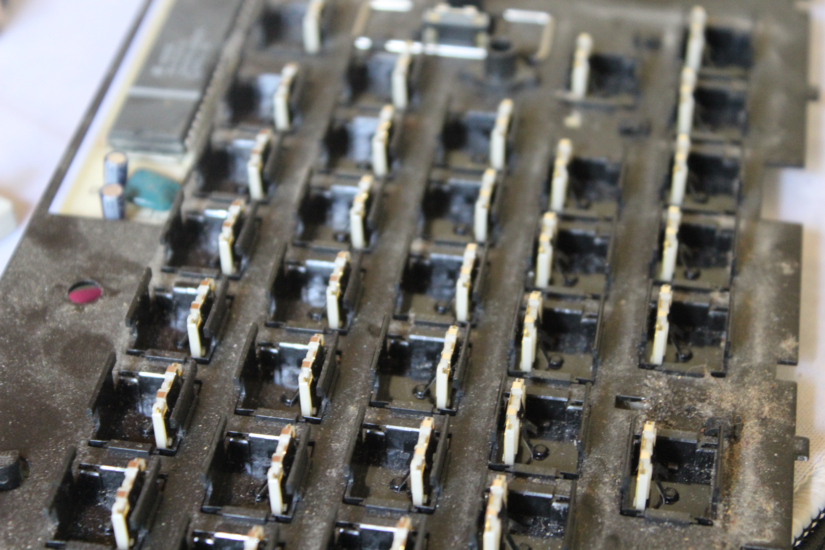

Now I will put pictures and a video of what it sounds like in the middle of  the restoration (without dry lube or ultrasonic clean)
251290-4
251292-5
I put the plastic case in the sun so it would become the original color.   I hope it doesn't smell like smoke, because the air quality is not great outside.
