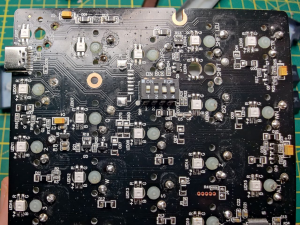

But then i noticed some weird behavior with the top row of keys. ESC would register ESC, TAB, SHIFT, CAPS, CTRL; 1 would register 1,Q,A,Z and so on. I initially thought that the behaviour was caused by the jumper. I desoldered the jumper cable, but the behavior continued. I now suspect that it has something to do with the ESC key, which i completely butchered as well (see pics attached). Is there anything i can do at this point or is this now beyond repair?
Otherwise the board is fully functional. Also lubing the switches did work and gave the board a much nicer sound; but with this strange behavior it probably isn't usable as a regular keyboard anymore  :-[
  • Posts: 4772
Re: Is this fixable?
« Reply #6 on: Fri, 18 November 2022, 10:36:35 »
Wow, did you try to remove the switch using nothing but a screwdriver?!
From what you've described you have a short to the trace that runs along the lower pins on the top row.  The obvious cause would be the loose trace on Esc hitting one of the scratches but doesn't look like the trace has been crushed by the switch, and now the switch is removed it shouldn't be that.  Best to cut/snap the loose trace off as short as possible anyway so it can't do anything.  Does turning RGB off make the top row work properly?  Does it get dimmer when you press a key on the top row, or is Esc always dimmer?  The other option is it's shorted to the ground tab of the USB socket which is also right there, there's a lot of ... flux?  Bubbled solder mask?? around it so try and clean that off.
Reconnecting Esc is no harder than tab (see pic below) but no point connecting it until it works.

Thx for your reply. I snapped the loose trace off. RPG on/off doesn't seem to make any difference. Also tried cleaning up with Isopropanol alcohol. All no changes to the behavior.
What did change it though were those dip-switches. I tried all combinations and those where the results. Maybe you can read something out of that. Also attached a bigger picture of the PCB and the Ducky manual entry about the dip-switches.

I hate black PCBs, can't see anything!  Based on the diode numbers and what little I can make out I think the traces could be as highlighted in the attached which makes it look like the dip switches are wired in with the keys - can you see the yellow and blue ones?

Thanks, that's nice and clear.  I've accused the designers of Ducky boards of being on drugs before half jokingly but whoever designed this one really must have been - why is D81 connected to the A key as well as dip3?!  That surely explains why turning off dip3 stops the top row from pressing that row...  Does shorting these two reds type an A?
293426-0
A pic with the shine the other side of the dip switches would be great too, showing as many switches as possible please.  So much mess over there I'm not expecting to see much but this is so weird I really want to work it out

jep, shorting the two reds types an A.
For row 1 to clone row 3 however (1 typing A, 2 typing S, 3 typing D,...) dip3 needs to be on (XOXO//1=on;2=off;3=on;4=off).
If you need more pictures, let me know :thumb:

Can I get a picture of the whole back of the boar?  If you can somehow get lots of shine on it to see the traces that would be great but it's very hard with a black PCB.
Also you never explained the parallel scratches next to Esc, they don't look to have cut any traces but could there be more of them?

Still can't get my head round this.
If there's a short it should type 1 and Q (or A, or Z) when a given dip is ON, but how do you short to all the rows without shorting them to each other?  On the other side if there's a break it should never be able to type the broken row, but if you turn all the dips ON it can.
Lets fix Escape and see if that helps.  First reconnect the diode with a jumper from blue to orange as that's not in doubt.  I think Esc is connected to shift so touching purple to orange should type an Esc - if it does solder a jumper from purple to pink.
It's possible purple is not right and that trace instead heads directly to the controller chip so if this doesn't work we'll have to start poking that.  I can't make out the sideways text on my < HD monitor so please type out everything on the square NUVOTON chip and hopefully we can find a datasheet for it.

Turning all switches ON turnes the first row (ESC, 1, 2, 3,...) off completely though - does this make a difference for your thought process?
Just touching purple to orange types left-shift. I didn't solder blue to orange yet. Would this be needed for it to work?
Printing on the Nuvoton Chip is M032SE3AE 2921B074-ZW2 003GAFB
