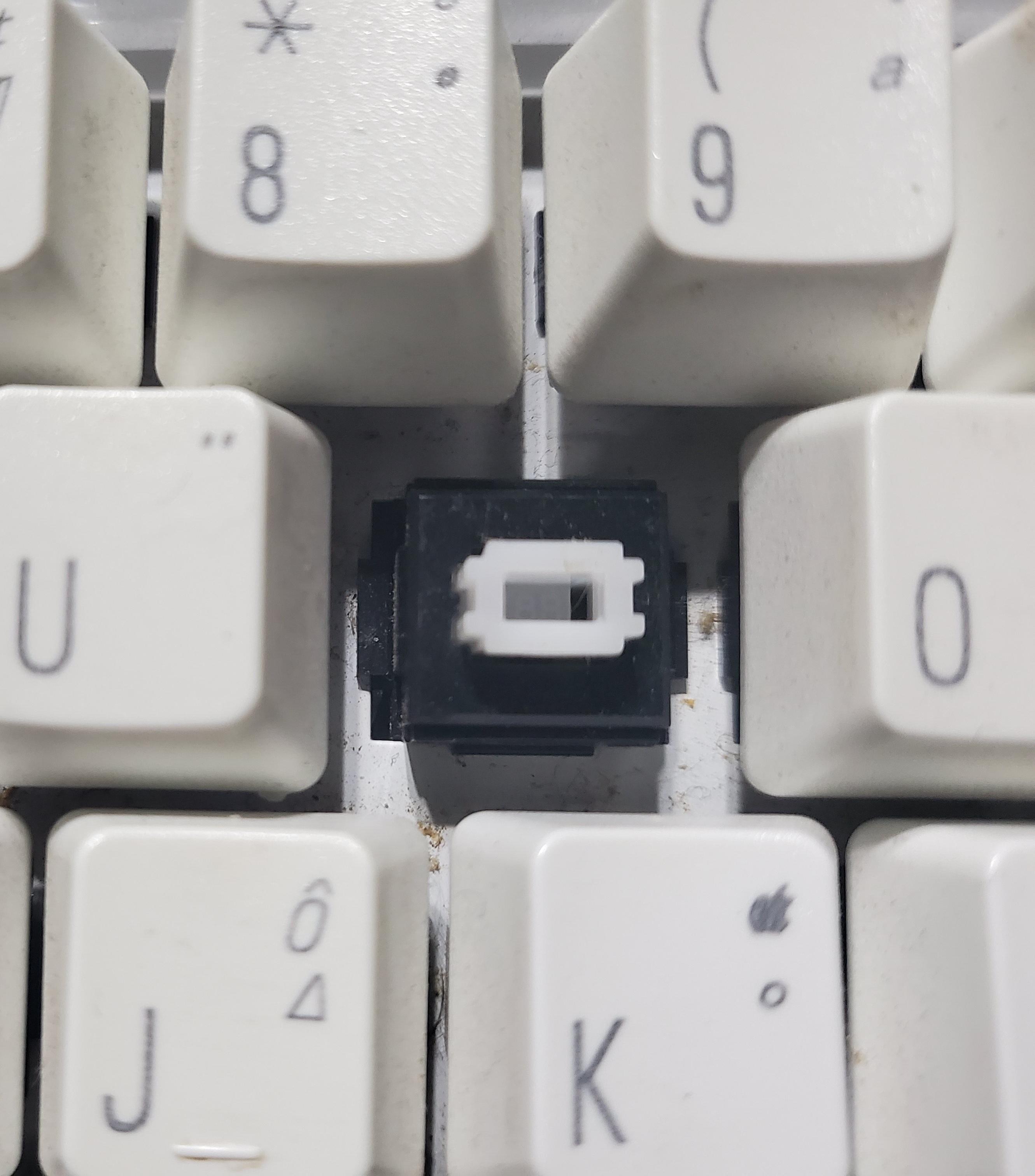

Now, right off of the bat, we can eliminate excess lube as a (primary) cause for chatter. I opened one of the switches to verify that it was bone dry inside, just in case the board had been modified. What of the other popular myths?

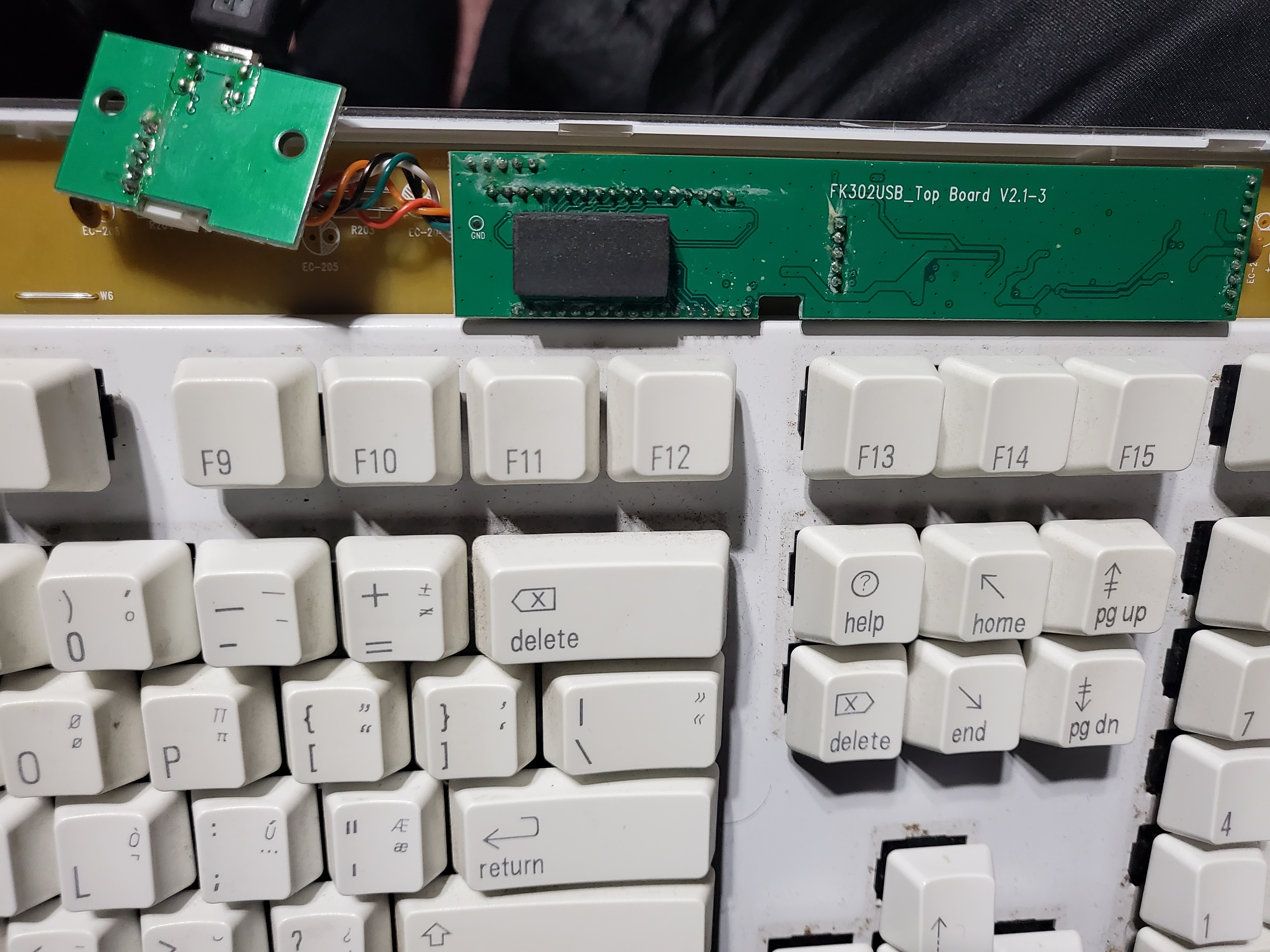

I took the board apart and found that the controllers in even the oldest Tactile Pros are easily replaceable like the mini variants, although these ones do not have a helpful table printed on them to show you pads to solder resistors to to change the mapping based on location and/or operating system:
295422-1
295424-2

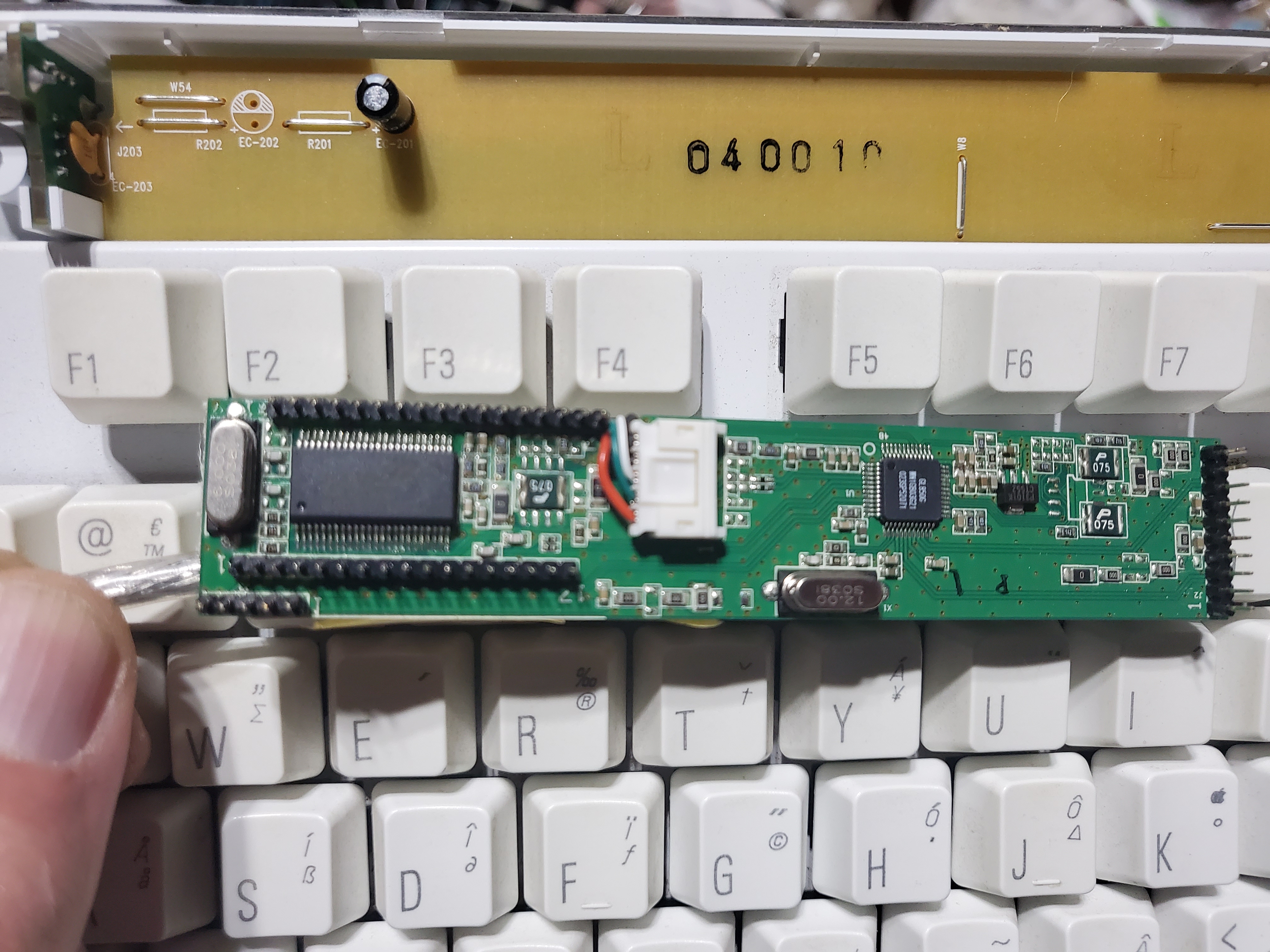

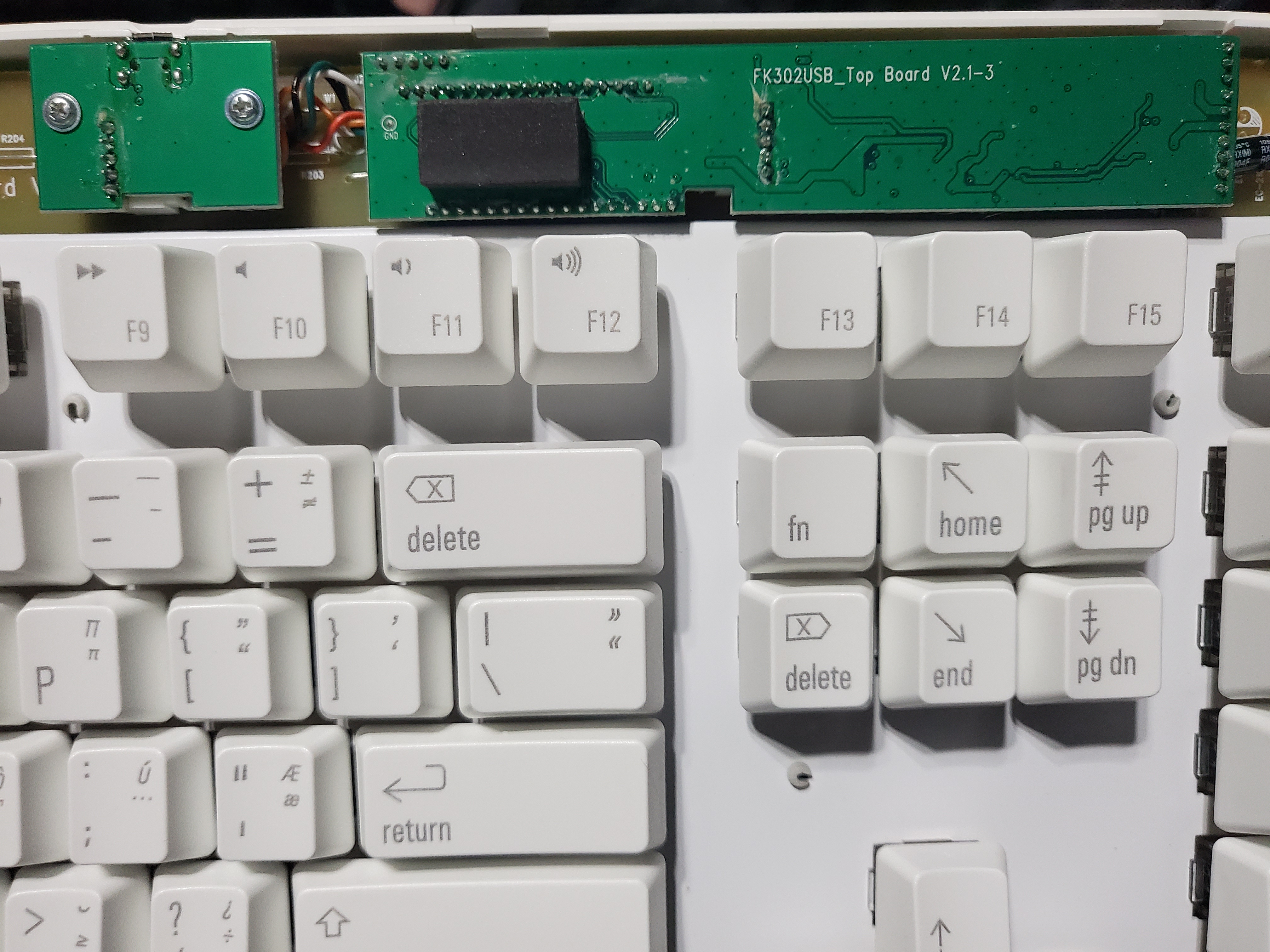

I also picked up, at some point, a used Tactile Pro 4. I have no idea how much use the board has, but the caps look pretty much new. These boards have controllers with small daughter boards for their micro USB connectors, but the pin layout for the controller matches:
295426-3
295428-4
Note that, at least in this example, there's no strap (in Matias' case a big hunk of plastic) to reinforce the connector. I have no idea if this has been amended since whenever this Tactile Pro 4 was made, but if not this is another point in favor of the newer mini variants of these boards, besides being able to easily change the mapping with resistors.

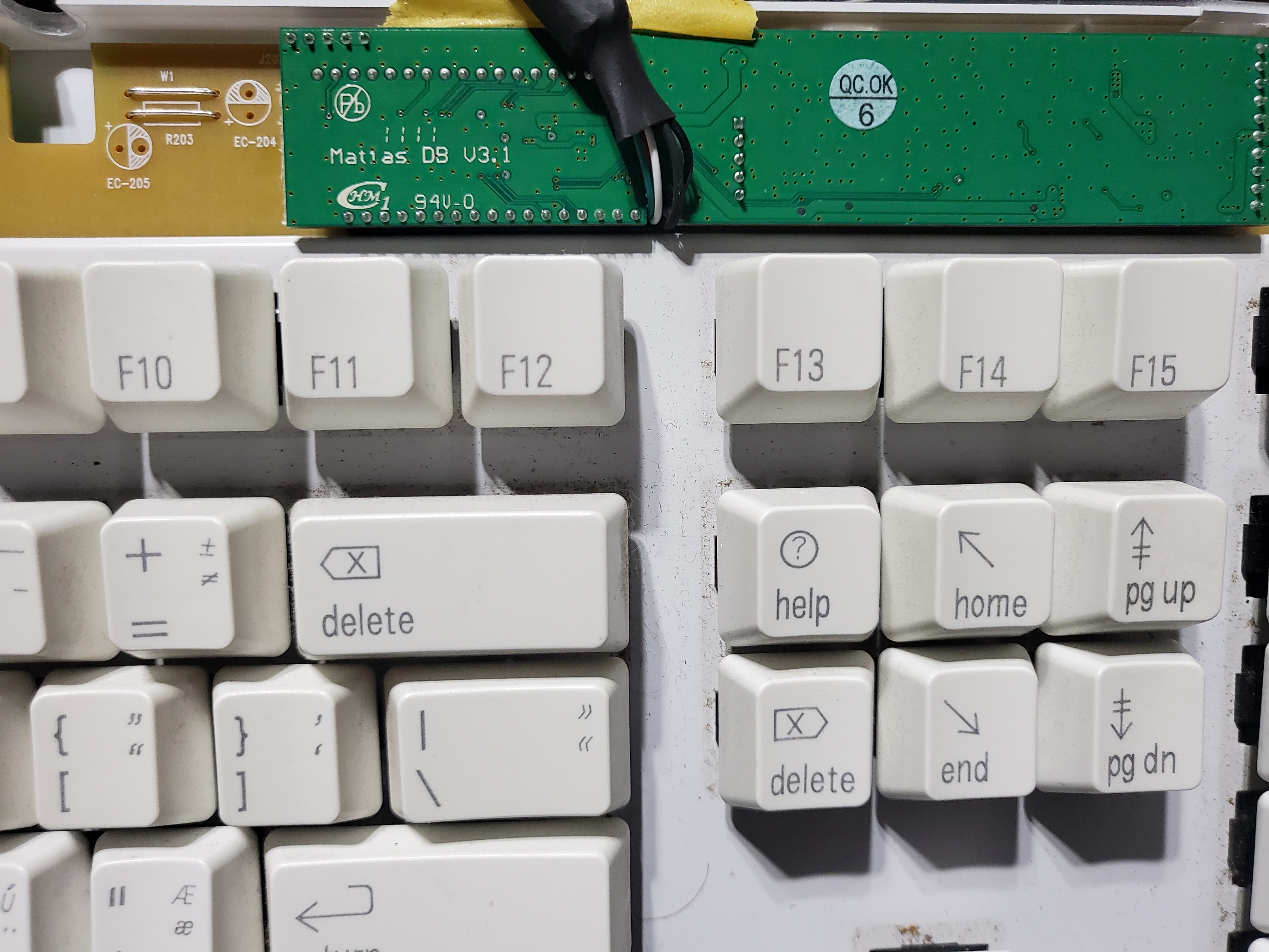

Now, are these controllers 100% electrically compatible? I have no idea. I swapped them in the name of science anyway, as that means I could potentially test and see if the newer firmware helped with chatter on the otherwise totally original board:
295430-5
What I found was interesting. With the newer controller, chatter was instantly greatly reduced and as I repeatedly pressed each key, it was slowly eliminated entirely for that key. The letter n, in particular, would not register at all for the first 10 or so presses. Then it began to chatter, gradually the chatter was eliminated entirely as I continued to press it. Now, it is at the point where I am typing this entire post with that same keyboard that was totally unusable with the original controller.

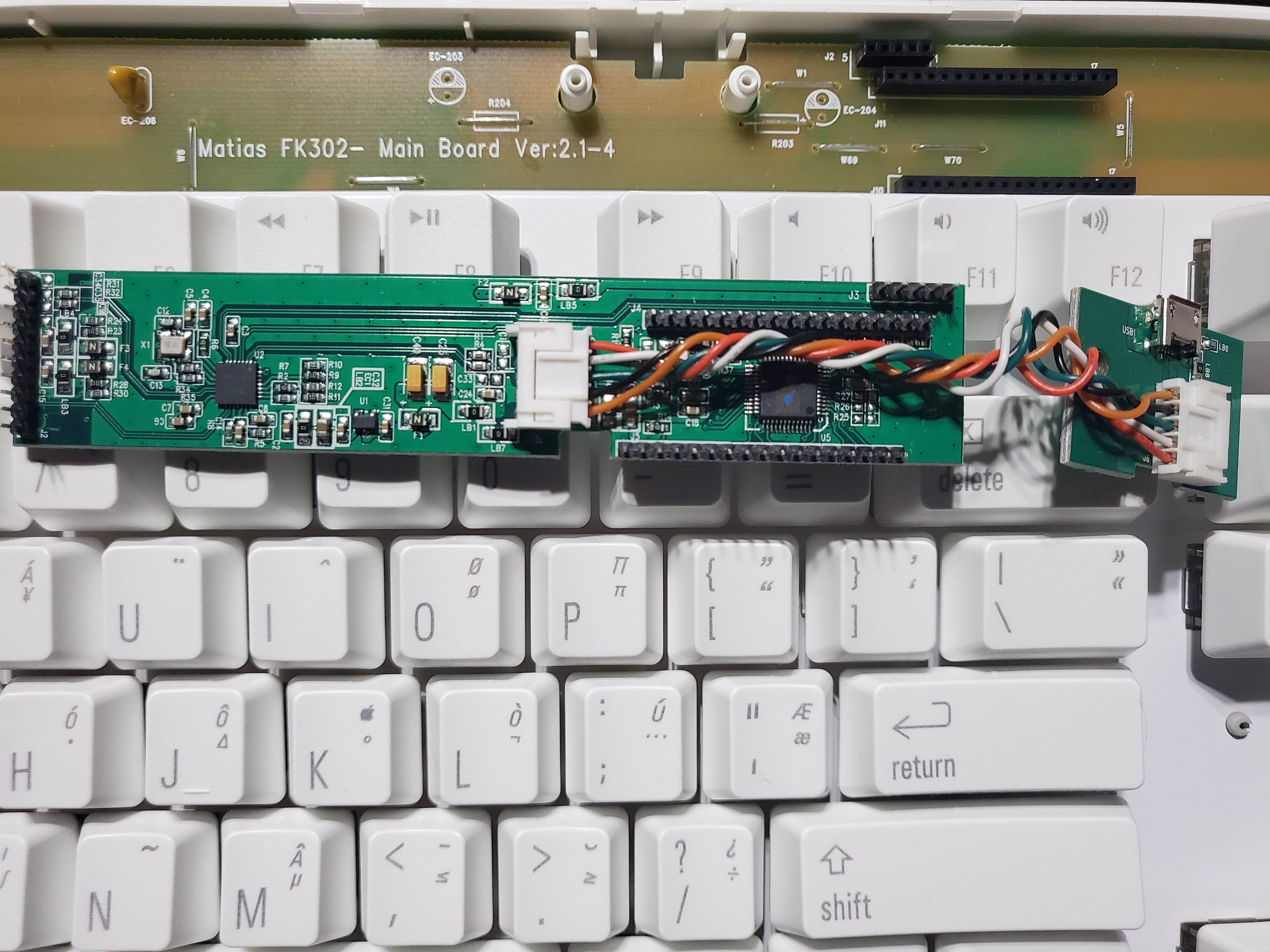

With the help of a DT user's pictures (they keep changing their display name on the Discord or I would drop a username) of their discontinued PC version of a Tactile Pro I also determined that the Tactile Pro 4 boards can be converted to other mappings similarly to the mini variants, which I documented in another post on here some time ago. The controllers on the full size boards don't give you a nice table saying exactly how like the mini boards, unfortunately, so I have no idea what combinations are needed for anything other than US PC. For that, all that's necessary is bridging the pads marked R26 (I should really make one thread that covers all of this stuff at some point, maybe if I learn more).
