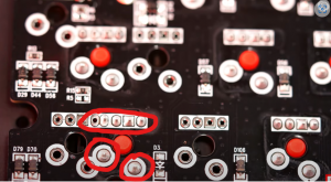

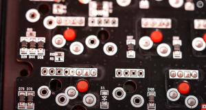

What the PCB supposedly looks like: https://imgur.com/a/H3iu7oK
299165-0
299167-1
The main concern I have is the fact that the LEDs are supposed to be desoldered as well with the switches in order to remove the switch. Is this necessary, or can I keep them there? If I do desolder the LEDs, is it as easy to put them back on as the switches, or does it get complicated from there? Do they have pins like the switch does?

I would not even try to desolder this board. Those RGB leds are going to be a pain in the ass. From what i can tell in order to remove the switch you will also need to desolder the leds. No fun times even for a experienced guy
I see, it would definitely take a lot longer than usual to go through the process. The main reason for trying to finally mod my keyboard is because my w key for some reason has some kind of bad spring or tactile feel to it, it doesn't compress or decompress smoothly at certain angles.
I'm not really planning on getting a custom keyboard anytime soon, so I was hoping this keyboard would work out but of course being made from the factory it was prone to have some issues without proper lubrication, so I wanted to look into soldering to fix it.
Do you also know if the desoldering/soldering process for LEDs is the same process as the switch pins? Do the LEDs have some kind of pin or protrusion for you to touch with the iron and the pad, or is it not like that?
My advice is just don't do it. If it was SMD RGB then it was just the switches then mod away, but trust me you don't want to mess with those LEDs. Unless you want a board that has broken RGB.
