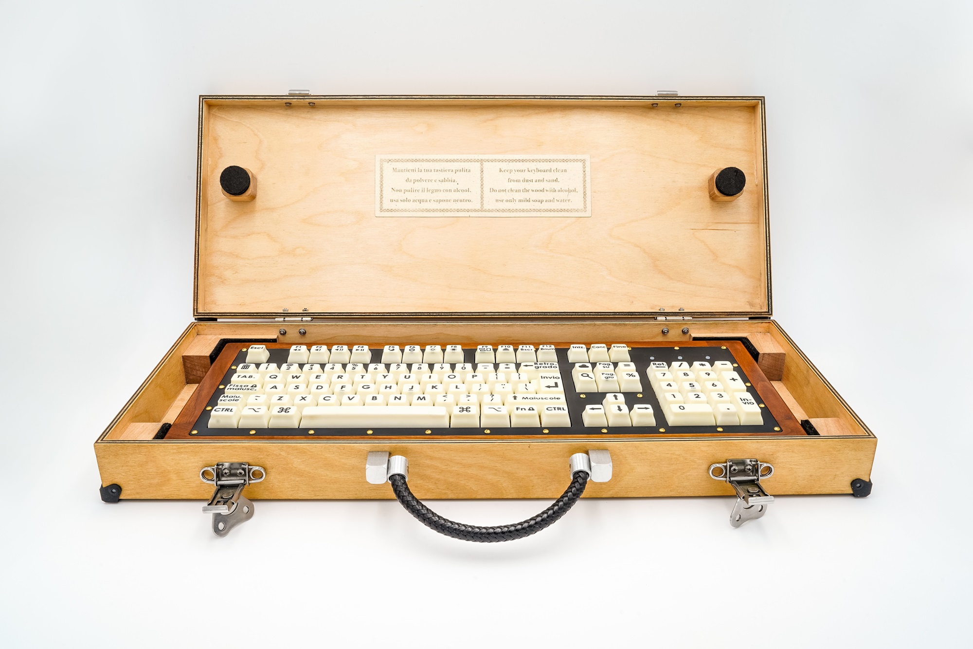

A high-quality keyboard must have a high-quality suitcase. Unfortunately this is not always true, I have seen many videos of embarrassing unboxings of really expensive keyboards. Producers usually use suitcases in which you can cut out the padding, or other types of commercial solutions. They often stop the keyboard inside the case with plastic padding or worse: pluriballs. The unboxing video of the $3500 Tfue keyboard (which is about the price of a Vescovo keyboard) made me think a lot. Does it seem acceptable that when he opens the case the first thing that is found is a plastic padding as in a television or in a vacuum cleaner unboxing? It's crazy! So maybe customers are losing the culture of the well made luxury, which in the past had very specific rules. Today it seems that "luxury" is only because it is expensive.
I don't agree with this trend. My luck is that I've been working on antique typewriters for more than 10 years, which were very expensive and well made products, in this way I learned how a luxury mechanical product should be made, and also its suitcase. So I made it to the highest quality that was possible, creating the handcrafted suitcase which you can see in the photos below, according to the classic concept of suitcases used for musical instruments and typewriters.
I'm pretty sure that no mechanical keyboard in the world has ever had such a prestigious handcrafted suitcase.
304975-0
304977-1
304979-2
Positioning security is held by felts, which the two of the top press down the keyboard (2mm) when closing the suitcase. This closure is carried out with two stainless steel butterfly mechanisms. The special corners are each fixed with three small shoe blue steel nails, the 4 rear corner integrate 4 aluminum feet which allow the suitcase to be vertically supported. The horizontal support on the table (opening position) it is entrusted to 4 round felts. The Vescovo logo is laser engraved, the finish of the wood is done first with oil and then a few coats of natural shellac pad applied. The keyboard is perfectly protected by this suitcase and nothing more is needed: when the customer unboxes, it will find the keyboard in all its beauty in front of them.

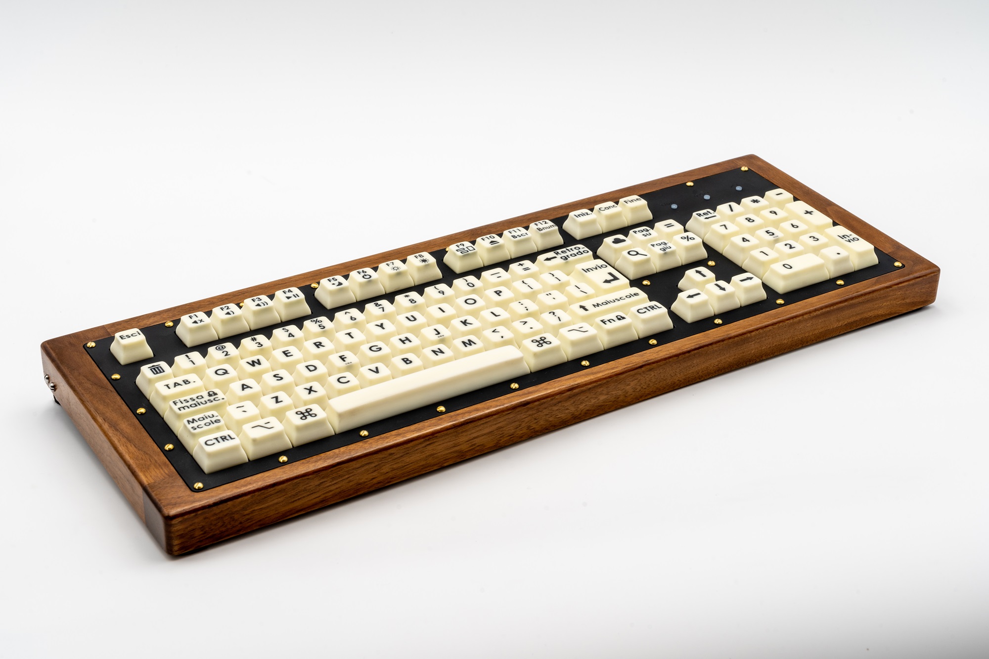

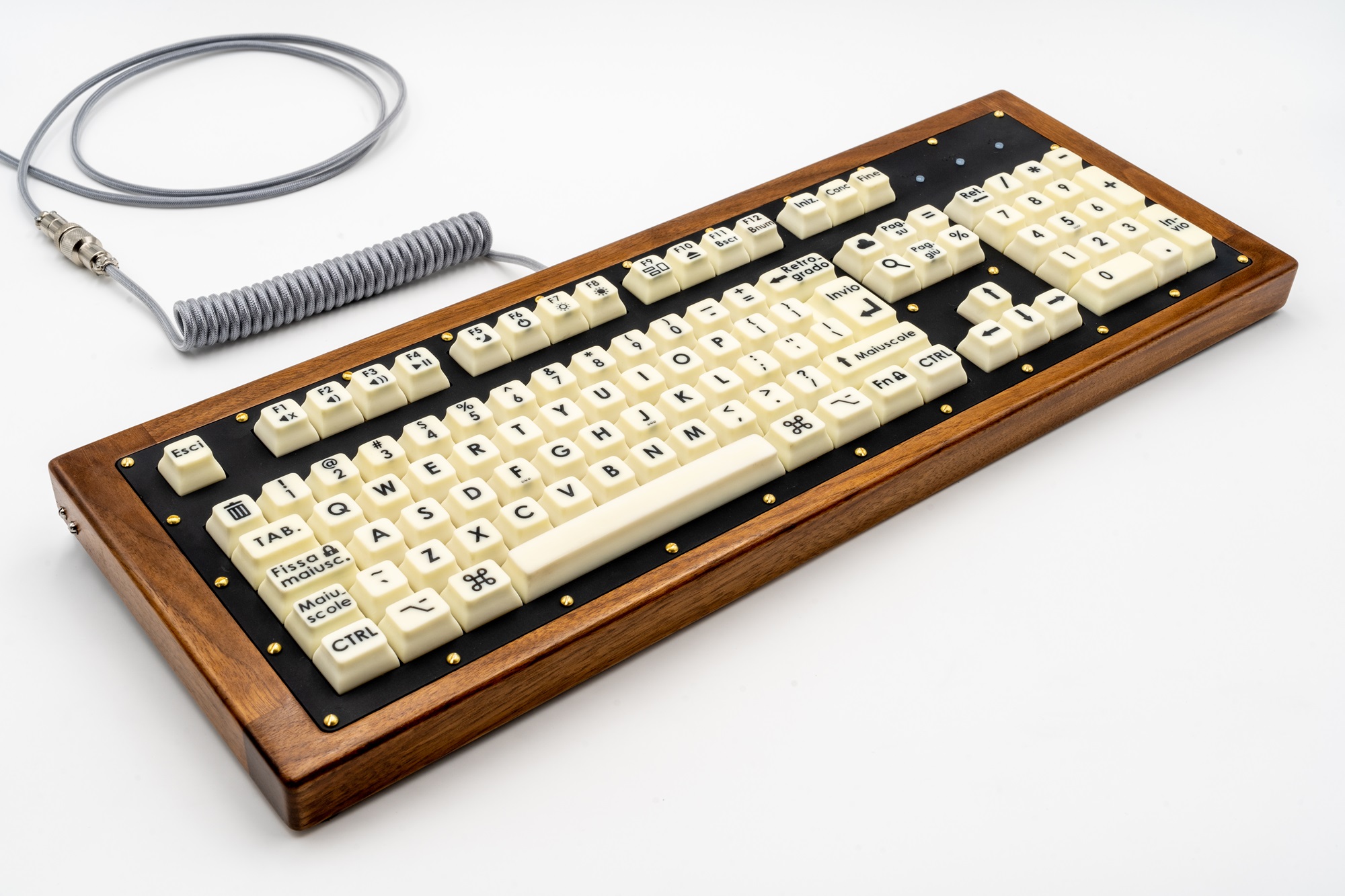

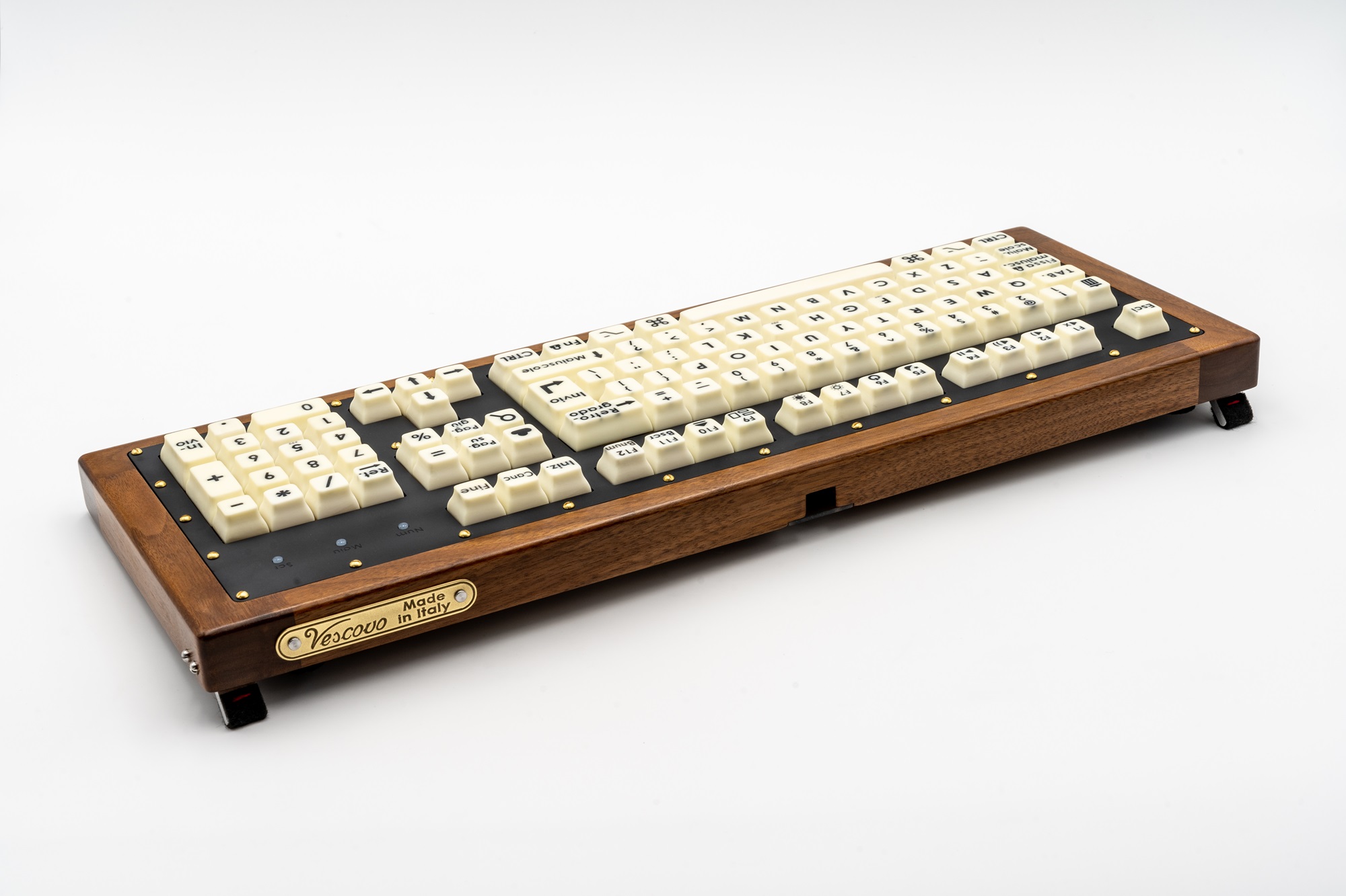

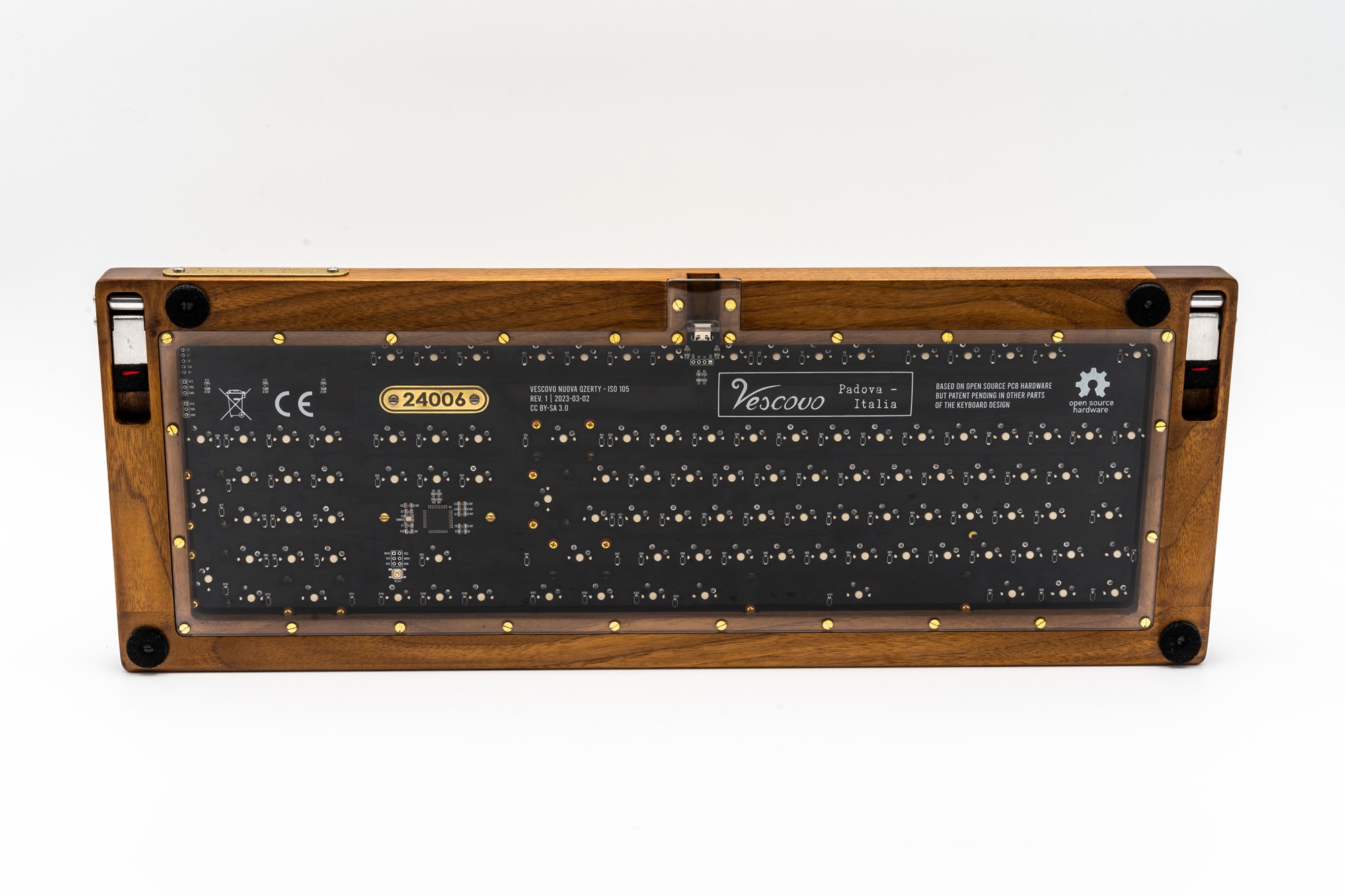

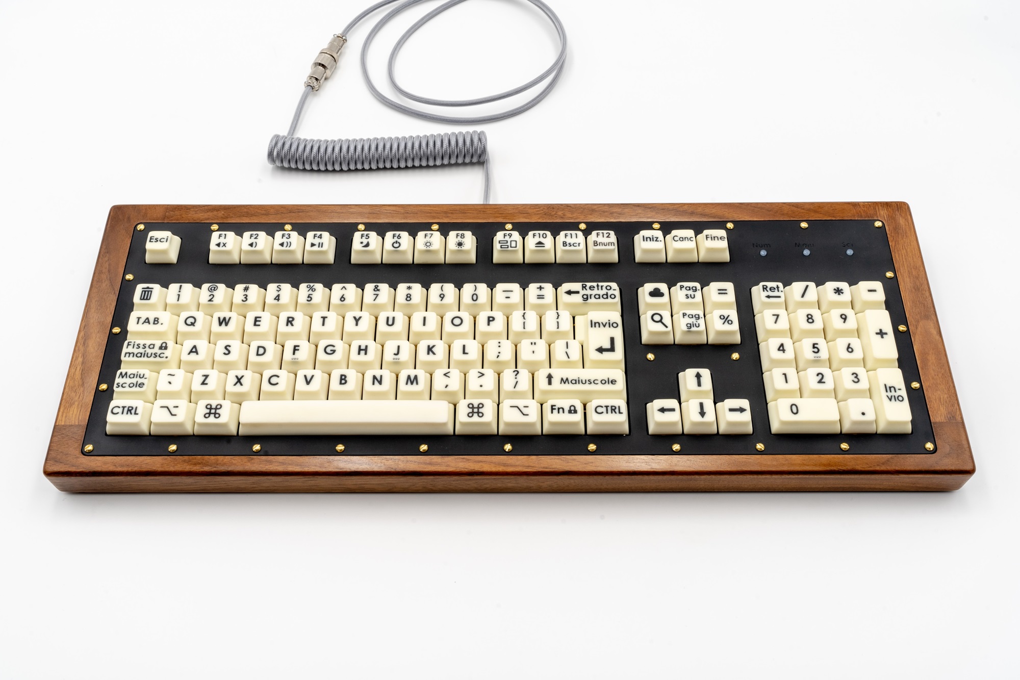

As you may have read earlier, this product was originally created to provide a professional keyboard with a special layout for the Italian language to my clients who write for jobs (lawyers, notaries, writers) who come to my workshop for the restoration of their vintage typewriters. All the keyboards sold so far have been within this context.
However, I decided to conduct an experiment... You can see in the photos the first Vescovo-branded mechanical keyboard with a US International layout (ISO mounted). It wasn’t commissioned by anyone; I made it to test the market and see if there is interest not only in Italy but also abroad.
The exact combination of finishes used for the model shown in the photo is as follows:
- Base: American Walnut wood.
- Insert: Matte black anodized aluminum.
- Switches: Novelkeys-Kalih (linear, self-lubricating POM, 55cN actuation force).
- Layout: US International.
- Compatibility: MacOS.
Warranty: 5 years (valid only within the EU).
Unique serial number: 24006.
Retail price: €3200.
Shipping in EU: Free DHL Express shipping to all EU countries (excluding overseas territories).
Shipping outside EU: DHL Express rates to Switzerland, United Kingdom, USA, Canada: €80. To the United Arab Emirates, China, Japan: €120. Other states calculated on request.
In the near future, I plan to sell it on an e-commerce platform (I’m considering eBay).
I’ve posted it here as a preview; if anyone in the community is interested, can contact me via personal message.
