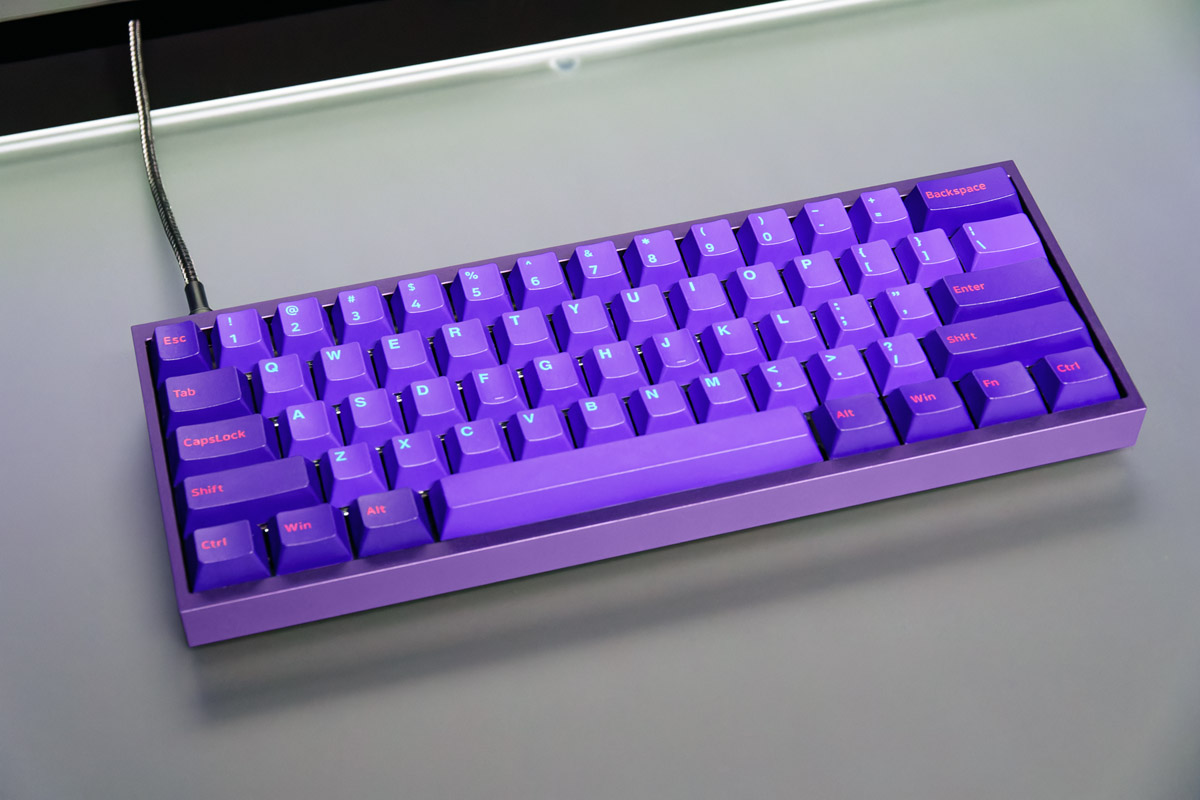

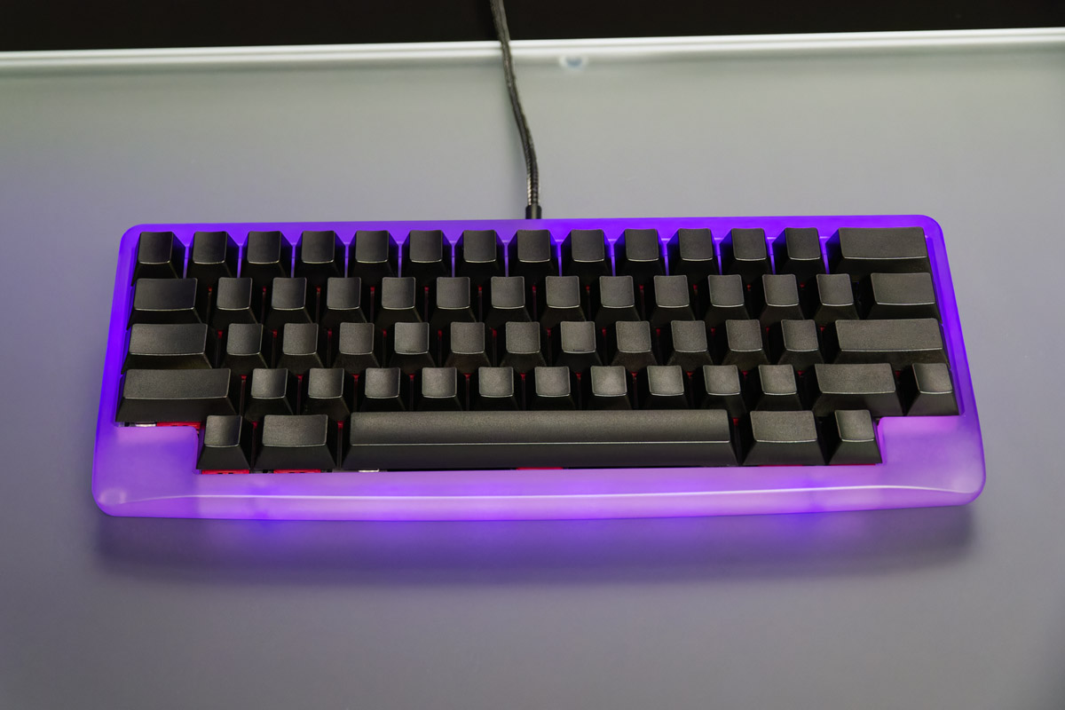

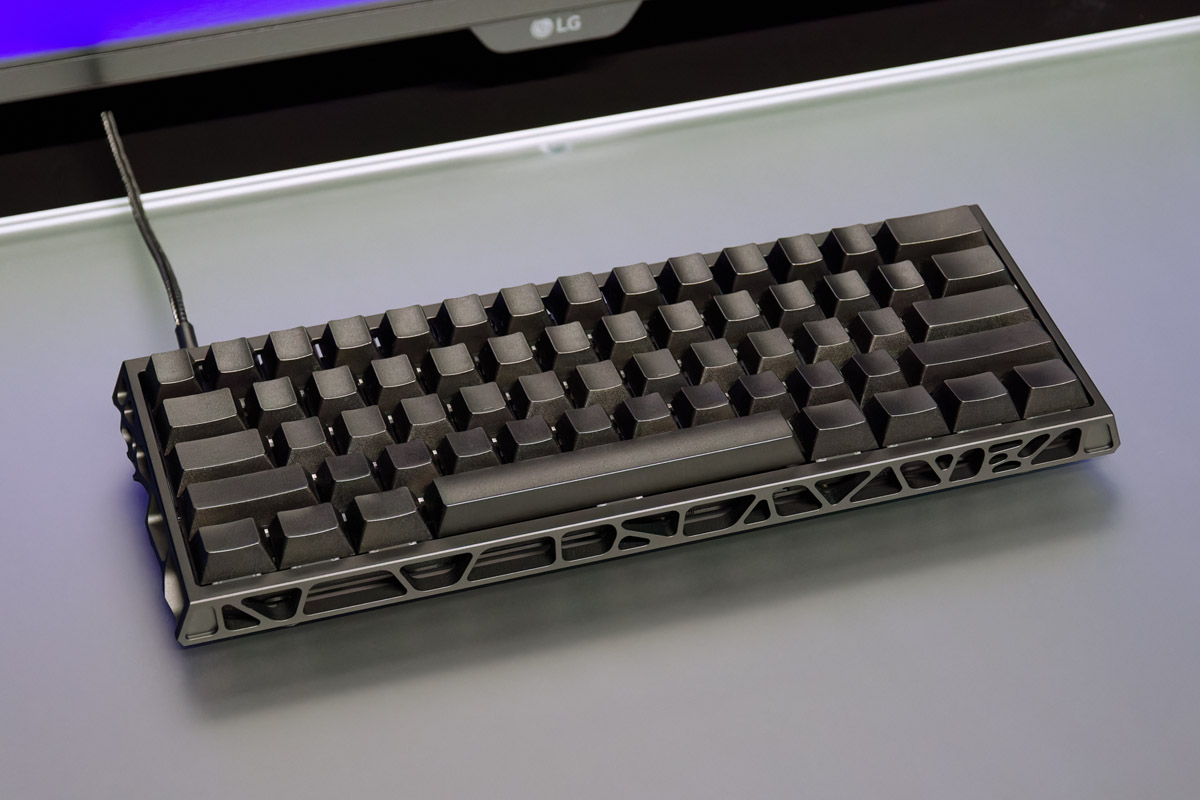

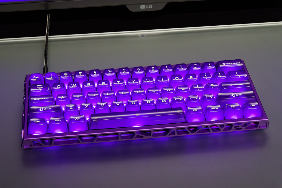

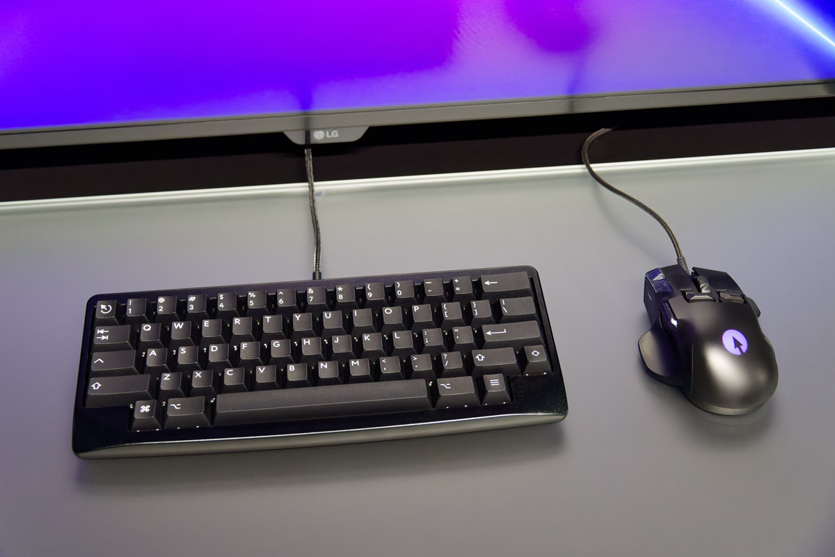

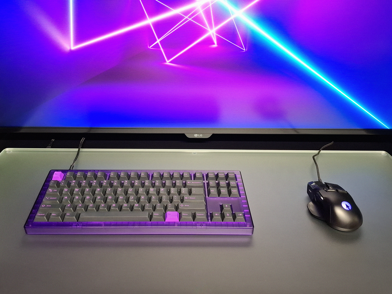

Some of the boards used:
316580-0
316582-1
316584-2
316586-3
316588-4
316600-5
I did extended typing sessions, ****posting on social-media, and mixed in some casual gaming, to get more familiar with the switches.
Most switches were tested in stock configuration, but on some I did spring swaps (usually 3-5g up or down) for reasons I will mention later.

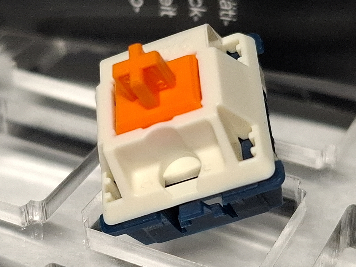

1. Early Excitement – Boxes of Kailh Box Switches
The hunt launched with multiple Kailh Box switches that immediately demonstrated how much things changed over the past 10+ years.
The Box stem design greatly reduced wobble, and also reduces the chance of dirt getting into the switch.
The "switch inside a switch" design (as the switching mechanism is in a box in the bottom of the switch housing...) adds further protection.
From a engerneering standpoint, a clear improvement.
Okay... but do they feel good?
Well... they feel different, and they don't feel bad.
Two out of the dozen I tried ended up in my final testing.
The Kailh Box Royal delivered a nice, strong tactile bump.
They also had a slight pseudo-click character that could resonate depending on the board and keycaps.
Good in focused typing sessions, but not that great for gaming sessions. Nice, but not like my Zealios V2.

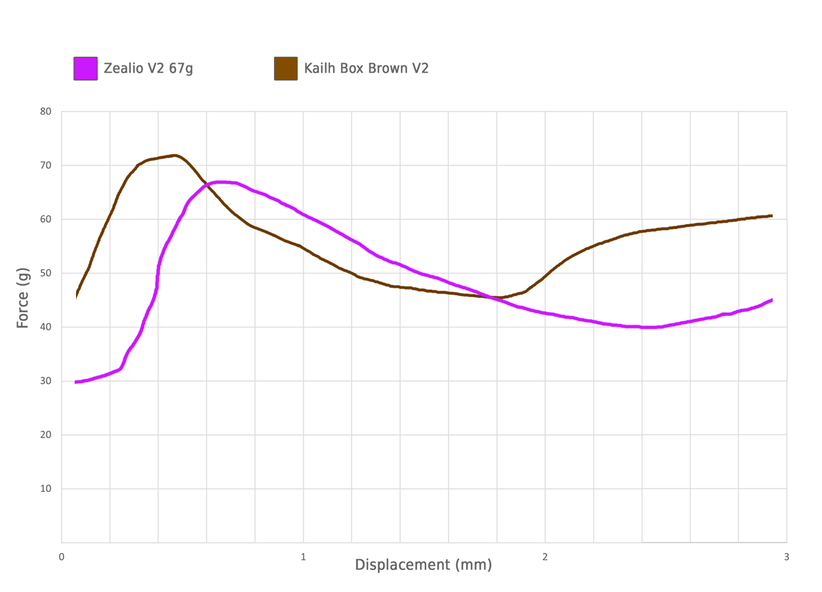

The Kailh Box Brown V2 had a much sharper bump than the Royals.
Even crispier than my beloved Zealios V2. Along with the reduced wobble and improved switch design, a possible alternative.
They felt nicely balanced for both typing and gaming (less exhausting than the Royal). They ultimately ended up in my favorites-list.
Force-Plot showing the sharp bump of the Box Brown V2:
316596-6
Both switches served as excellent early benchmarks and properly reignited my enthusiasm for the hobby.

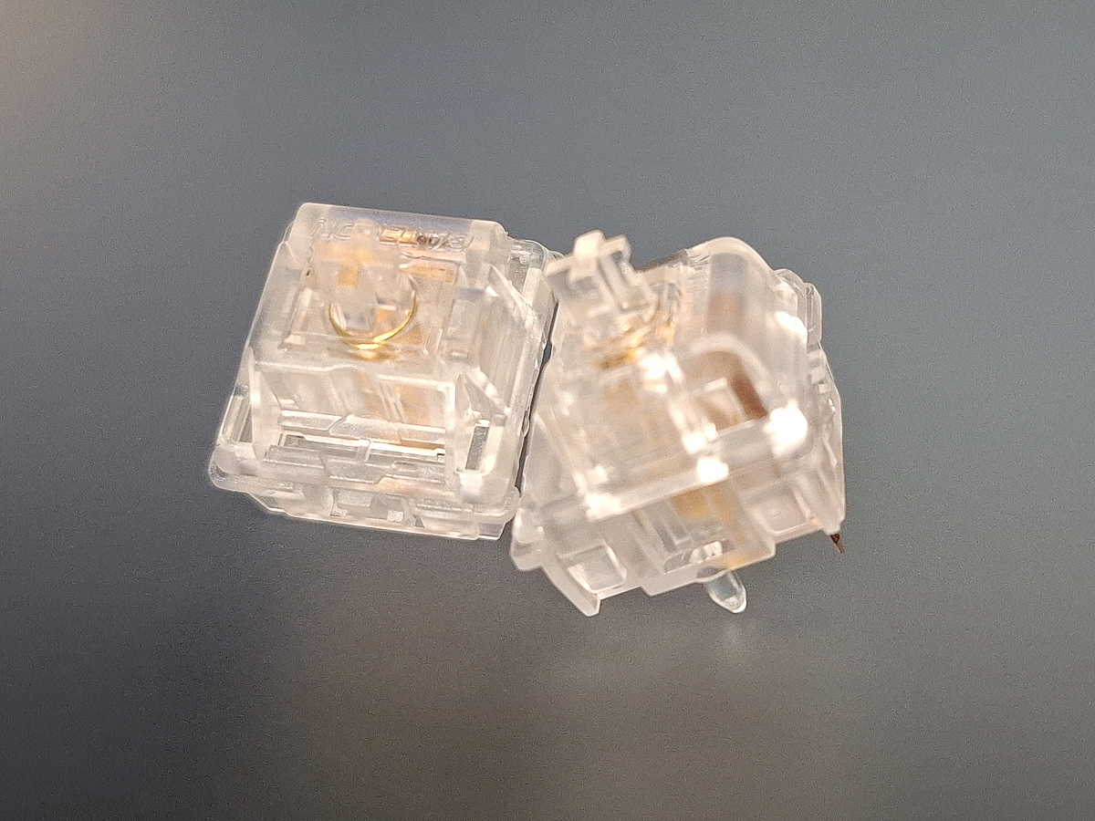

The Zeal Crystal (which I mentioned before), which were marketed as V2 with more pronounced bump, seemed nice on paper.
In practice, they felt too sticky in stock config. Spring adjustments helped. But they never elevated above the regular Zealios V2.
316590-7

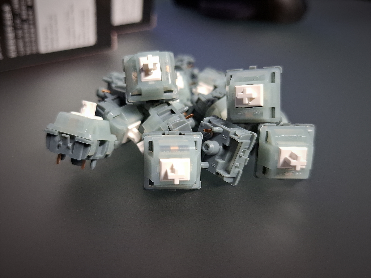

The Gateron Grayish were an immediate standout.
It features a medium-heavy tactility with a wide bump that starts early and builds smoothly.
Overall they felt balanced, not overly stiff or sticky. Also, they were cheap compared to many other "top tier" switches.
316598-9

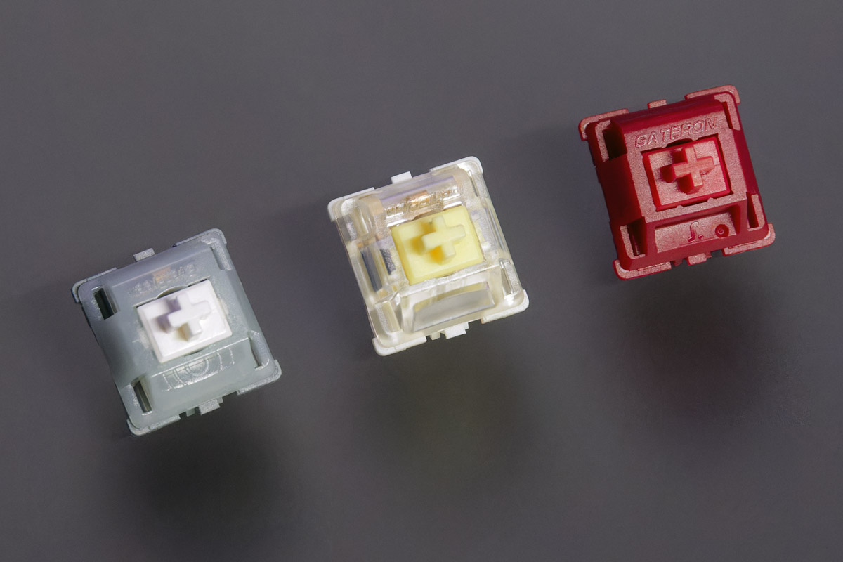

Gateron Jupiter Banana, Siliworks Type R, and Gateron/Everfree Grayish formed the heart of my final shortlist.
They're similar in many ways (strong early bumps) but distinct enough to feel different.
316594-10
The Gateron Jupiter Banana has a strong, satisfying bump that hits early and feels snappy.
Smooth, yet bold. Sound tends to be clacky but not overly loud. Great switch!
The Siliworks Type R has a bump that hits almost immediately and dominates the downstroke.
Bold, aggressive, short travel. Kinda like a maximized version of the Jupiter Banana.
Sound was brighter and clackier. It trades a bit perceived smoothness for raw intensity.
Great on suspended/springy mounts where the "snap" is amplified. It has a high fun factor!
The Grayish were the most balanced. Less aggressive and a touch more post-bump linear feel.
Sound leans nicely thocky. Stock performance is impressive for the price.
Near premium feel without the premium cost. I recommend!
Early-bump comparison, Grayfish -vs- TypeR

The fact that you liked the BOX Brown showed that you were on track. They are crisp, and they are sharp. I have some criticisms about the housing collisions, or bottom-out, but they are fun to type on. I have some on a test board, just for fun.
[They are great for typing, and probably ok for gaming. But I think that the 'pseudo-steps' involved in the switch's operation make them less than ideal for gaming.]

You might want to try Gateron Lanes, if you haven't already.
Haven't tried them. Just did a quick search...
"They use a internal leaf-spring mechanism inspired by vintage Alps SKCM Orange" Sound's very interesting >.>
Even tho medium-heavy would be preferred over medium-light, I will check them. Thanks for pointing these out!
