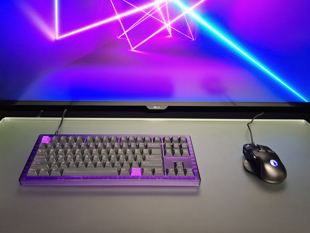

First I did a pre-selection via switch-testers.
Then I tested the most promising ones in actual keyboards (7 builds in total were used).

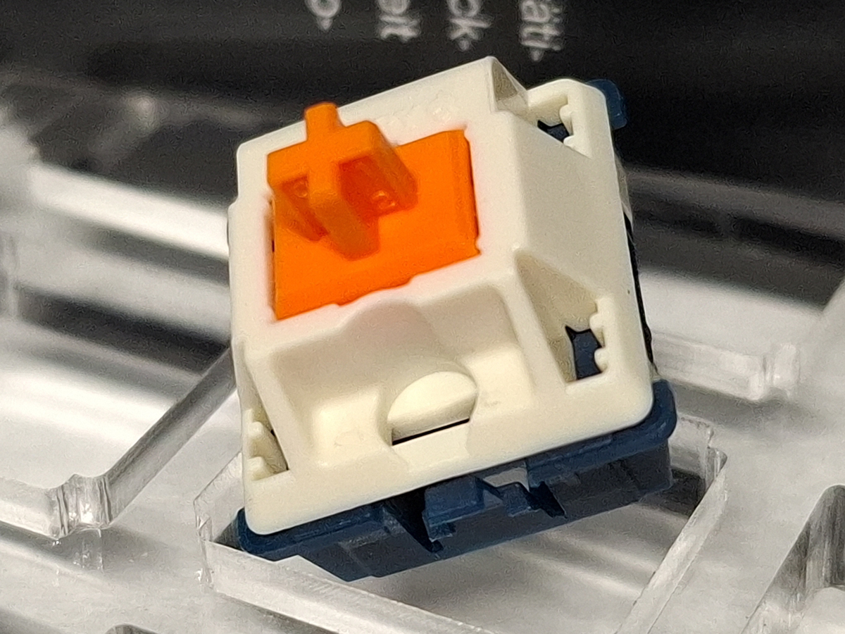

1. Early Excitement – Boxes of Kailh Box Switches
The hunt launched with multiple Kailh Box switches that immediately demonstrated how much things changed over the past 10+ years.
The Box stem design greatly reduced wobble, and also reduces the chance of dirt getting into the switch.
The "switch inside a switch" design (as the switching mechanism is in a box in the bottom of the switch housing...) adds further protection.
From a engerneering standpoint, a clear improvement.
Okay... but do they feel good?
Well... they feel different, and they don't feel bad.
Two out of the dozen I tried ended up in my final testing.
The Kailh Box Royal delivered a nice, strong tactile bump.
They also had a slight pseudo-click character that could resonate depending on the board and keycaps.
Good in focused typing sessions, but not that great for gaming sessions. Nice, but not like my Zealios V2.

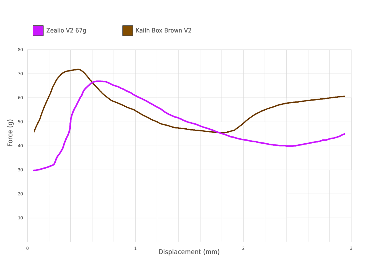

The Kailh Box Brown V2 had a much sharper bump than the Royals.
Even crispier than my beloved Zealios V2. Along with the reduced wobble and improved switch design, a possible alternative.
They felt nicely balanced for both typing and gaming (less exhausting than the Royal). They ultimately ended up in my favorites-list.
Force-Plot showing the sharp bump of the Box Brown V2:
316596-6

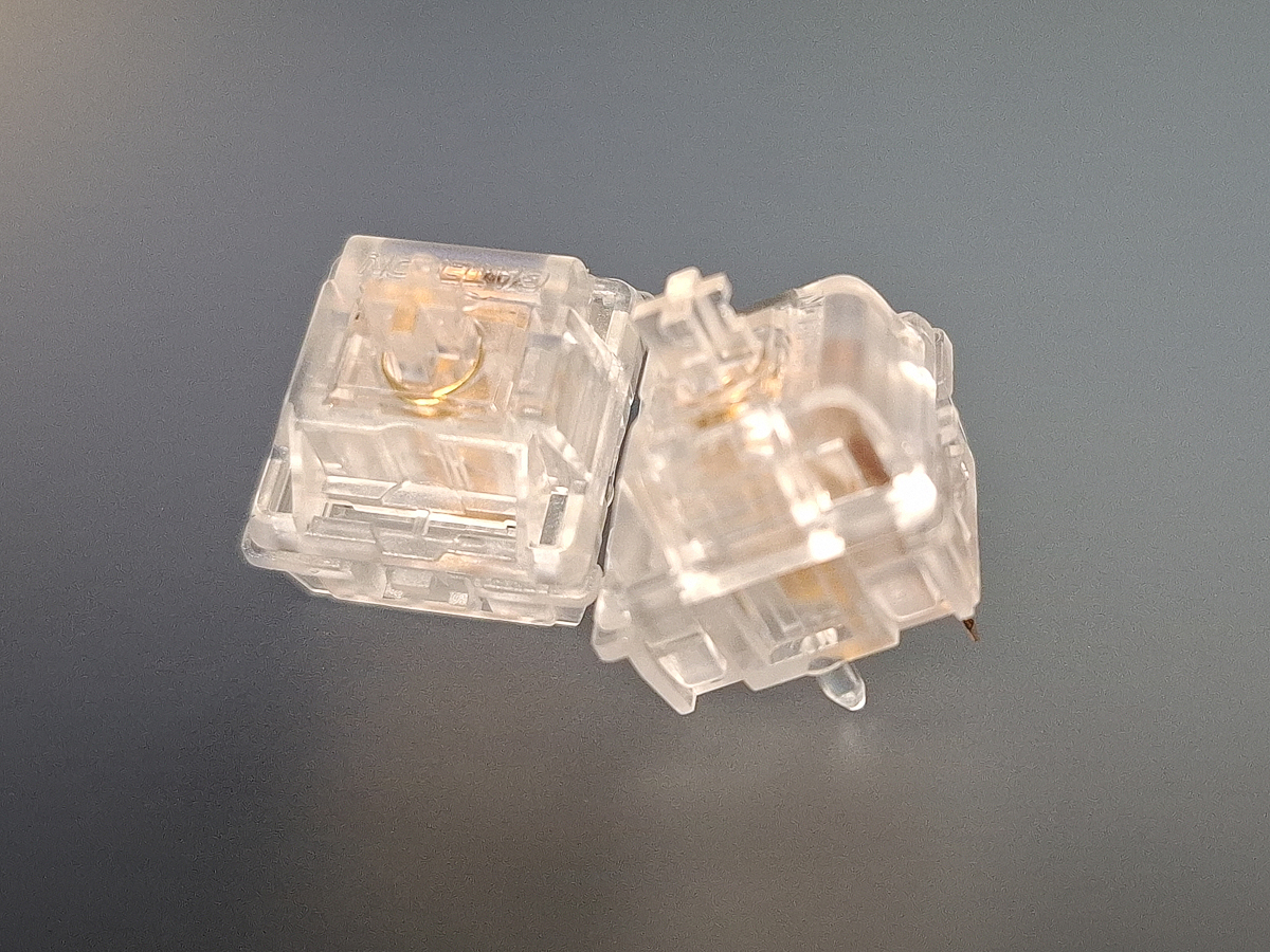

The Zeal Crystal (which I mentioned before), which were marketed as V2 with more pronounced bump, seemed nice on paper.
In practice, they felt too sticky in stock config. Spring adjustments helped. But they never elevated above the regular Zealios V2.

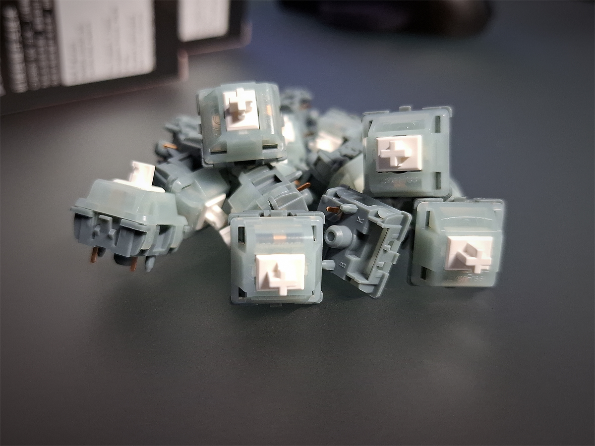

The Gateron Grayish were an immediate standout.
It features a medium-heavy tactility with a wide bump that starts early and builds smoothly.
Overall they felt balanced, not overly stiff or sticky. Also, they were cheap compared to many other "top tier" switches.
316598-9

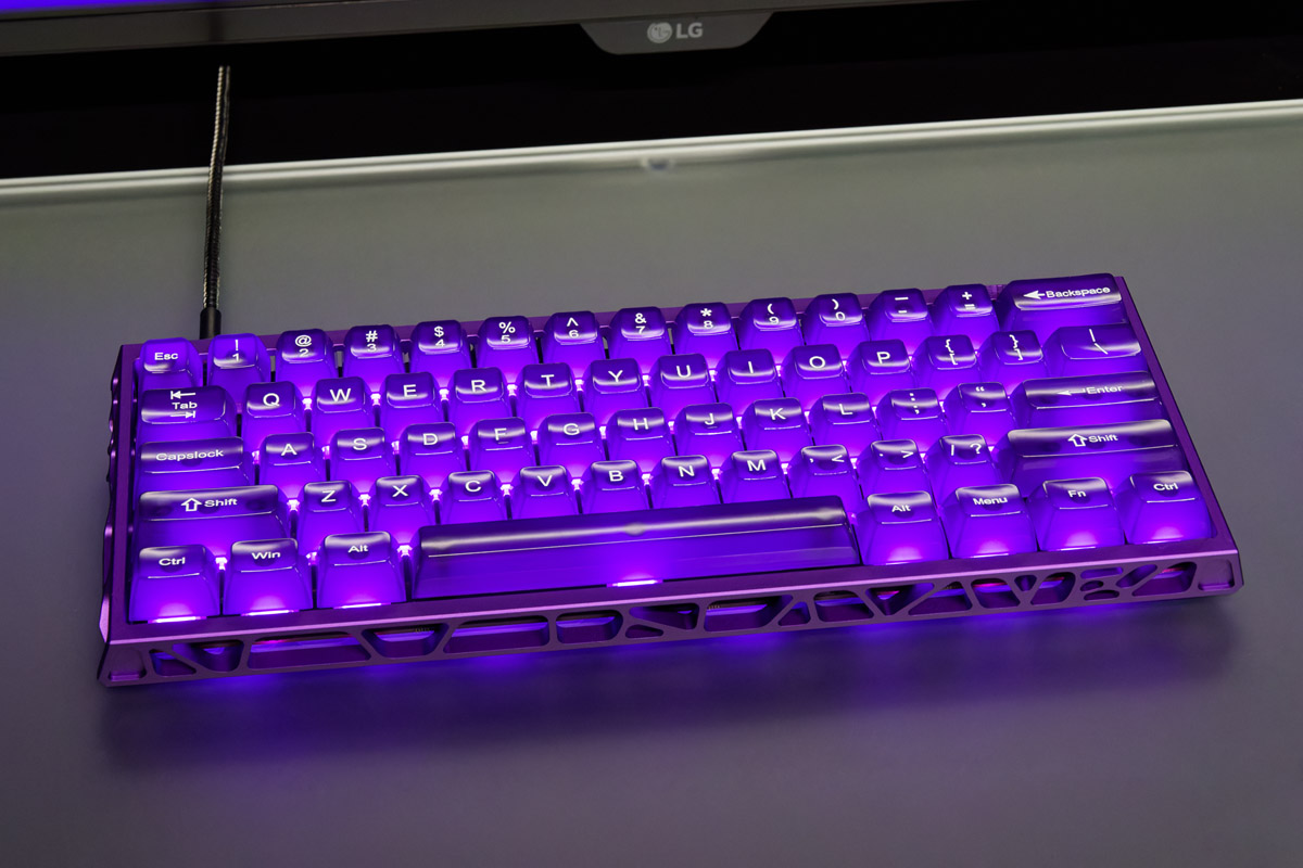

Different board mountings made a surprisingly big impact.
The rubber suspension on the Agar consistently made tactility feel more alive and forgiving across most switches.
Back in the day, all MX-boards were hard/direct mount, no suspension, much more resonance and harder impact.

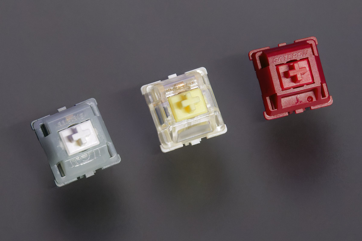

As months passed, I tested more and more switches, and zeroed in on a handfull of finalists.
Modern Gateron-family tactiles in particular stood out...
Gateron Jupiter Banana, Siliworks Type R, and Gateron/Everfree Grayish formed the heart of my final shortlist.
They're similar in many ways (strong early bumps) but distinct enough to feel different.
316594-10
The Gateron Jupiter Banana has a strong, satisfying bump that hits early and feels snappy.
Smooth, yet bold. Sound tends to be clacky but not overly loud. Great switch!
The Siliworks Type R has a bump that hits almost immediately and dominates the downstroke.
Bold, aggressive, short travel. Kinda like a maximized version of the Jupiter Banana.
Sound was brighter and clackier. It trades a bit perceived smoothness for raw intensity.
Great on suspended/springy mounts where the "snap" is amplified. It has a high fun factor!
The Grayish were the most balanced. Less aggressive and a touch more post-bump linear feel.
Sound leans nicely thocky. Stock performance is impressive for the price.
Near premium feel without the premium cost. I recommend!

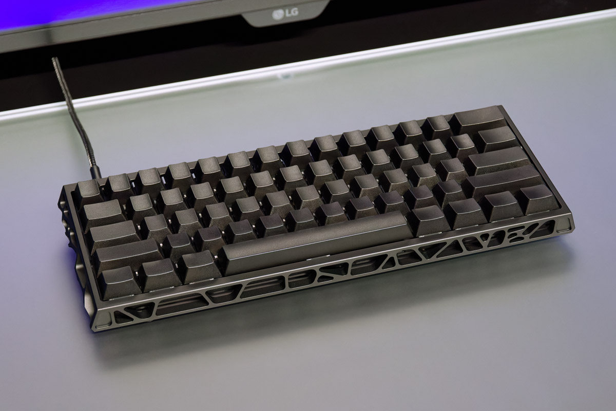

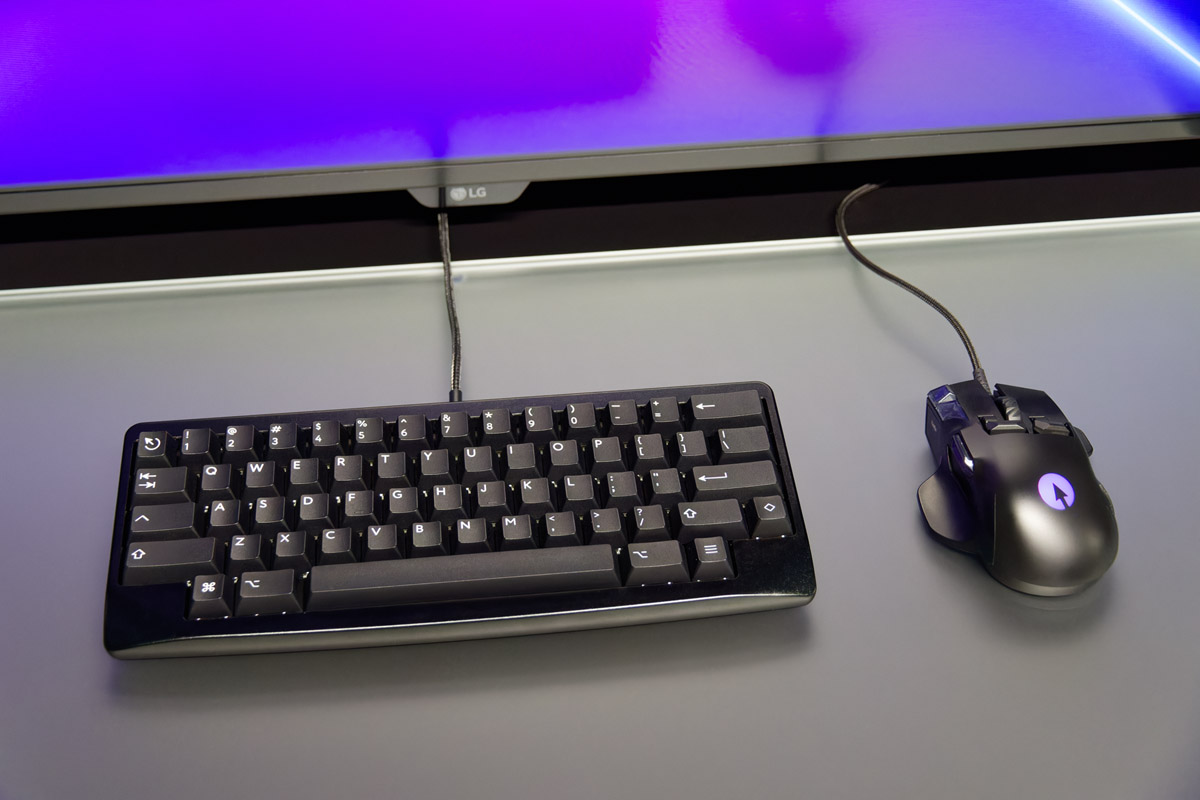

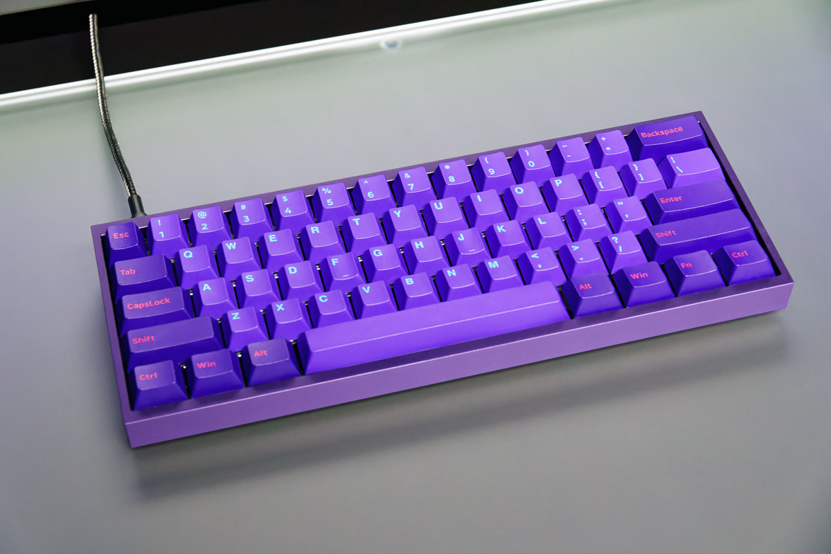

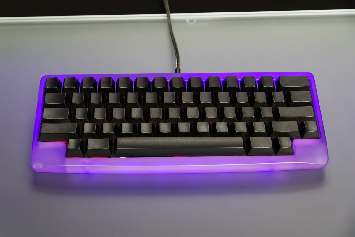

Some of the boards used:

I've seen the exact same behavior in some modern switches. The Zeal Crystal was one of the first examples I tested.
The enlarged bump felt good going down (even more presence than my beloved V2), but the rebound often felt weak and sticky.
A spring swap to something 5g heavier improved the situation. You'll notice this to varying degrees on most aggressive tactiles.
