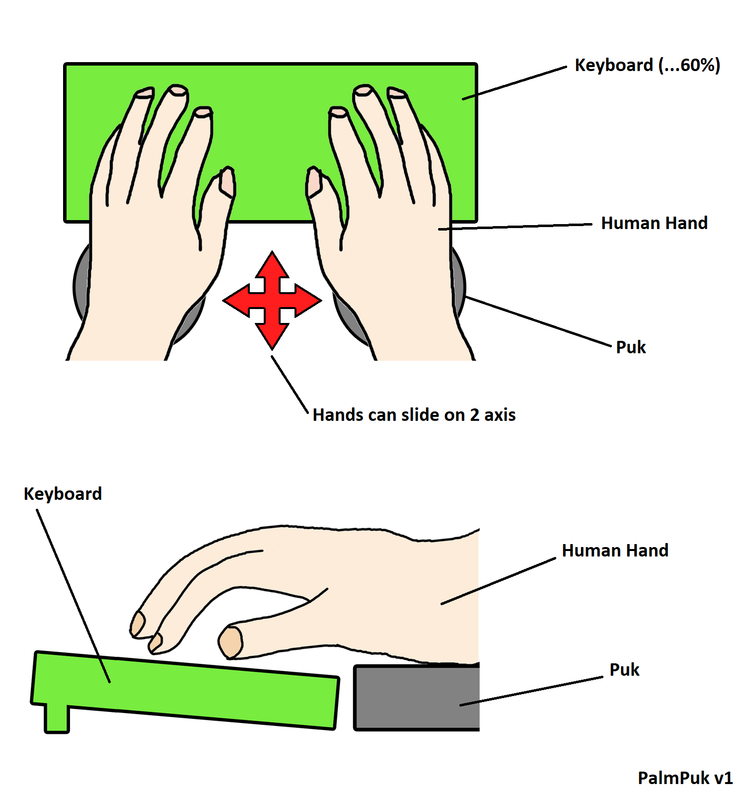

So, I got an idea I want to share with you...
The PalmPuk
A sliding palm rest that lets you move your hands without lifting them.
It is basically a combination of resting and hovering...
The device consists of two main parts:

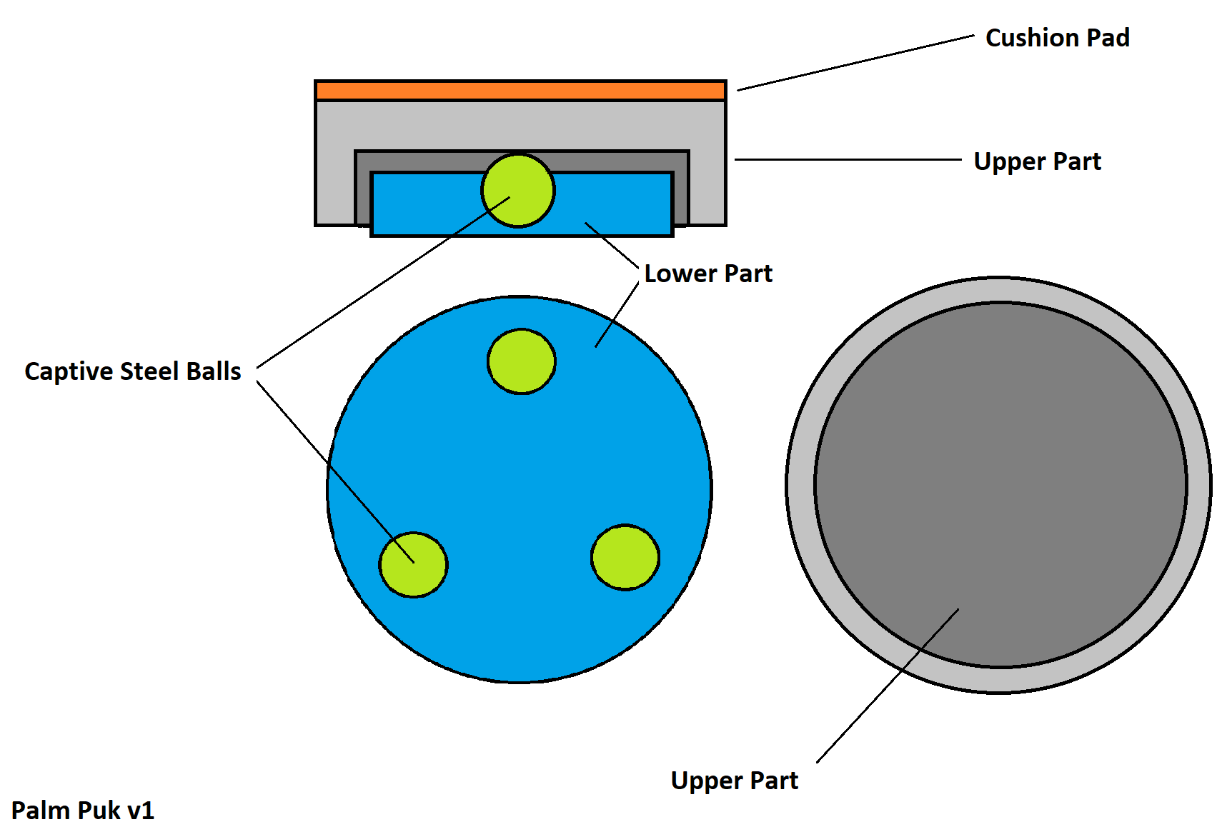

Upper Part (with cushion pad) -> Where your palms or the base of your hands rest.
Lower Part -> Contains three captive steel balls arranged in a triangle.
The upper part glides smoothly on these balls in two axes...
317202-1
This should create a low-friction "hover" effect...
Your hands stay supported, while the whole assembly slides with your natural hand movements.
It should feel like your hands are floating...
Combining the benefits of a palm-rest with the freedom of hovering.

What do you think? Input? Criticism? Suggestions?

Offline vvp
  • Posts: 903
Re: The PalmPuk (with MS Paint graphics)
« Reply #3 on: Sat, 30 May 2026, 09:36:05 »
The bearing ball must be touching directly the table (or some big pad (cushion) put on the table) to provide easy movement. Your design provides easy movement only withing the cushion area which is drawn about the same size as the whole device for one hand. Also the balls must be able to move around in the device if you want to use only rolling friction. Your proposal does not handle this at all.
You can provide easy "friction less" movement with magnets (magnetic levitation), air cushion (you need air pump somewhere), ultrasound levitation or some omnidirectional wheels touching directly to the table.
But if you are lazy to move your hands around then you can also get a keyboard which does not require any palm movement while typing, like e.g. K80CS: https://deskthority.net/viewtopic.php?p=250605#p250605

Offline vvp
  • Posts: 903
« Reply #6 on: Mon, 01 June 2026, 02:19:56 »
The goal is to be able to slide your palm about 1 Inch in all directions...
If that is the goal then the lower part must be bigger by 1 inch in all directions compared to the upper part. The pictures do not indicate that at all.
Also the picture indicates that the ball sits in the upper bearing depression:
1) if the depression is simple spherical cutout then you will get sliding friction there and it is likely to be too much for smooth motion (even if it is made from a low friction material like e.g. teflon)
2) if the depression is a groove (shown from the direction of the groove ... therefore seen on the picture as a simple spherical cutout) then it will allow easy movement only in one direction (the direction of the groove)
If you want to have a friction less feeling with balls then the balls must be able to move as well. E.g. to move the pad to the right by one inch the ball must be able to move to the right by half an inch! This is true for any direction.
You do not have any indication in your pictures that you allow for this.
Look .e.g. at this exploded view of a linear bearing:
Notice that the bearing balls are there in "squished" loops. The balls mus be in loops since one side of the loop provides the return path for the moving balls. The other side of the loop actually is the working area. This is the area where balls provide friction less movement between the carriage a the rail. They provide the friction less movement by rolling between the rail and the carriage surface. But because of this rolling they are also moving along the loop. Therefore they need the return path. The balls are exiting the working area of the loop ... returning through the return path  and entering the working area on the other side.
Balls move through the working area without friction since they are rolling. This is also the area where the balls are under load (possibly high forces between carriage and rail). The balls are not moving without friction in the return path. But the friction is very low there since there is no load on the balls.
Your design does not address the moving ball problem at all. That is the reason I pointed out other options (magnetic levitation, ...).
