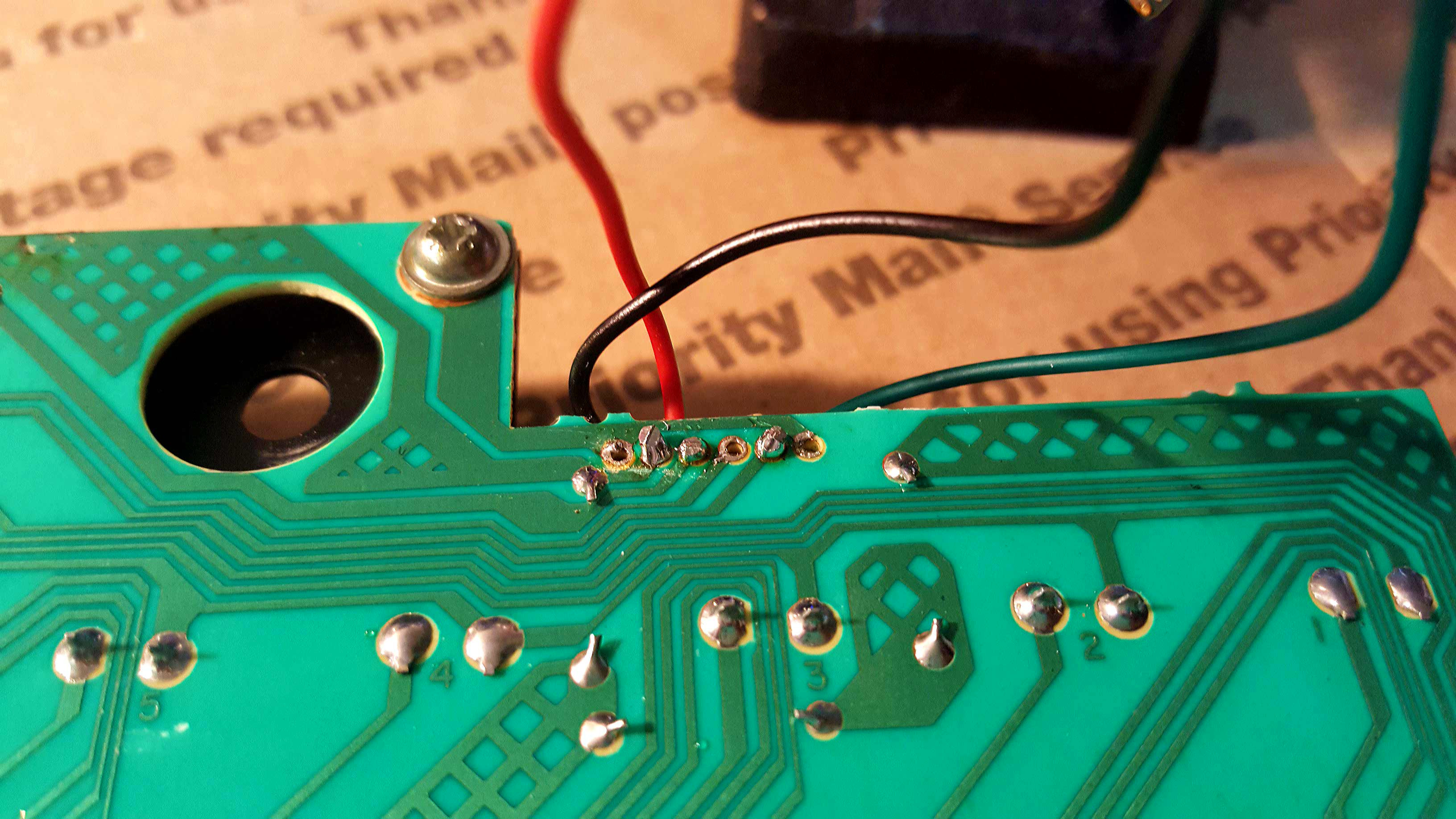

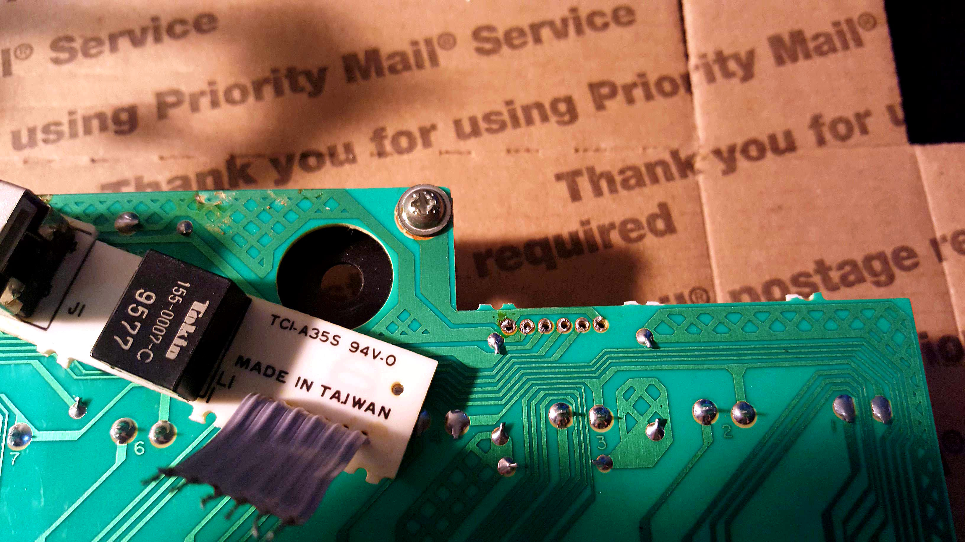

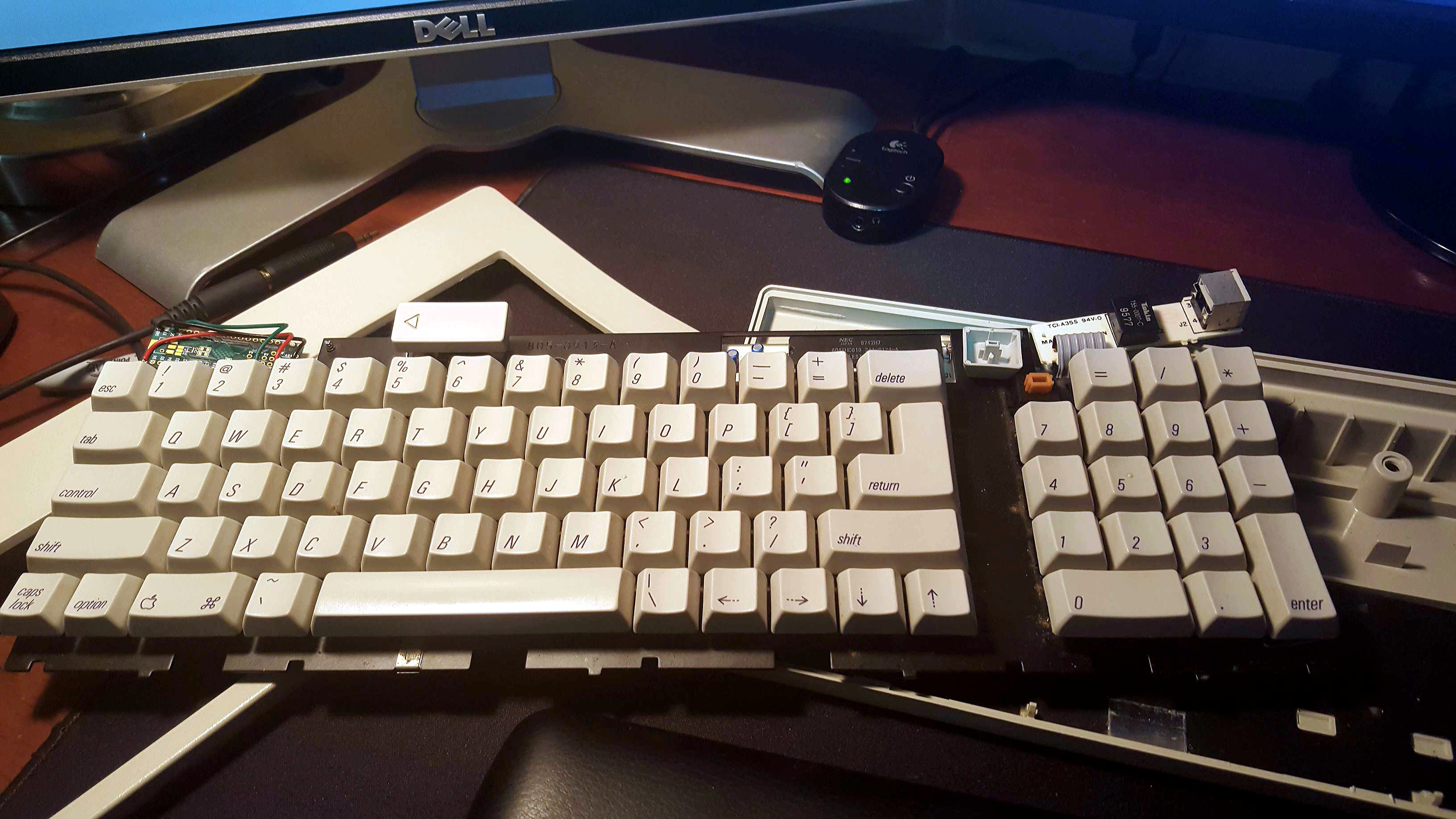

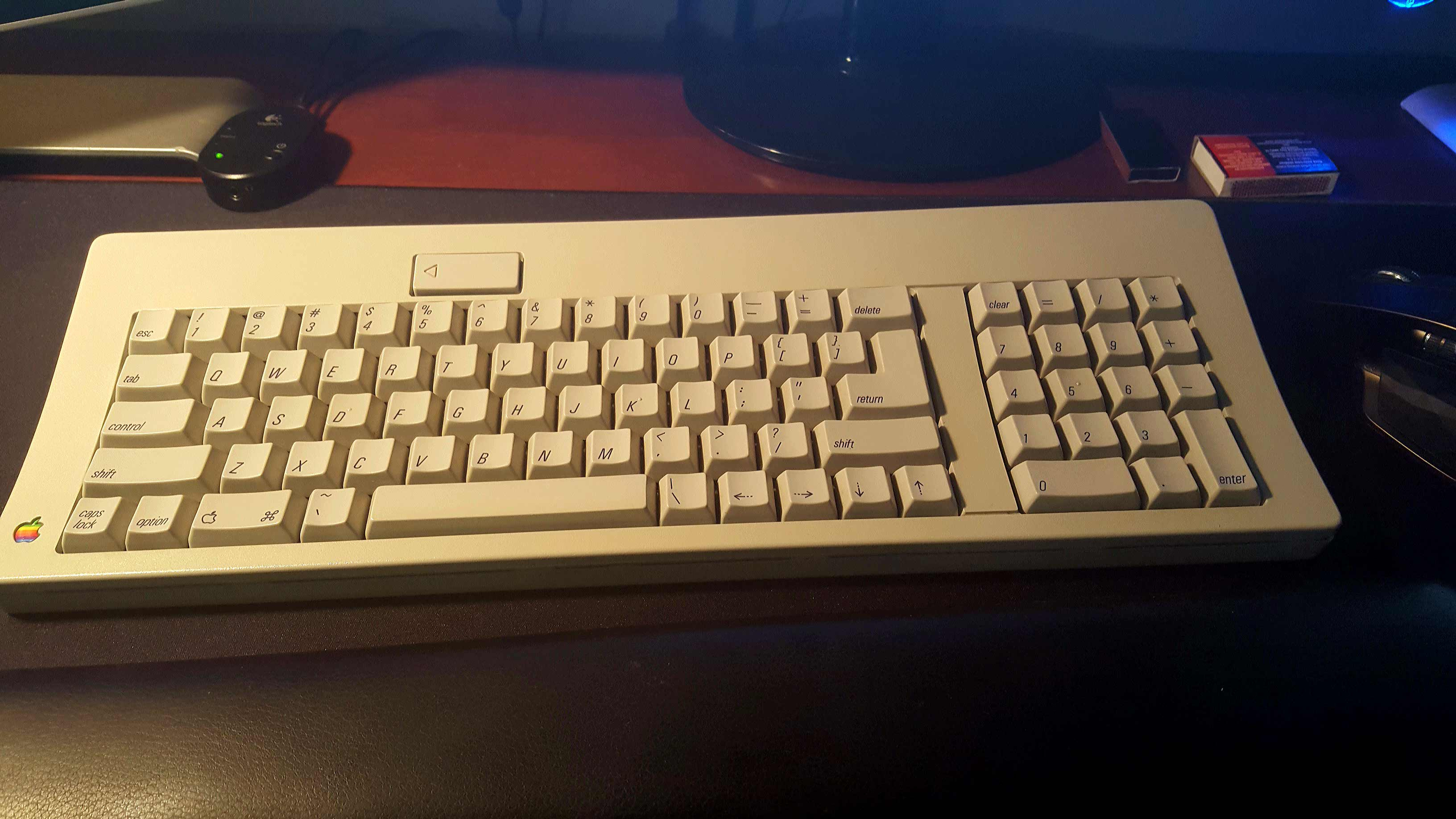

Here is my work so far, everything worked great. The soldering job is not that good mostly because I've soldered a couple of times before. You can also see that I've fixed some things in place with hot glue.
I used Windows + Cygwin for the generation of the Hex file.
Tested the keys (because I was unsure) with EK' switch hitter and it's working great.
The only this remaining is to clean the keycaps.
I'll post more pics when I'm done.

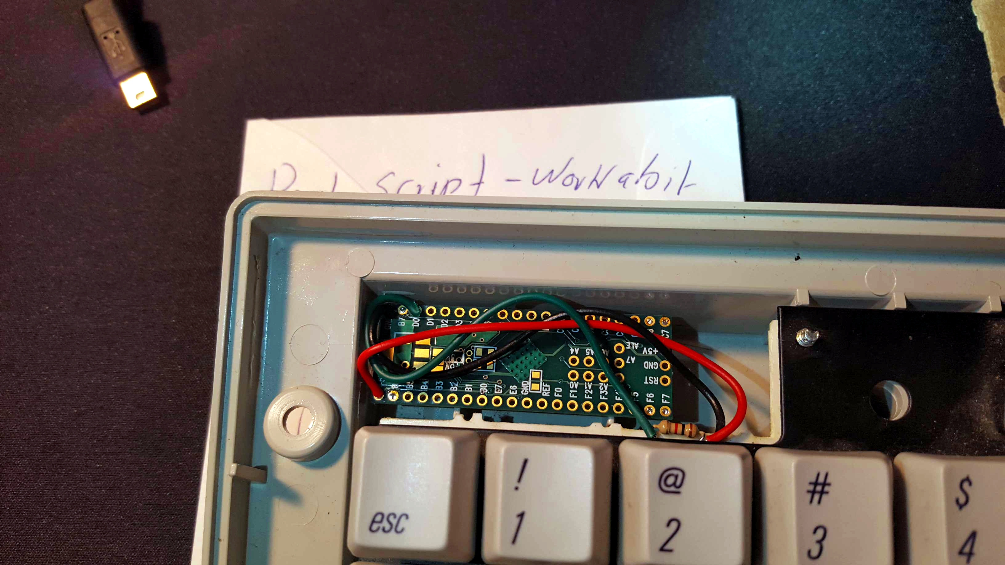

can anyone help me out?

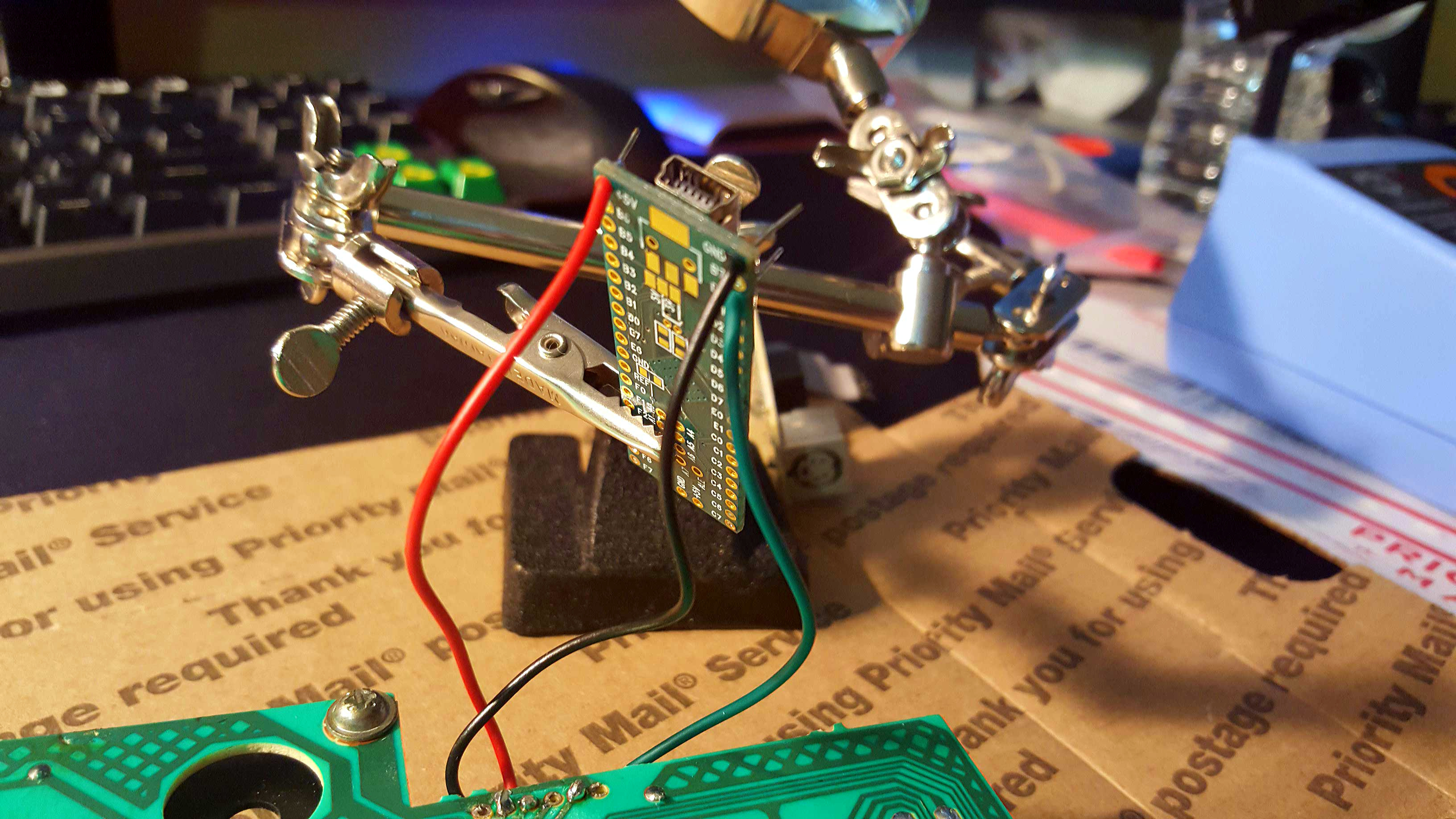

I have a teensy 2.0 wired to the board on an apple A9M 0330 keyboard
I know the teensy works (I can send the flashing light program and it works) but I get zero output when flashing the adb hex program.
do the pin numbers on the keyboard circuit correspond to the pin numbers assigned here to the ADB connection?
see photos
« Last Edit: Sat, 05 December 2015, 13:35:20 by asaturn »

so I don't know what I did wrong, but I deleted, resync'd, recompiled, and now it works! I do get the mouse going to the upper left, but that's known -- I'll throw the resistor on there.
THANKS!

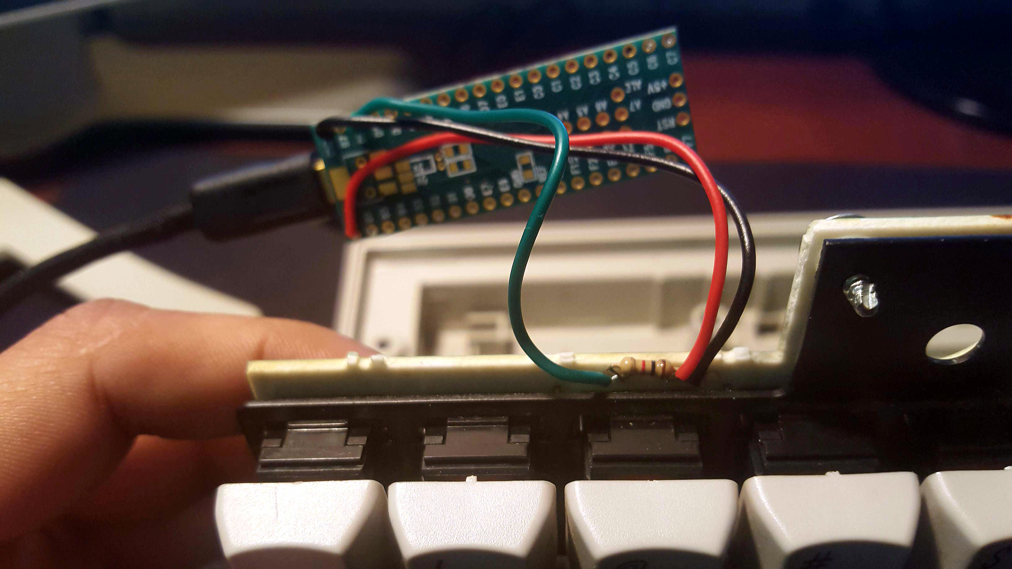

Anyway here's a picture of my soldering job, I originally connected the Power SW line to PD1 because I wasn't thinking, but I don't think should effect the functionality right?
The resistor is 1.16K and I am using a short 4 pole s-video cable.

Yes, it is recognized as keyboard once firmware runs on controller.
Right, Power switch line won't affect unless the wiring is mess.

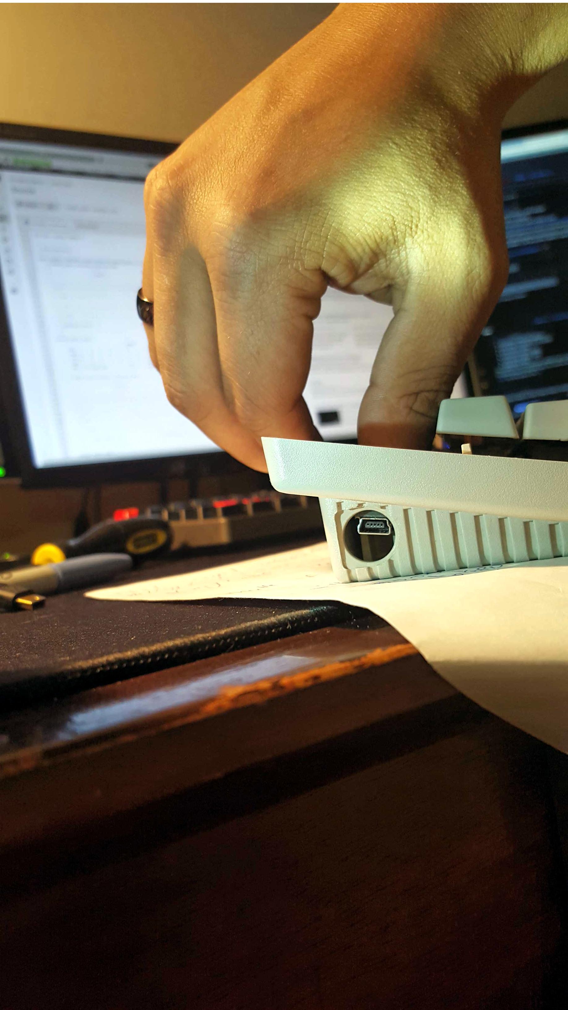

I made USB controller for Apple desktop bus keyboard(IIgs) with Teensy++2.0 and this multiple key stroke problem exists also. I tried in many ways but I couldn't find what is wrong but I could expect there is some timing issue between USB host and firmware. As a work around, by setting this controller as low speed device this problem has gone.
Here is my work picture
Anyone know where Jeffrey got that mini usb connector? Been looking for one like it, but haven't been successful.

Looking for something like this?
http://www.ebay.com/itm/10pcs-Mini-USB-Female-5Pin-180-Socket-Connector-vertical-Legs-HW-MU-5F-23-/170961675619?hash=item27ce1c2563:g:jhEAAMXQMmJRNBRi
Because it looks like Jeffrey used one, and then just hot glued it into the ADB port housing

I wish he was still active on the forum, It almost looks like he just soldered his teensy 2.0++ to some pins shared by the original microcontroller.
